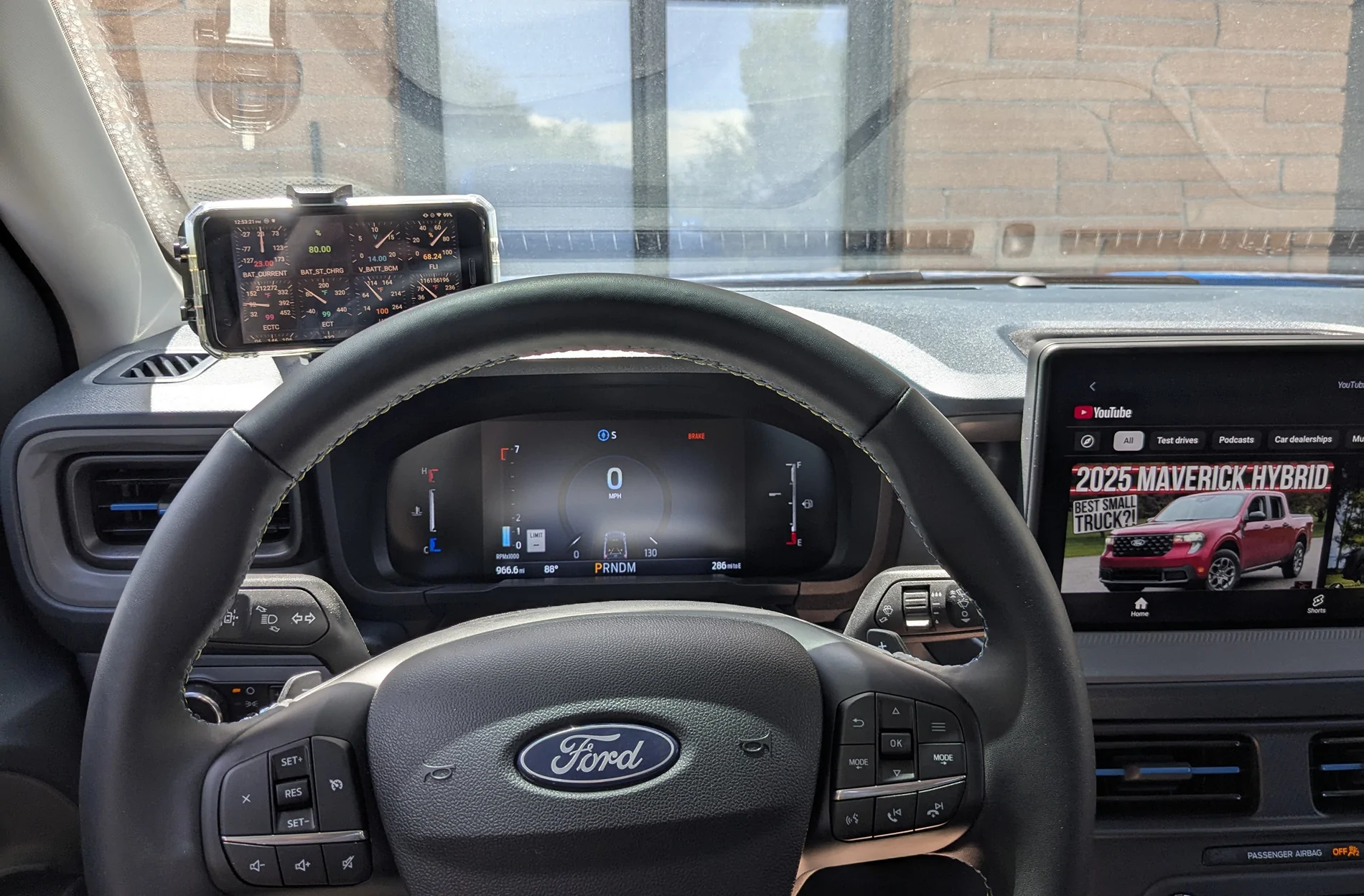

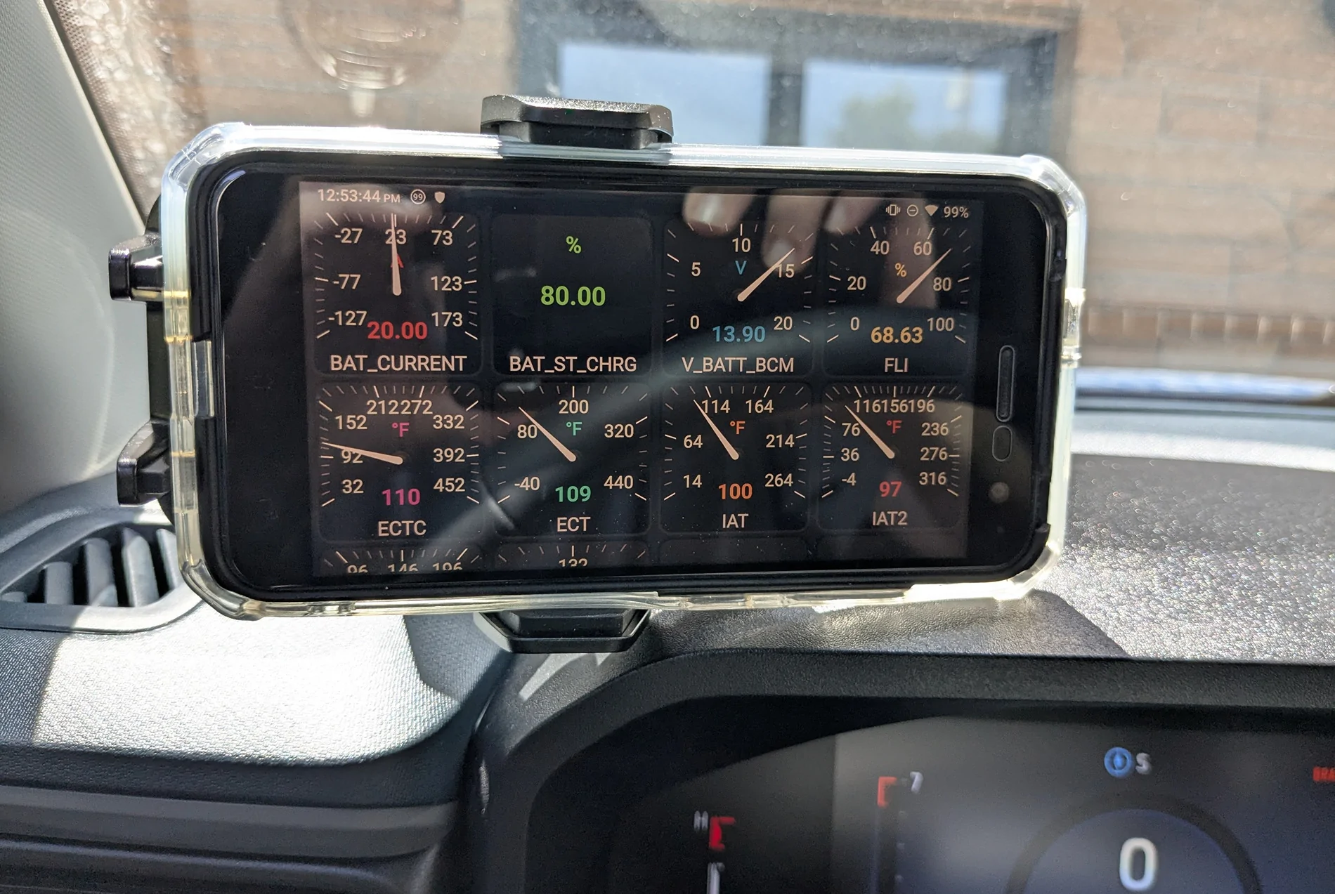

Initial setup for Forscan Lite, i am still working on what to display, and finding the best layout.
I'm not super happy with the dash mount/location. And still have concerns about a suction mount on this dash over time. I think I want it in the A-pillar (like my previous Cobb AP).
Ford Maverick Forscan Lite gauges to display? PXL_20250802_185324515
Battery Current > Bat State of Charge > Bat Voltage > Fuel Level
Engine Coolant Temp (Corrected) > Engine Coolant Temp > Intake Air Temp > Intake Air Temp 2
Ford Maverick Forscan Lite gauges to display? PXL_20250802_185347752
Some other gauges I'm using:
Transfer Case Fluid Temp > Transmission Fluid Temp > Transmission Gear Requested > [Transmission] Gear
Transmission Gear Engaged > Load [%] Absolute > Load [%] > RPM
MAP High Resolution > Throttle Position > Throttle Position Relative > Barometer Corrected
Barometer > Vehicle Speed High Resolution > Brake On Off 1
I question whether either of the Barometer gauges are actually working, both read 12.5, which seems to be a 'default', as it reads that when its Off as well.
Going through all that, I realized I don't have Manifold Gauge Pressure (MGP) [aka boost], I'll have to look for that again. I found the MAP instead, and thought that was it.
I need to cull some of the duplicates, and maybe remove some outright, but want to figure out which are most relevant/accurate with some further testing and monitoring.

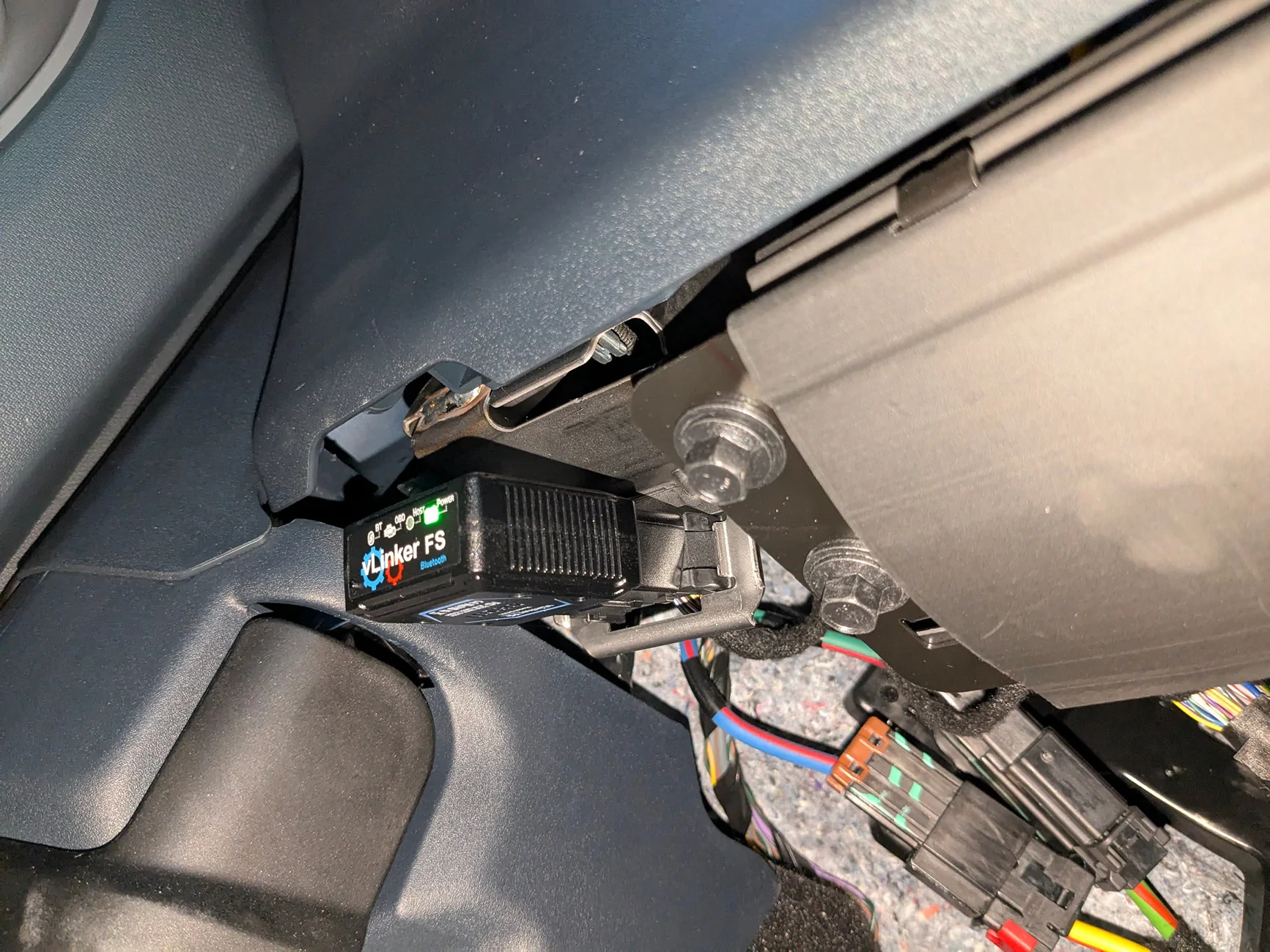

Oh and I'm using a Vgate vLinker FS (Bluetooth) adapter, and its great. After the initial connection setup, it connects to Forscan quickly.
Its fast (throughput speed) and low latency (minimal delay between vehicle > module > interface > wireless connection > to the viewers display). It auto switches MS to HS depending on the module.
LED indication of Power (does the adapter have power from the vehicle through the OBDII port), a Connection/Link light (to indicate if a bluetooth connection is established), and then 2 activity indicators in the center.
A fun tool, to make interfacing with the vehicle much more pleasant and accessible. Easier to carry and have access to a phone and make a connection to check a few things if/when needed.
I also have a laptop that will make Forscan operations/changes easier and quicker without wires and attaching said cables, and no need to flip the MS/HS switch every time you connect to certain modules.

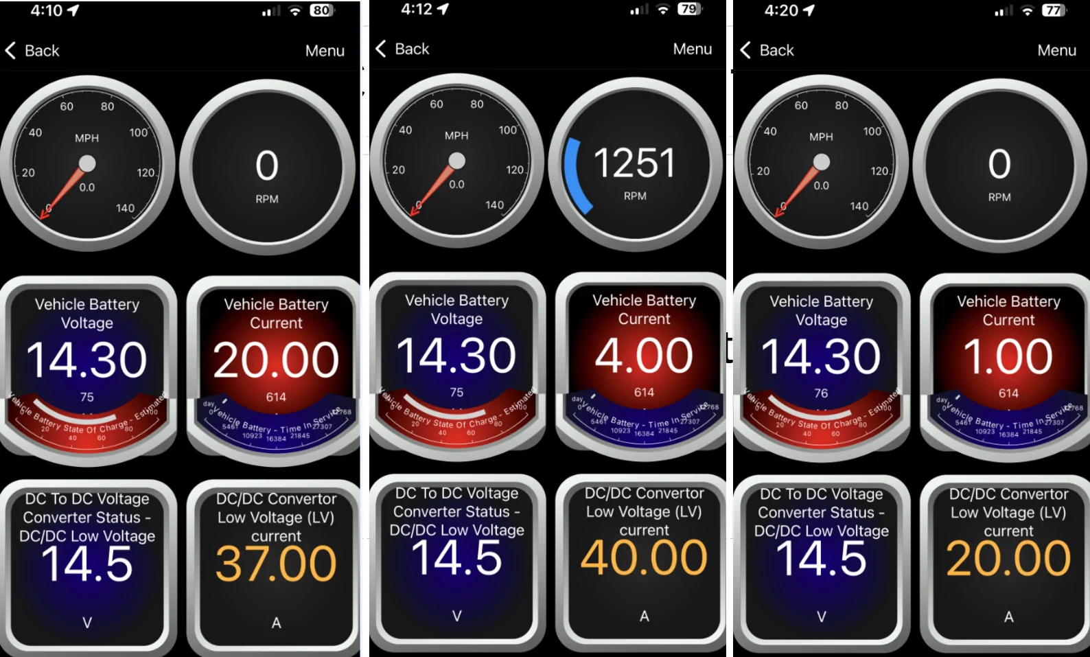

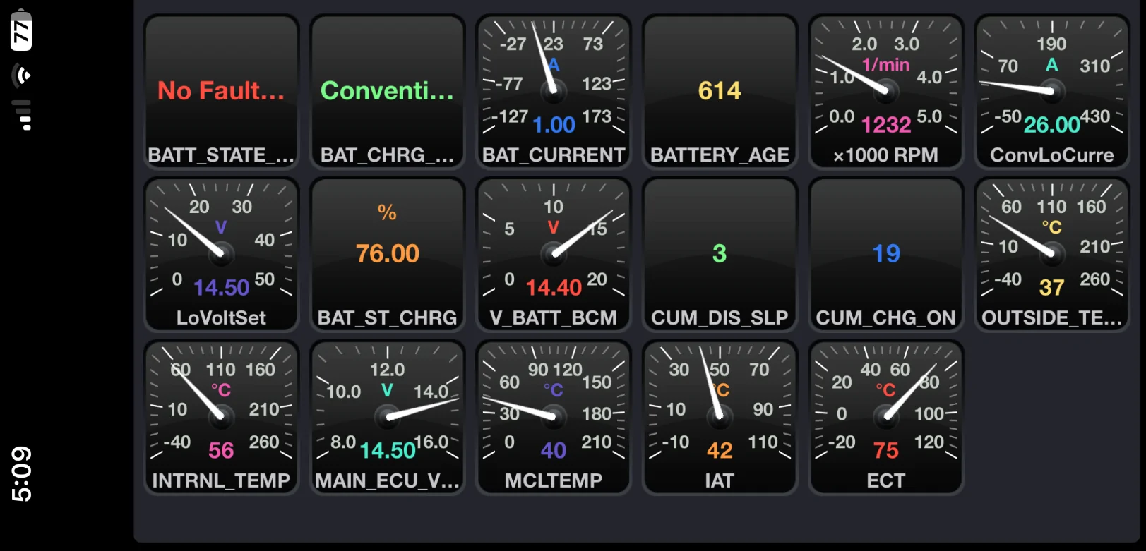

I just usually use Forscan Lite and bluetooth OBDLink MX+ for looking at the 12V battery on my hybrid.
Recently installed the OBDLink App for my OBDLink MX+ that I've had for several years to see what it looked like.
Forscan Lite:
Ford Maverick Forscan Lite gauges to display? 1754173897701-9y
OBDLink App watching my battery amps at Run:
Ford Maverick Forscan Lite gauges to display? 1754173979069-kd

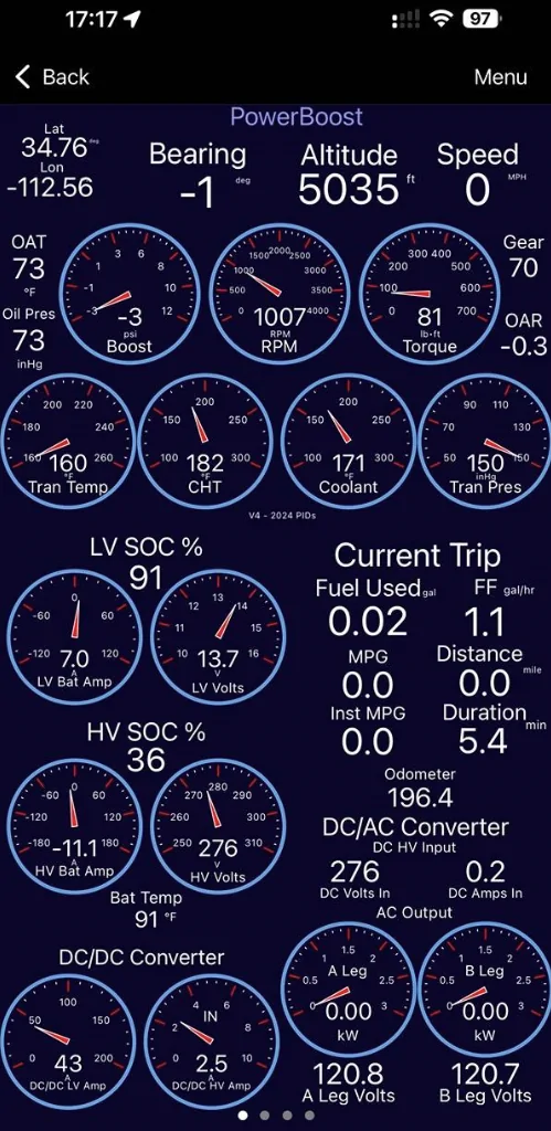

If I had the patience I'd try to see how many PIDs I could fit in an OBDlink screen, like on a PowerBoost by turbopilot:

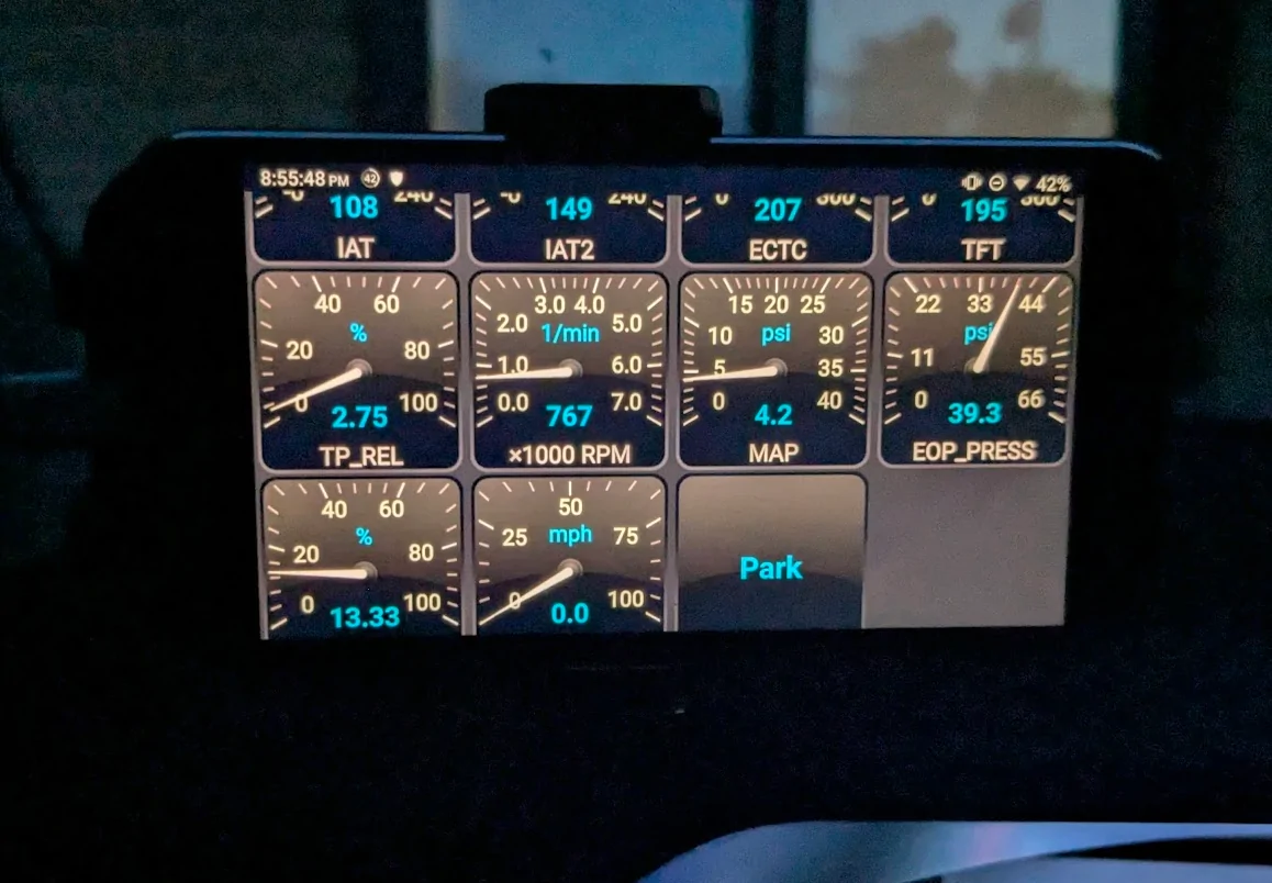

I can't find a clear "turbo Boost pressure" reading, and I think the closest I'll get is MAP (Manifold Absolute Pressure) reading.
Below, is the gauge layout I ended up with after some testing tonight.
Most the important temps are in view at the very top as number only. I still question what Intake Air Temp is showing me, and why they are so high. ambient air temp 81*F.
Intake Air Temp *F > Intake Air Temp 2 > Engine Coolant Temp, Corrected > Transmission Fluid Temp
Throttle Position, Relative % > RPM 0 to 7,000 > Manifold Absolute Pressure psi > Engine Oil Pressure psi
Load, Absolute % > Vehicle Speed mph > Gear
Ford Maverick Forscan Lite gauges to display? 1754192249113-bz
Observations: Load % is a funny one, it goes greater than 100% under heavy loading, so I'm not exactly sure how to interpret that.
Gear indicator: So this is also a bit odd [specific to Lobo 7spd], the Gear reading shows 1 for (first) gear, that matches up fine. An up shift to "2nd" shows as 3 (third) gear on Forscan. So Forscan will show +1 for each gear beyond 1st. "3rd" = 4, "4th" = 5, etc. "7th" = 8.
I'd like to find Engine Oil Temp reading, but haven't found one yet.
Any other Forscan users know of another parameter to look into for Turbo boost?
Or can you explain MAP? Is it Barometric pressure + forced induction = ## psi?
