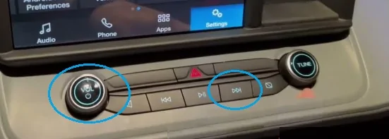

Heading to work and.... hmmm. The infotainment system froze like it does with the camera, but while the camera was not in use.

Well documented issue, just reboot it

Rebooted.... as usual. Happens every couple weeks.
I've seen lots of camera discussions, but not the system itself.

Pardon my ignorance here folks, but what is the easiest way to reboot it?
I posted this before..
Ford Maverick Camera lockup? Nah. Its the system itself. Info_system_reboot
Push these buttons for 10 seconds...

Engine on, engine off, acc on or off, in your picture you have screen on to settings?
Last time, I rebooted... Truck was running.
As far as the photo...
"Screen Shot" was taken AFTER I rebooted and checked to make sure, everything worked.

Thanks Jerry, 👍🏼
