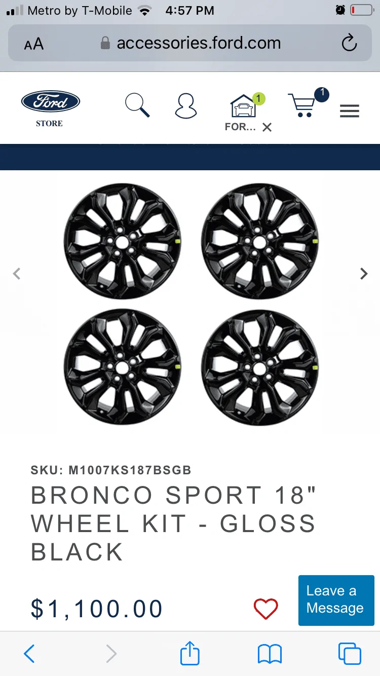

Hi everyone will this wheel fit I call ford website they don’t have that information
Ford Maverick Bronco sport wheels 18 in D9A96C05-2838-4530-AB43-69D03C214807

Go to craigslist and facebook marketplace and find some Bronco Sport (make sure sport, not regular Bronco) and get a set of wheels and sometimes tires, for $500 or less. They'll fit and be much cheaper than buying "new" (many of these will be just like new).

I was wonder if they stick out a little I just want a beefy set
These have the same specs as the 18x7, 38mm offset wheels used on Maverick. You might want to look at an 8" width. and/or less offset.

If ford is selling all 4 for 1100$ Best Buy of factory aluminums I have EVER seen.
They usually are about $1100 each ( 860 my cost) and $50 core per wheel.
But used with tires for all4 for $800-1000 is more kind to the wallet , check offer up and Craig’s list or Facebook marketplace.
