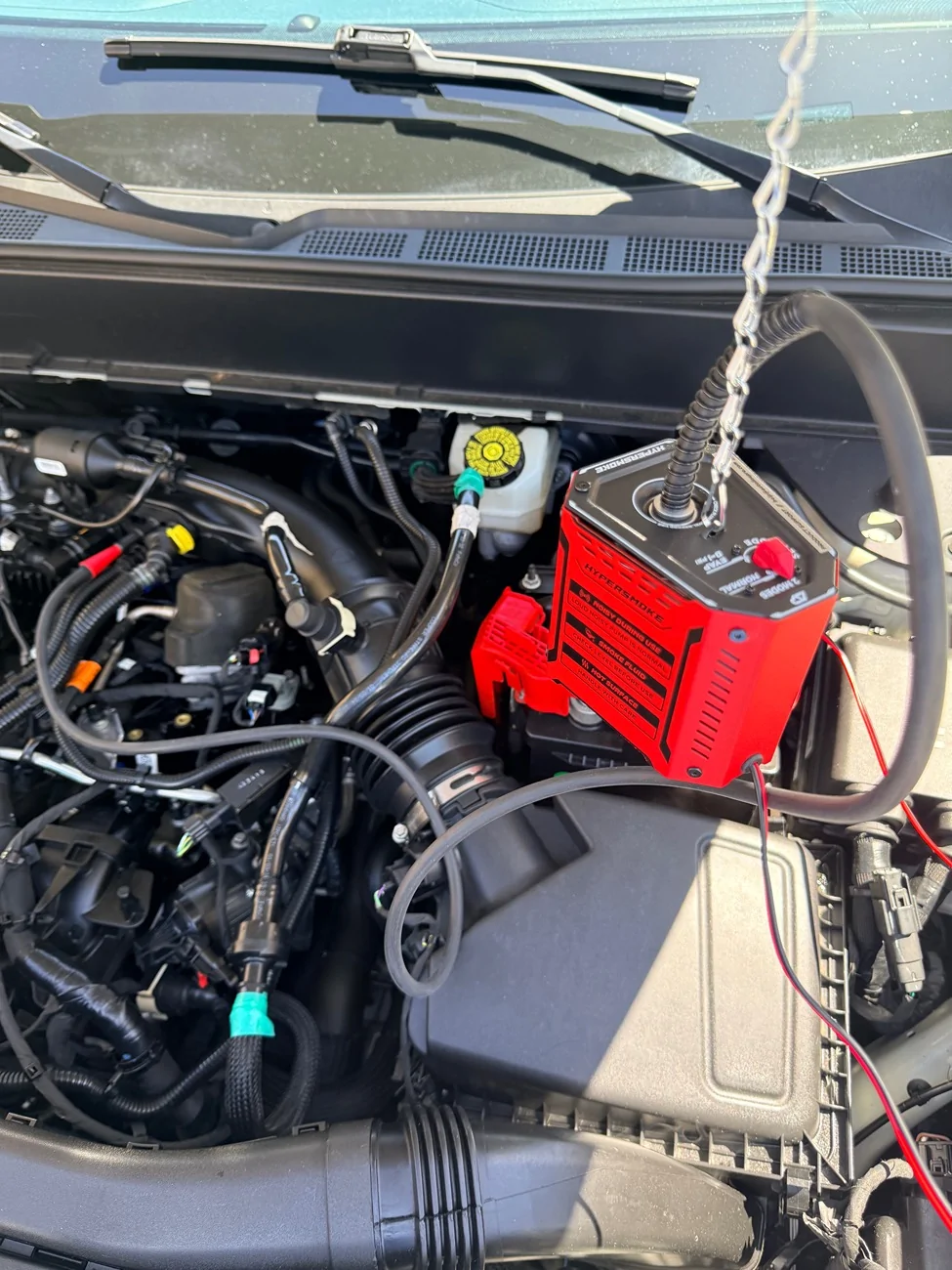

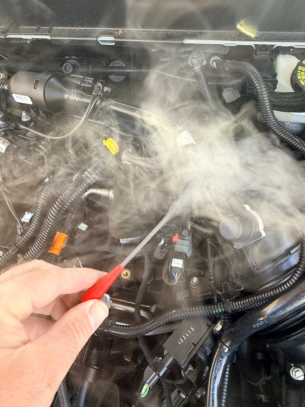

I have been hearing what I describe as an Aztec Death Whistle noise under 3/4+ throttle. I purchased a cheap smoke machine on Amazon for $65 bucks. Found the leak, at the FMIC where the charge pipe connects. Tightening clamp did not help, and upon removing the hose and blocking it off, there is a crack where the neck meets the housing.
Took it to Ford dealer, and they smoked it and cannot find the leak…. 🤣. Wanted to charge me $175 diagnostic fee and send me down the road. I went out to where my truck was parked and hooked up my machine, smoking in the same spot! Got the service manager out to verify and told him I refuse to pay the diagnostic fee. I was polite enough to him, but expressed that he should source qualified techs. Asked him how much his smoke machine cost (north of $1000). I’m way too impressed at this point. Cancelled my extended warranty as well.
I will be ordering the CVF unit today.
almost unbelievable.
https://a.co/d/083mFnNj If anyone needs one that works well. No compressor needed.
