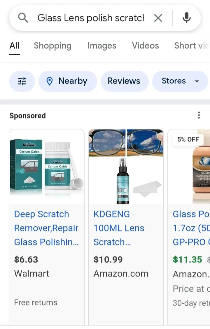

As far as something to polish the lens of the camera.
I would trust something for eyeglasses or an actual camera lens.
Glass polish will have a sharper-cutting abrasive, and I doubt the outer lens is glass if it's been scratched. I would start with something lighter as I mentioned above, moving up to sharper cutting abrasives if those don't work.

I would not use any type of headlight restorer/polishing.
If something is fine enough to work on eyeglasses. I'm sure it'll be fine for that camera lens.
Why? Plastic headlights are no harder than eyeglasses, and usually softer. Softer materials require "finer" polishes than harder ones. The picture of the search results you posted above show polishes for glass, and those certainly shouldn't be used unless you're 100% sure that outer camera lens is glass and not plastic, especially not "deep scratch remover for glass". Again, I suspect that it's plastic if it has been scratched.
