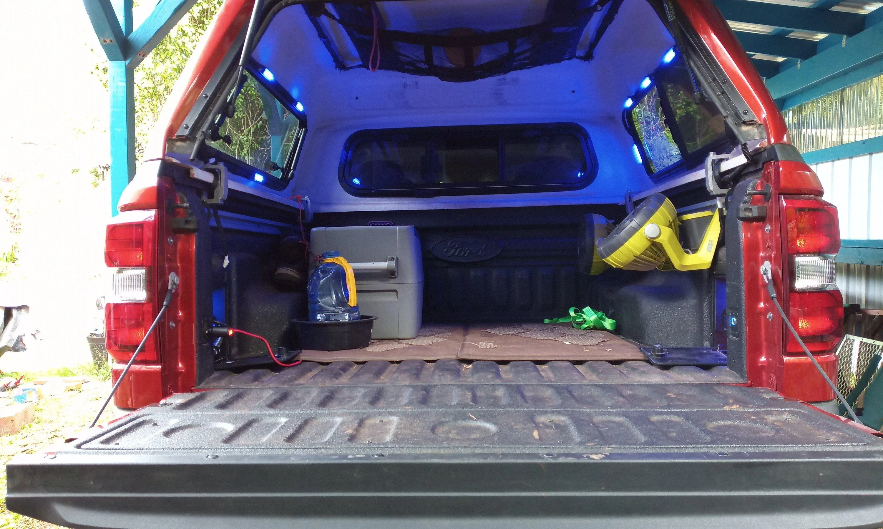

The bed is done. I added some Pyle marine Bluetooth speakers. LED strips, switches and USB ports from Amazon. The speakers run independently of the truck's sound system - so mostly for when I'm working outside or hanging out. They're waterproof and made for marine applications, and sound decent for a bluetooth speaker system. The power is switched there, the factory bed power supply runs for about an hour and a half after you shut the truck off, and the usb port has a volt meter so I can keep an eye on the battery level. These are 6" speakers, and are just a little big, necessitating cutting the switches and ports back just a bit to fit. If I could have found 4 1/2" speakers, that would have been better, and would have allowed use of a couple of cubbies
Dope install
