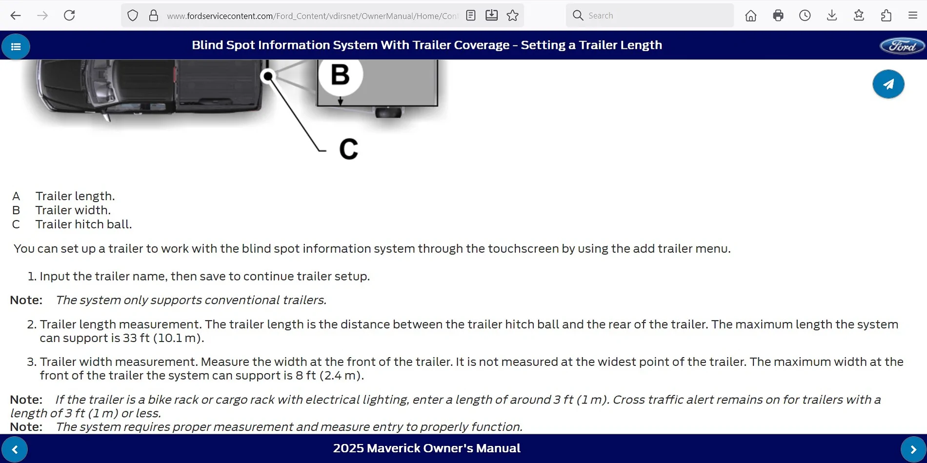

The trailer size input appears to be an addition for 2025. 2022-2024 disables BLIS when something is attached to the trailer connector as yours does because there is no way to know how much larger the blind spot is with the trailer.

Only on 2025's.

Does this mean I can use the 4 pin to power a hitch, light or LED strip with out losing BLIS FUNCTION ? What’s the shortest trailer you can input?
