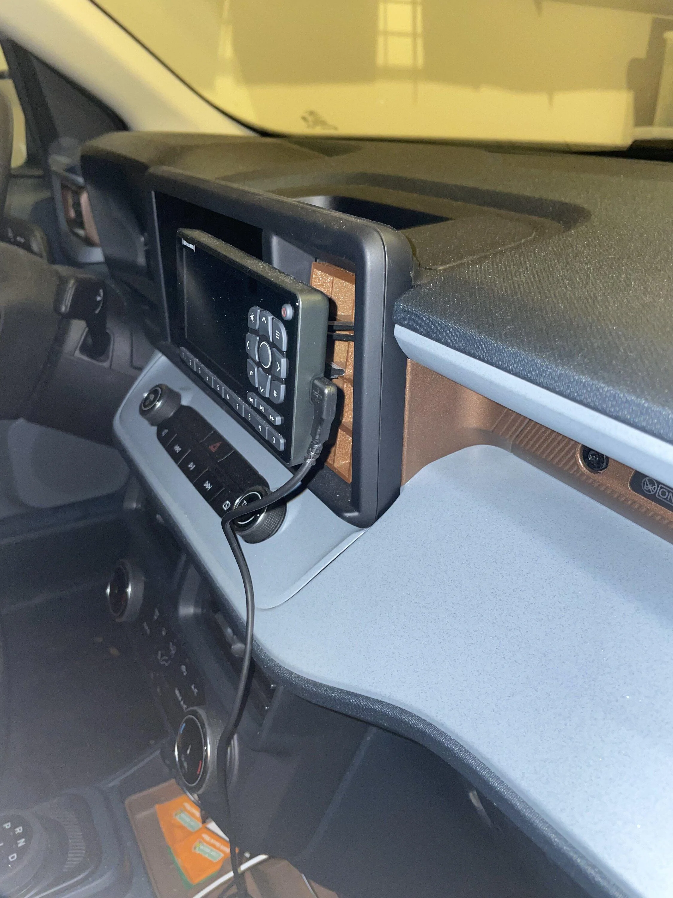

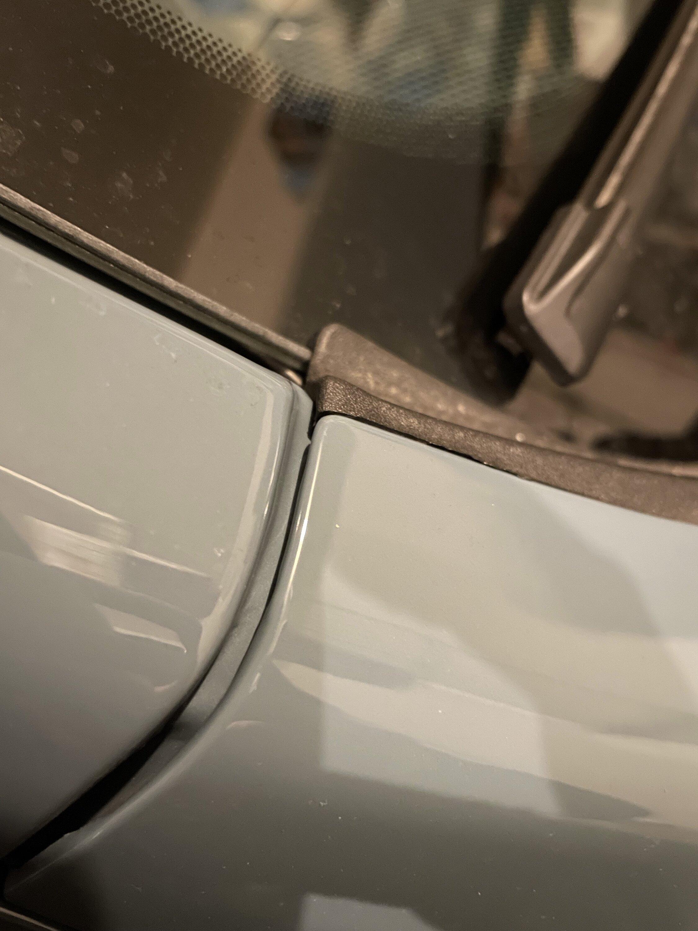

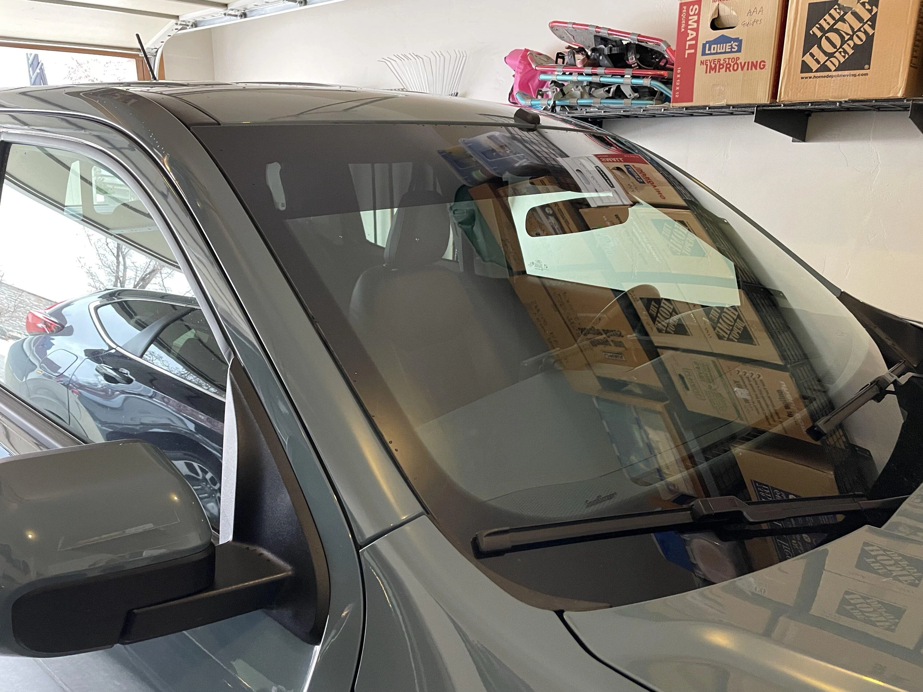

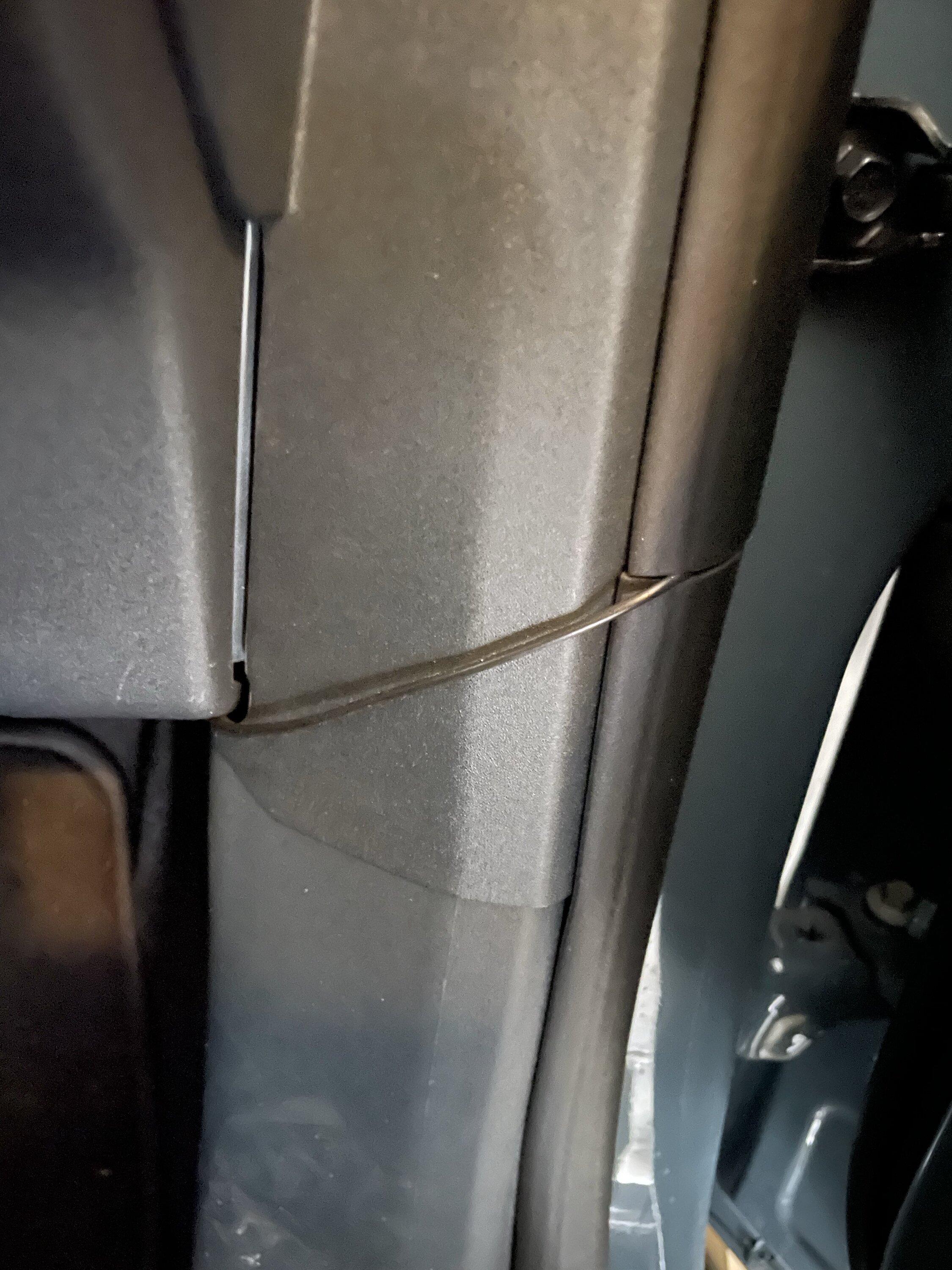

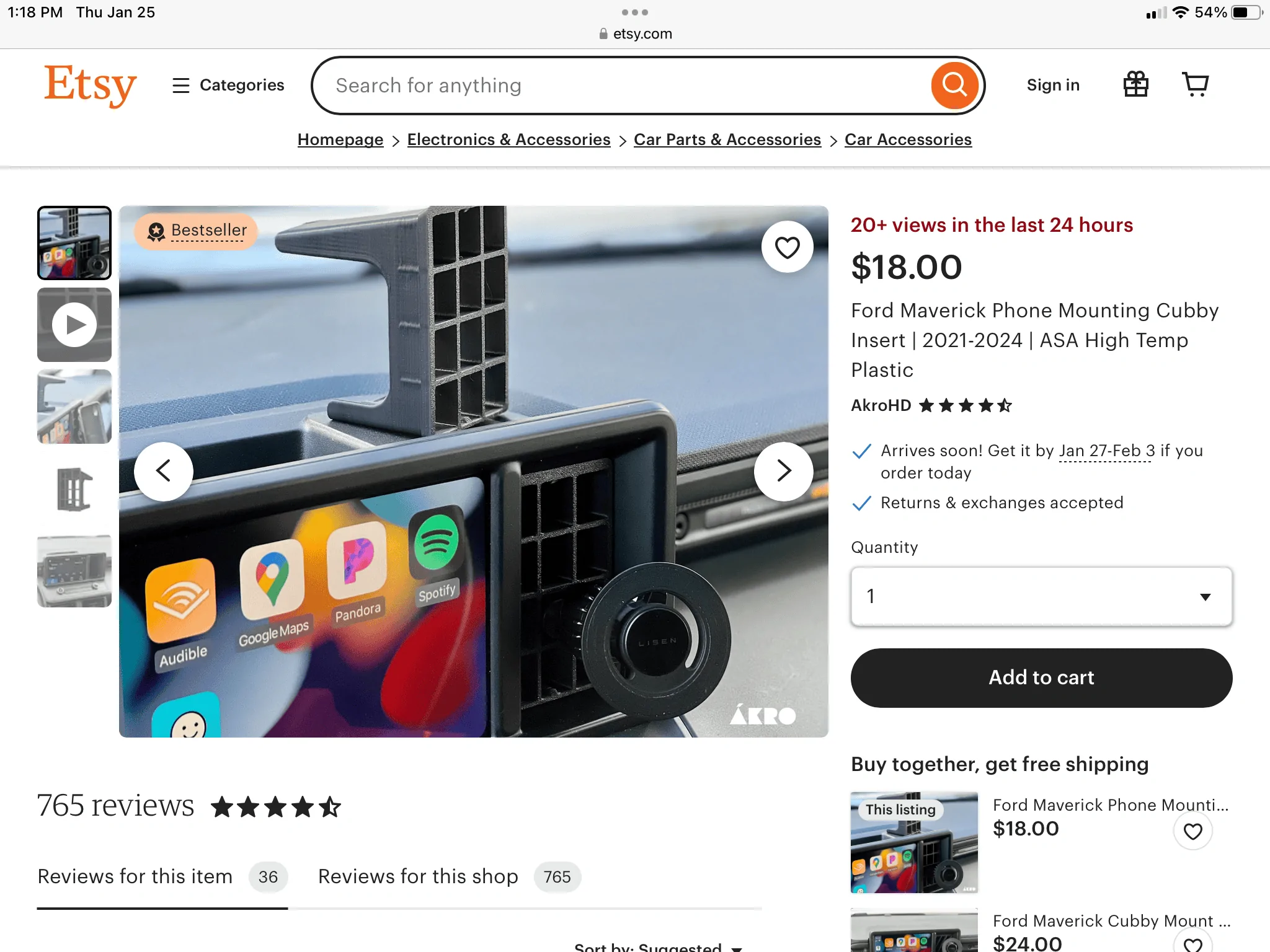

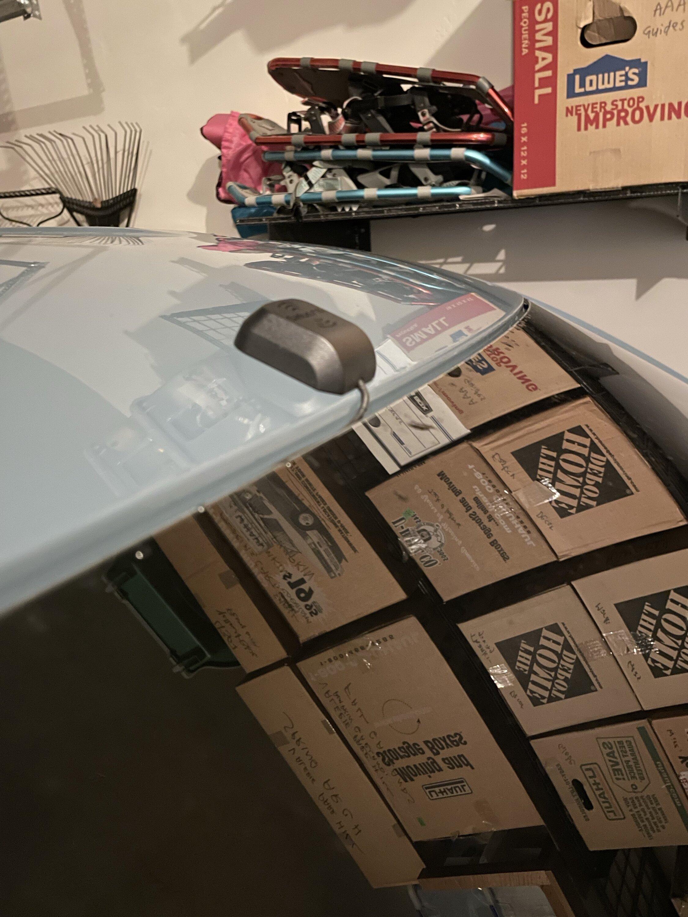

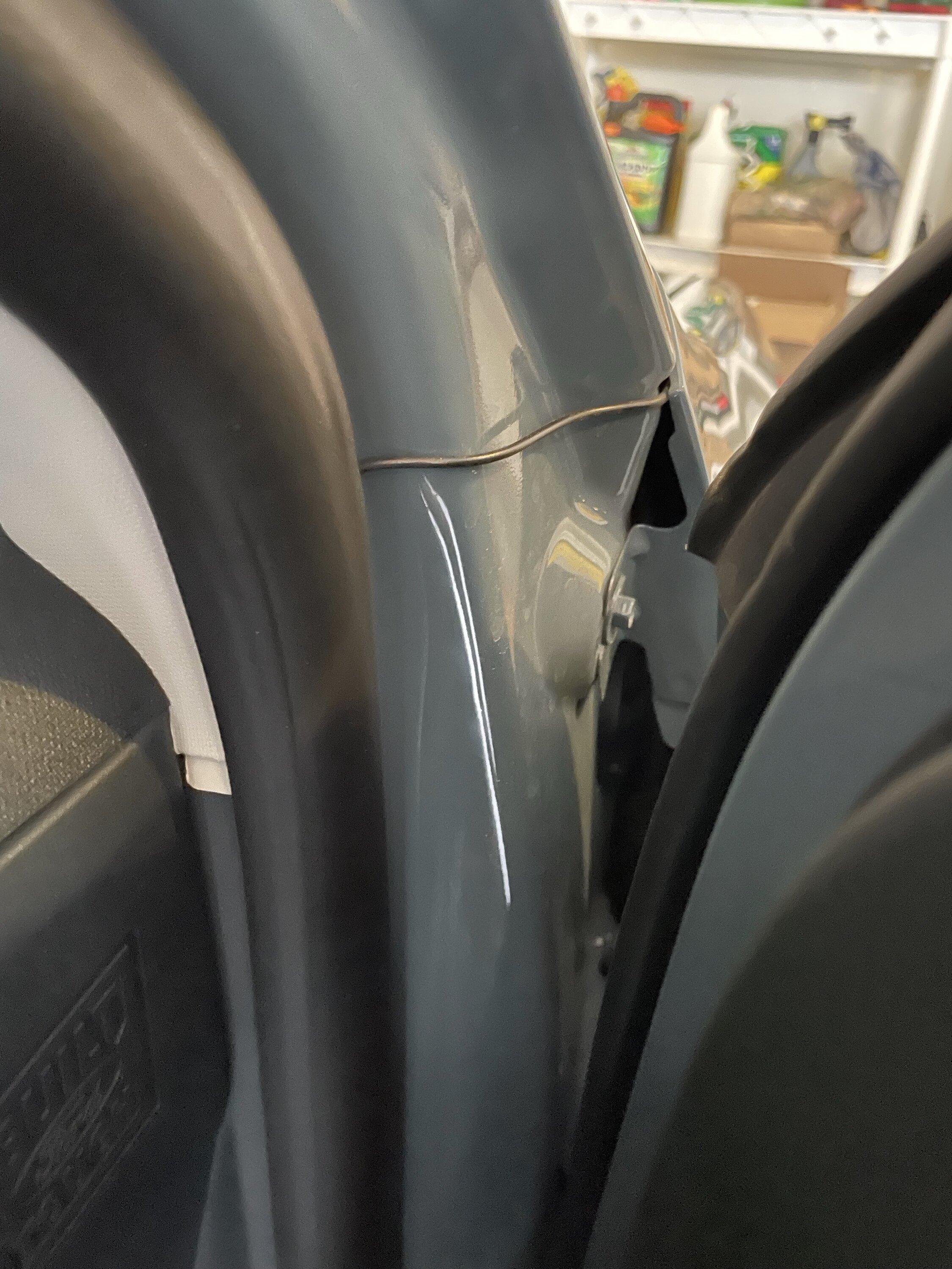

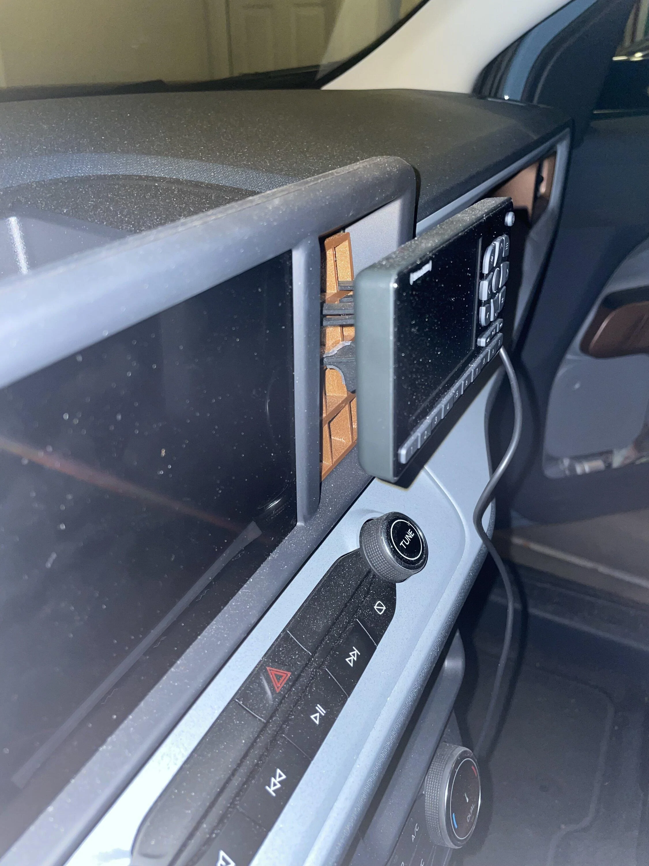

If you drive in an area with poor cell service, get a RoadyBT receiver from the XM radio site, Crutchfield, BestBuy, or elsewhere. Mount the antenna on the front roof, and route the antenna wire behind the windshield, thru the gap between A pillar and fender, behind the front door weatherstripping, then thru the gap between the two ends of the door weatherstripping. See photos of my antenna mounting, wire routing, and receiver mounting. The receiver is mounted to a cubby adopter available from Etsy. Bluetooth transmits the audio to the car radio. No tools or dis-assembly required.
