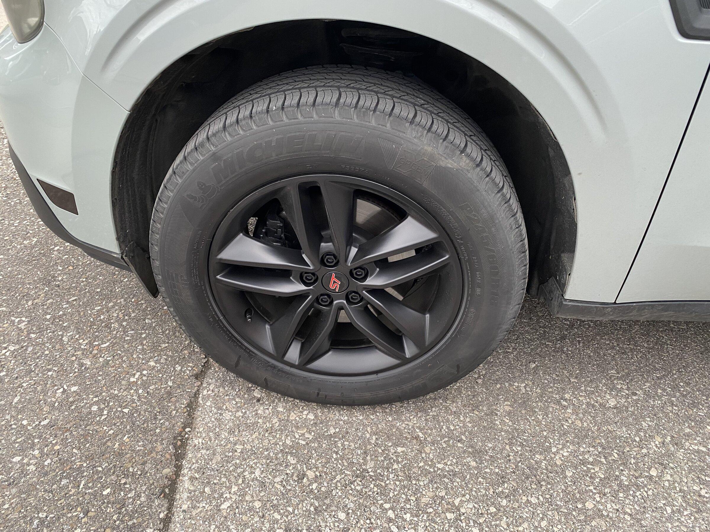

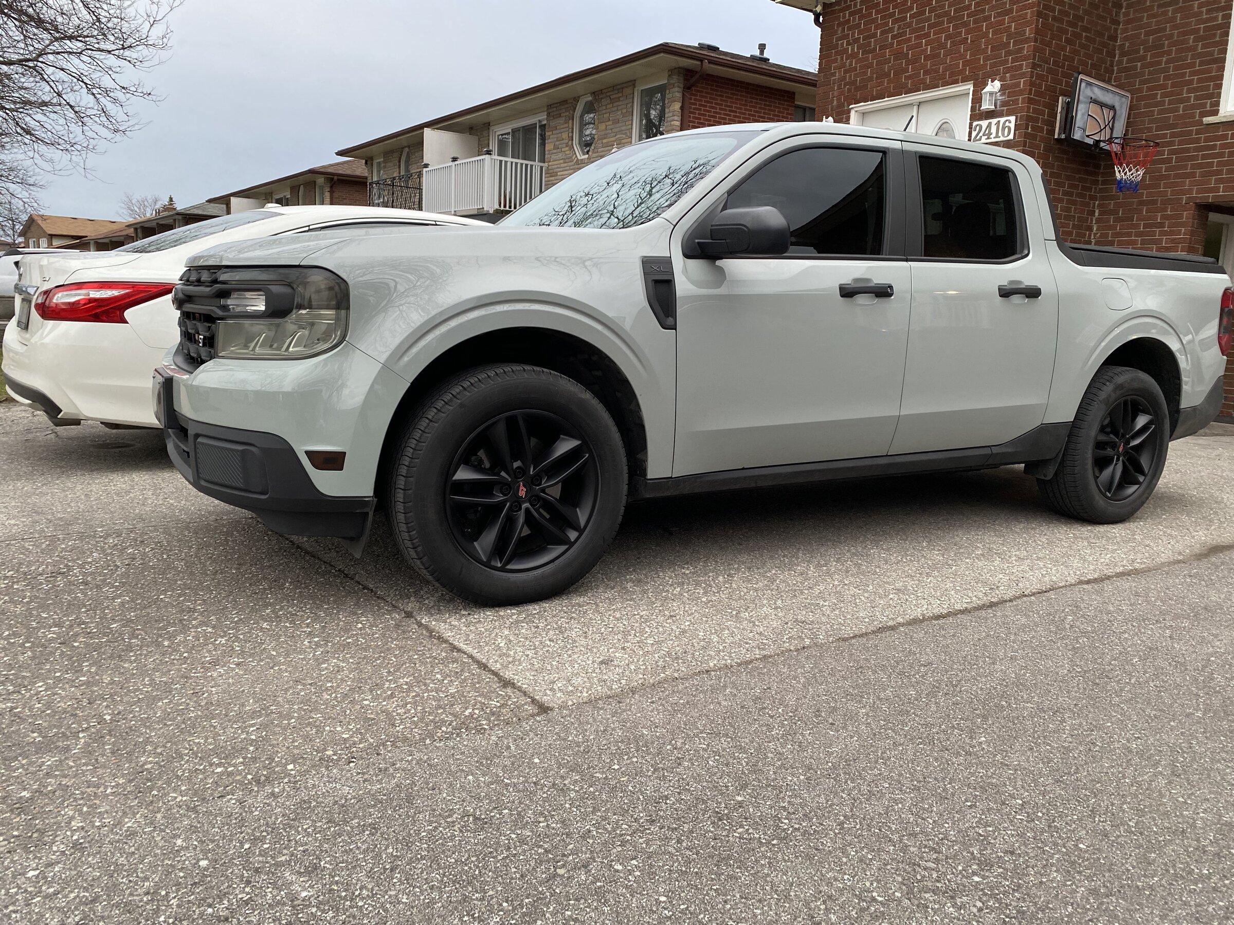

Plasti dip is the way to go. $15 for the bottle
Ford Maverick Best way to black out wheels? 2D43EB34-BC03-4FAE-A8AB-66D804EBC989
Ford Maverick Best way to black out wheels? C632D517-60F2-4D17-8F62-9EAC3527CD8B
