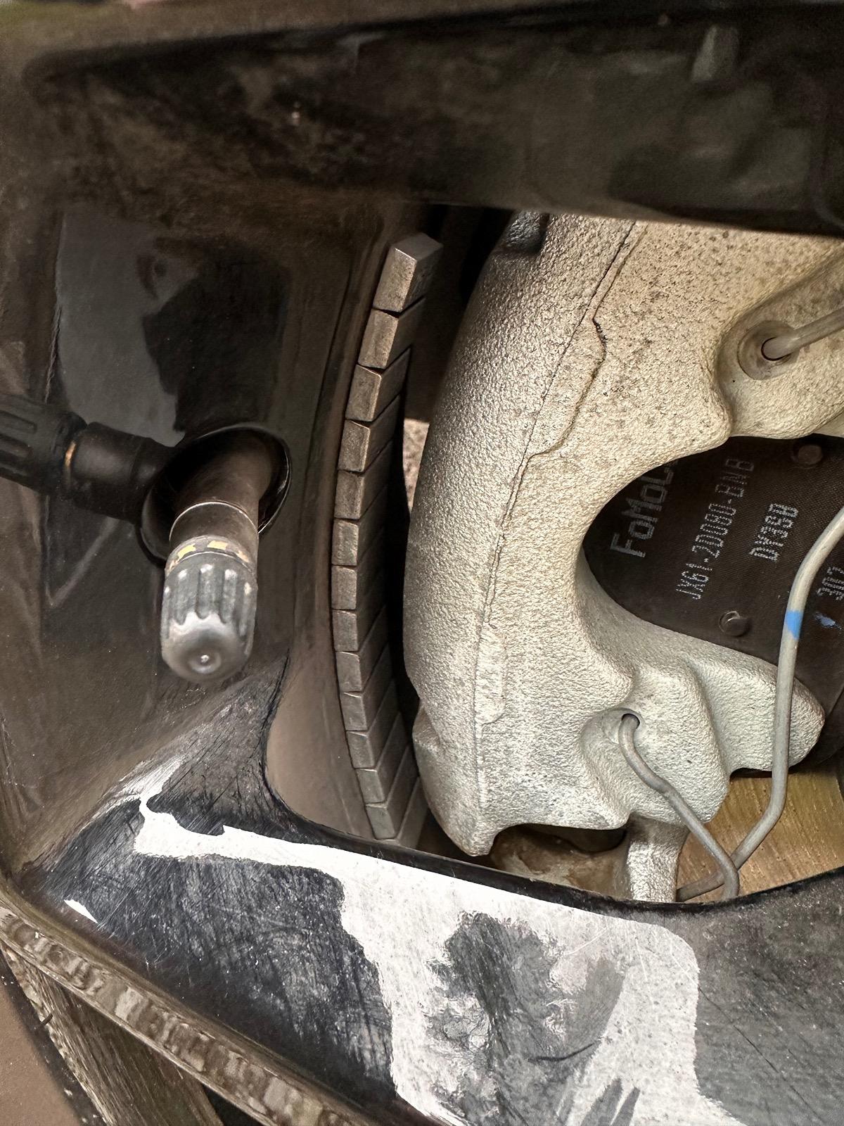

I love my Maverick and I have a 24 XLT AWD, FX4 with 4k tow and lux pkg. I’m taking my vehicle in to the dealer this Wednesday for them to check the alignment. The steering wheel has been off center since I got it. It I’m an hr away. I have noticed a super annoying vibration through the whole vehicle but more so through the steering wheel that reduces when I’m driving slower and is gone when I’m stopped. I was looking over the truck yesterday and noticed an abnormal amount of wheel weights on my front driver wheel. I’m hoping this is my vibration.
That’s a lot of weights.

Also to note all the other wheels only have like 2-4 weights and steering wheel center is off to the right very slightly with 2-3 psi more air pressure on passenger tires. Initially I was talking it to have alignment checked but the vibration which you can feel through the steering wheel is at all speeds but very annoying at 55+ mph. I’m confident they will take care of me. The dealer has been great through the whole process of getting vehicle and has very good communication. Hopefully it’s just a bad tire/wheel or maybe just a rebalance.

I'd put money on it's a bad tire too.

I’m willing to bet it a bad tire from the factory.
