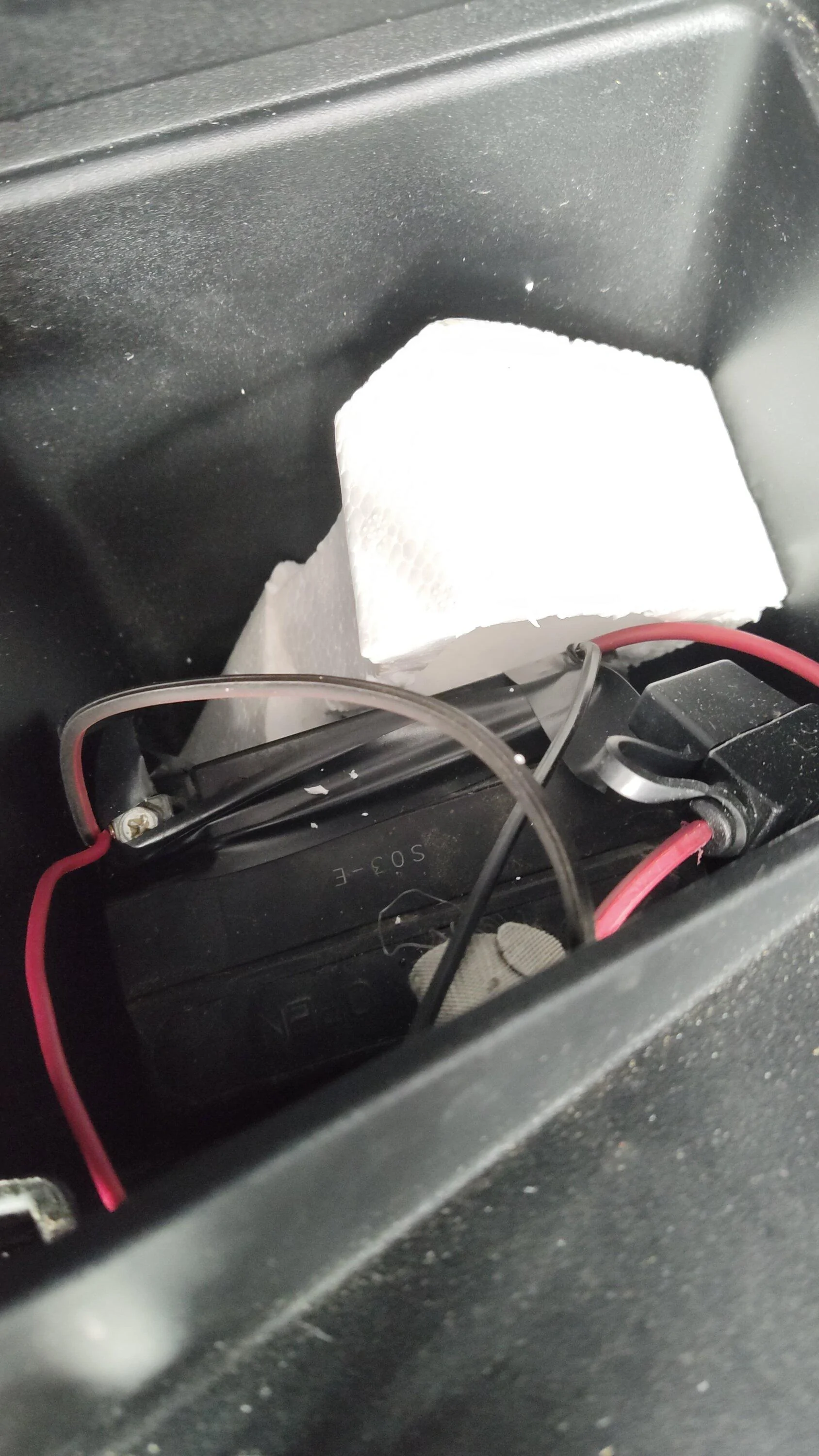

You have a 12-volt motorcycle battery tucked away in the other cubby? What is that used for? How do you keep it charged?
My led lighting in my bed... The truck 12v times out after 15 min (unless modified in forscan). How I keep it charged... Have a hidden connection for solar panel or clamps for battery charger.

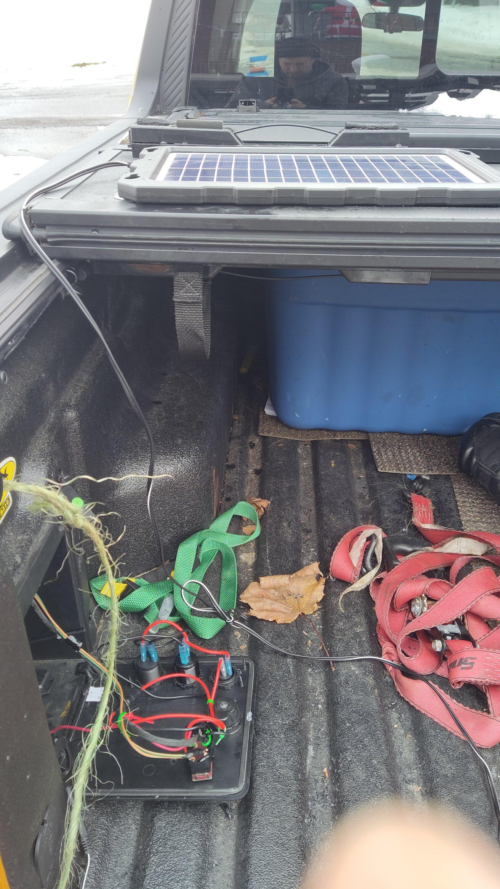

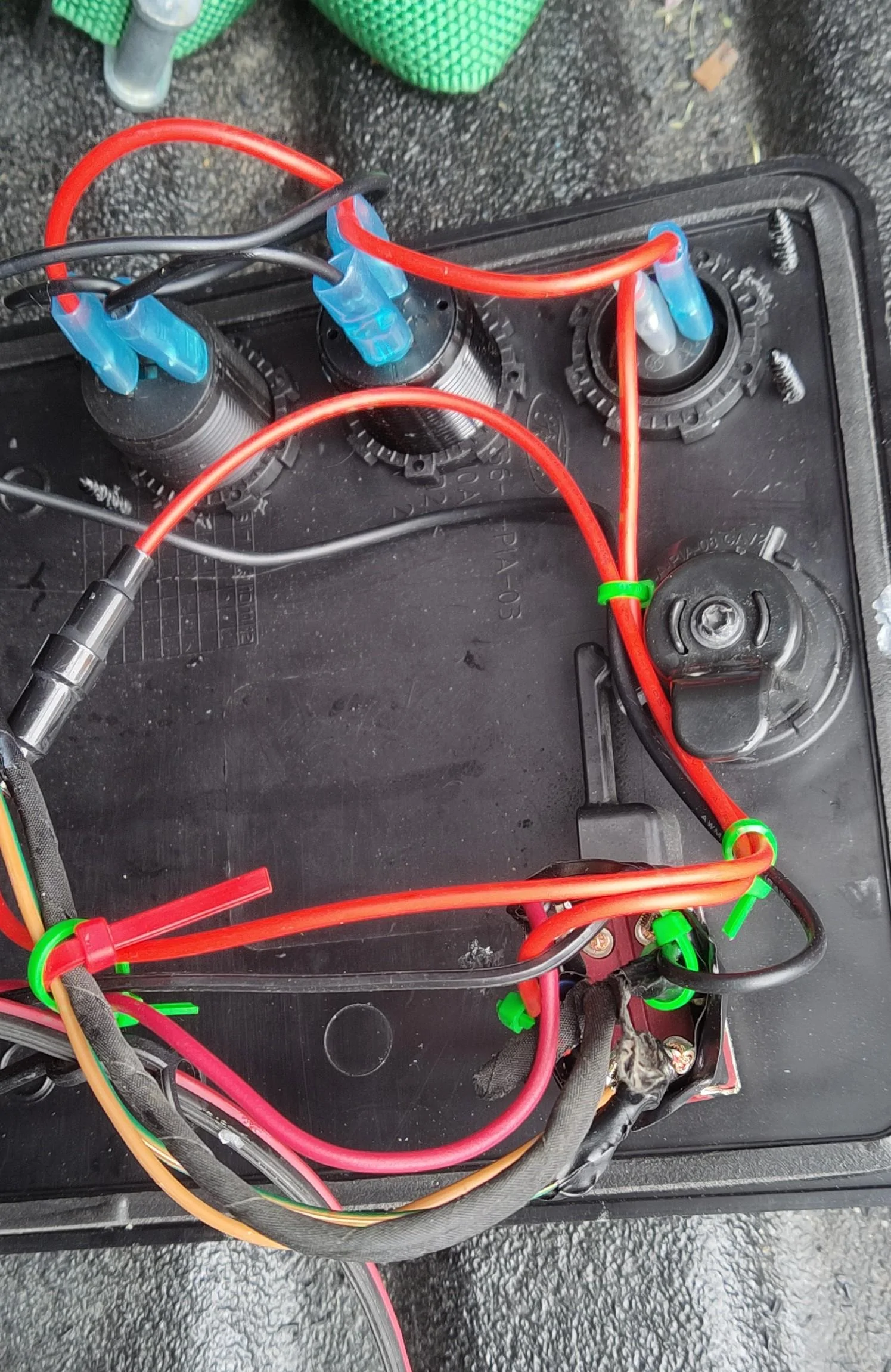

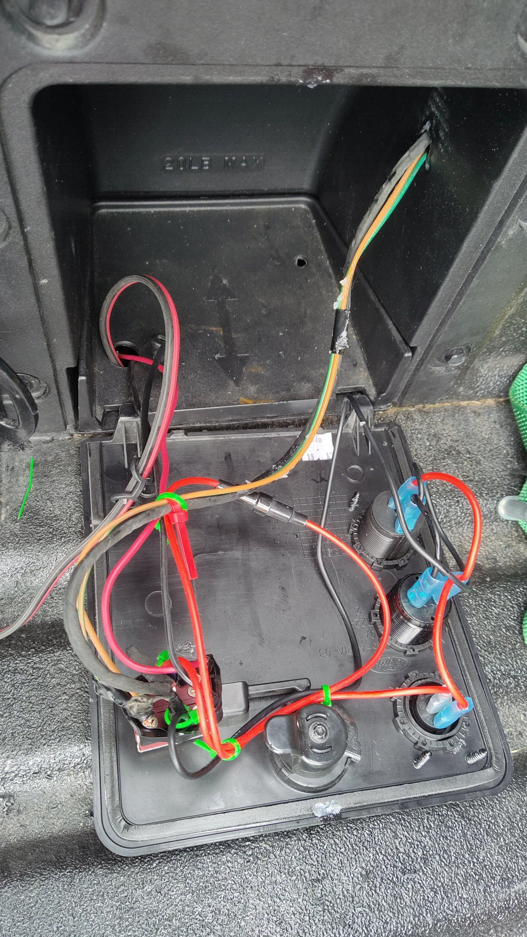

Feel like running us through that set up and install? Would be interested in how/where you've rigged it
So battery is in cubby with negative and positive going to the left connections on the 3 way switch
On the right side the switch has the 12v power from the truck
The middle connections feed the accessories like my led bed lights and the power station (usb/Aux sig power).
I have another direct wire connector directly to the battery in the cubby for charging like solar or battery charger.
