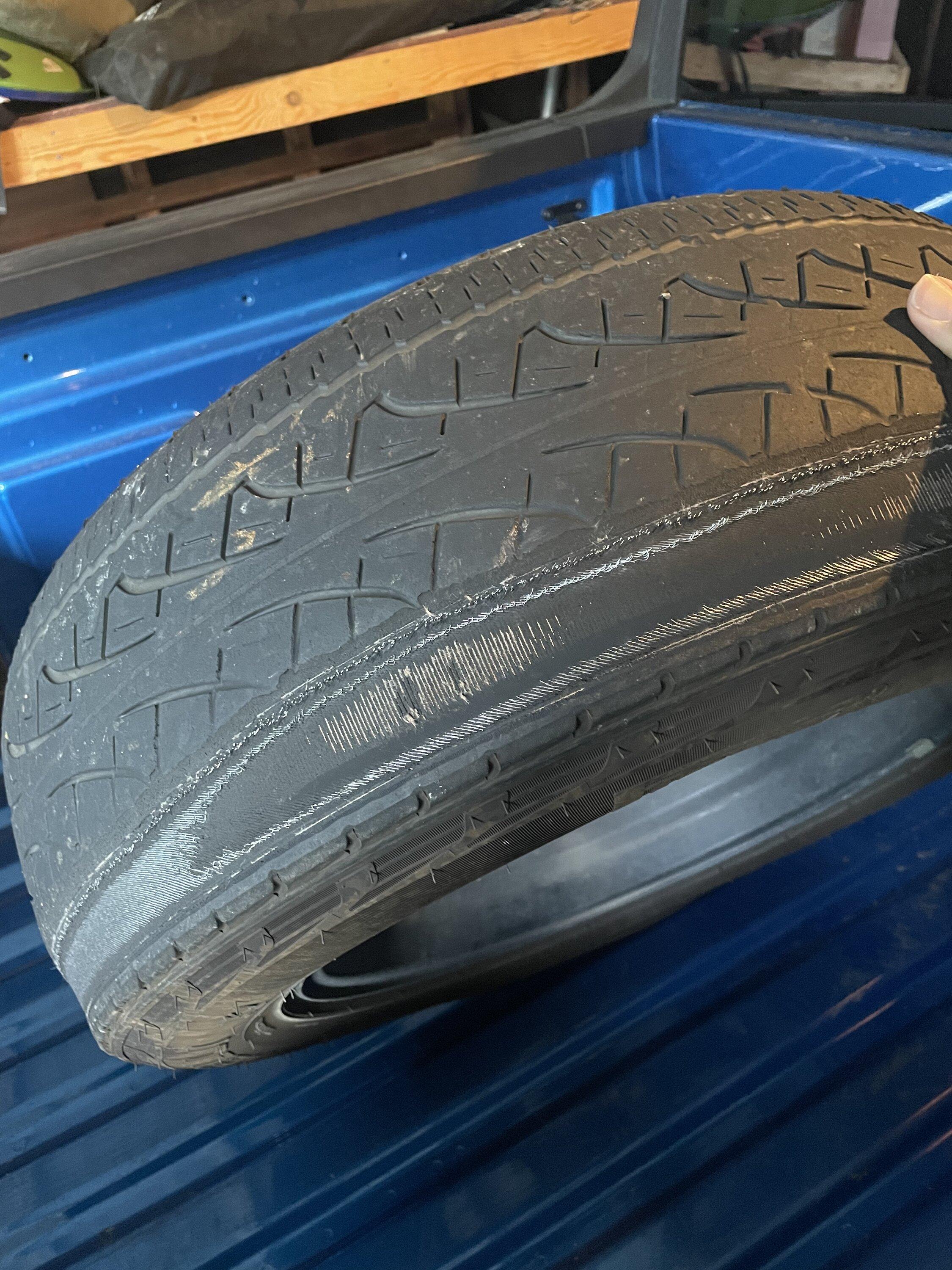

Are you sure about the reason you were given as excessive wear on the outer edge of a tire is because of one of these reasons:
Reasons Tires Wear on Outside Edge
Poorly Inflated Tires
Bad Wheel Alignment
Defective Ball Joints
Malfunctioning Suspension
On a brand new vehicle I suspect underinflated tires as the likely suspect.
I tend to agree, I am not convinced that the door tag on these trucks is accurate. I added a bit more air, Inflation on the WildPeak (aka WildRide) of 35 lbs is low for highway and high for rough country. I run 38-41 lbs in the tires for highway and it seems to run about right but when I get it serviced they always air it down to 36 so I think Ford really needs to look at that pressure recommendation.
You might be right. I typically add 1-2 lb over and find that it's down to spec within a week - that's with all our vehicles. The only way to be sure is to keep them consistently inflated and watch the tread wear over time.
In the Mav, tire pressure is easily checked on the dash screen. There is never a reason not to be aware of the current tire pressure. It saves money on gas and keeps the tires wearing normally. It's one of the little things I like about mav - just flick the switch on the wheel to scroll through the selected screens and your tire pressures are all on a graphic. Super easy to track.
It sounds like OP spends a lot of time on rough roads though.
I completely agree. When I got my truck all the tires were inflated to 40-42PSI. I dropped it down to 35PSI like the door recommended and ran into this issue. When I got it back from the dealership they had them all at 38PSI. I'll probably be keeping them in that range from now on.

They tried to pull the under inflated thing on me but I keep my tires at 35 cold just like it says on the door sticker.
Wouldn't tpms warn you anyway?

So far I haven't gotten a warning and I have TPMS on all three sets of tires. The only ones that would even possibly get the warning are the Wildpeaks but I don't air them under 22 psi because I don't have bead-lock rims

Dude if there are under 10k on those tires you better have the front end of your mav double checked. The alignment is so far out that even if it were a different compound they castor and toe are totally screwed up.
