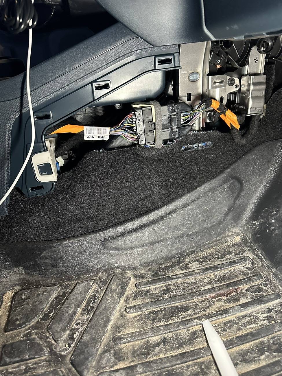

If I stated driver's side, I was in error. On the Driver's side after taking panel off, and it has a bolt in it, I had to remove a bolt that the held the module up. Once I did that, I could get the module out. Unplug the plug on top is the only way to get module out.
On passenger side of truck after taking off the panel you see this in 3339.jpg.
Ford Maverick Auto-stop eliminator? 1741972424269-m8
See the braket to the right of the orange tape? That is were the OBD2 connection is.

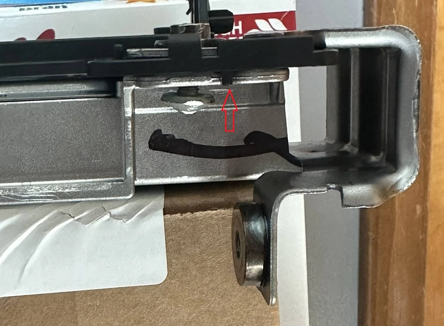

In 3341.jpg is shown the back side of the OBD2 connection.
Ford Maverick Auto-stop eliminator? 1741972753772-vr

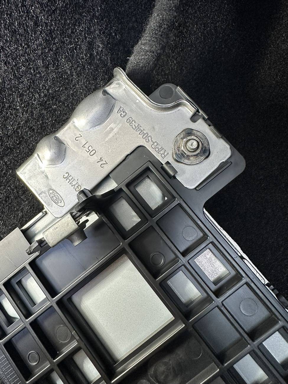

That nut that is spot welded in, has the security screw in it. Even 4Dtech was supprised that the security screw was there.

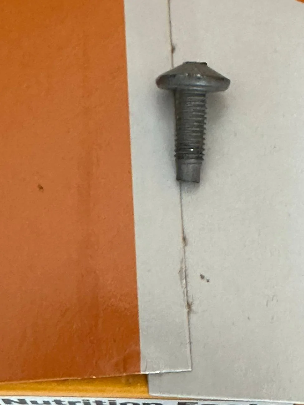

In 3331.jpg I have started to get the screw out. But to do that, I had to snip off a little bit of the tab that the module is resting on, just to the right of the screw. Take a pair of needle nose pliers and
squeezing hard, the screw twisted out.
Ford Maverick Auto-stop eliminator? 1741973605091-yk
Went to hardware & got bolt & washer that fit so that I can put it back together.
EDIT (The size of bolt is m5x0.8 x .75" long and use a flat washer.)
