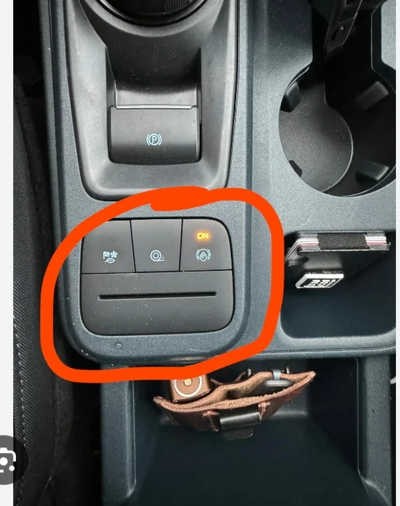

Mike,
This is where the button is located on the console of my 23 XLT hybrid.
The same as your 23.
The system is on when it's illuminated.
Press the button to disable it.

Yep, auto brake hold. You probably engaged it accidentally. An easy fix.

It's where the HVAC controls used to be on the 2025 Lariat Hybrid, the button nearest the driver in that little button control strip, for anyone else looking for it.
