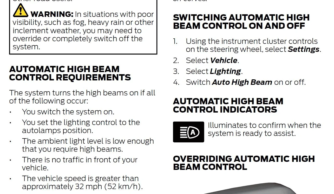

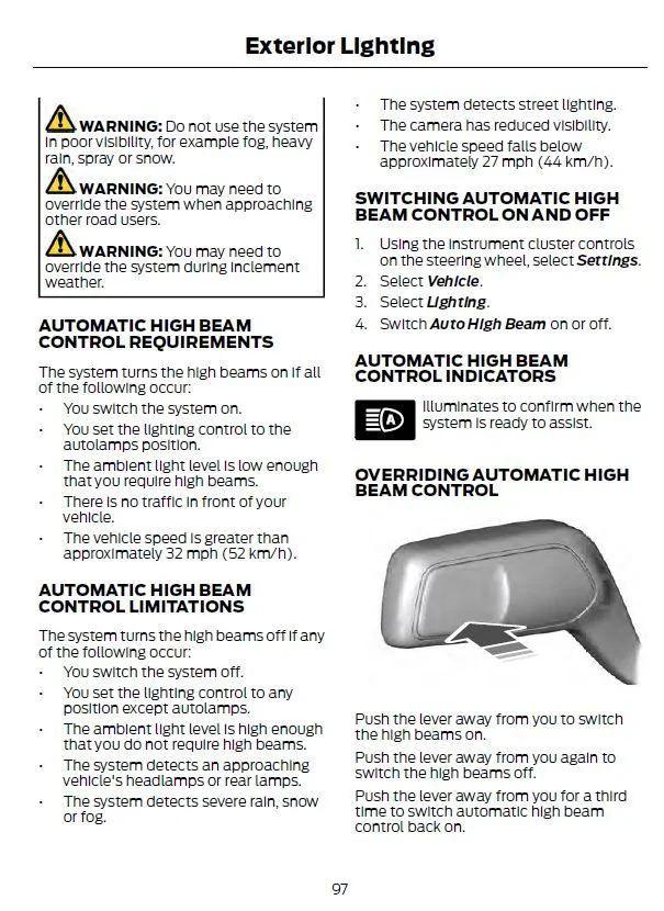

I dont have any setting on my '23 Lariat to disable the auto high beams. They are very annoying...
You likely do and just aren't scrolling up/down far enough in one of the menus to get there.
You can change the setting in the Menu, OR just put the headlight knob on "ON". It's only in "Auto" mode will it auto high beam.
