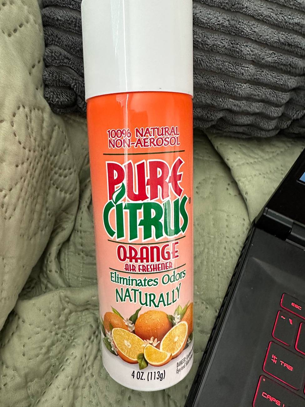

One day I was walking through Lowe’s with an old friend of mine who did contracting work for them. He had to go replace some stickers they had on the racks and I asked him how he gets those off so easily and he showed me what he uses. I’ve used it ever since as it has never failed me yet for any sticky substance removal. I’ve removed previous stickers and all my dealer decals with it with 100% success. If at first it doesn’t appear to work apply more liberally and let it sit for a couple mins to work, and keep applying as needed. Does not damage paint and will wipe clean. If the spray leaves a residue a cloth with dish soap will take it off
Both Lowe’s and Home Depot usually have it in stock and sometimes Walmart has it as well, pretty readily available at a local store and only like $6 if you don’t want to wait on amazon. Worse case scenario you have a can of smell good
Be careful around plastics such as the bumper. It will dissolve some such as a CD case.

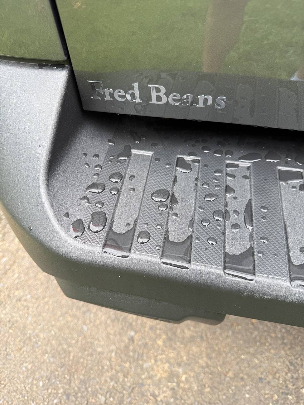

I've been attempting to get the dealer's name off my truck for a month now. I tried Goo Gone and Turtlewax label remover, while using a plastic scrapper. If you look at the photo, only a small part of the N came off. Does anyone know any methods to remove their sticker without damaging the paint?
first trip to the car wash and the high pressure wand took it right off...........I would suggest washing around it with soap and water and then get out a heat gun or hair dryer to soften the decal and plastic to scrape or pick at it BUT BE CAREFUL...........
