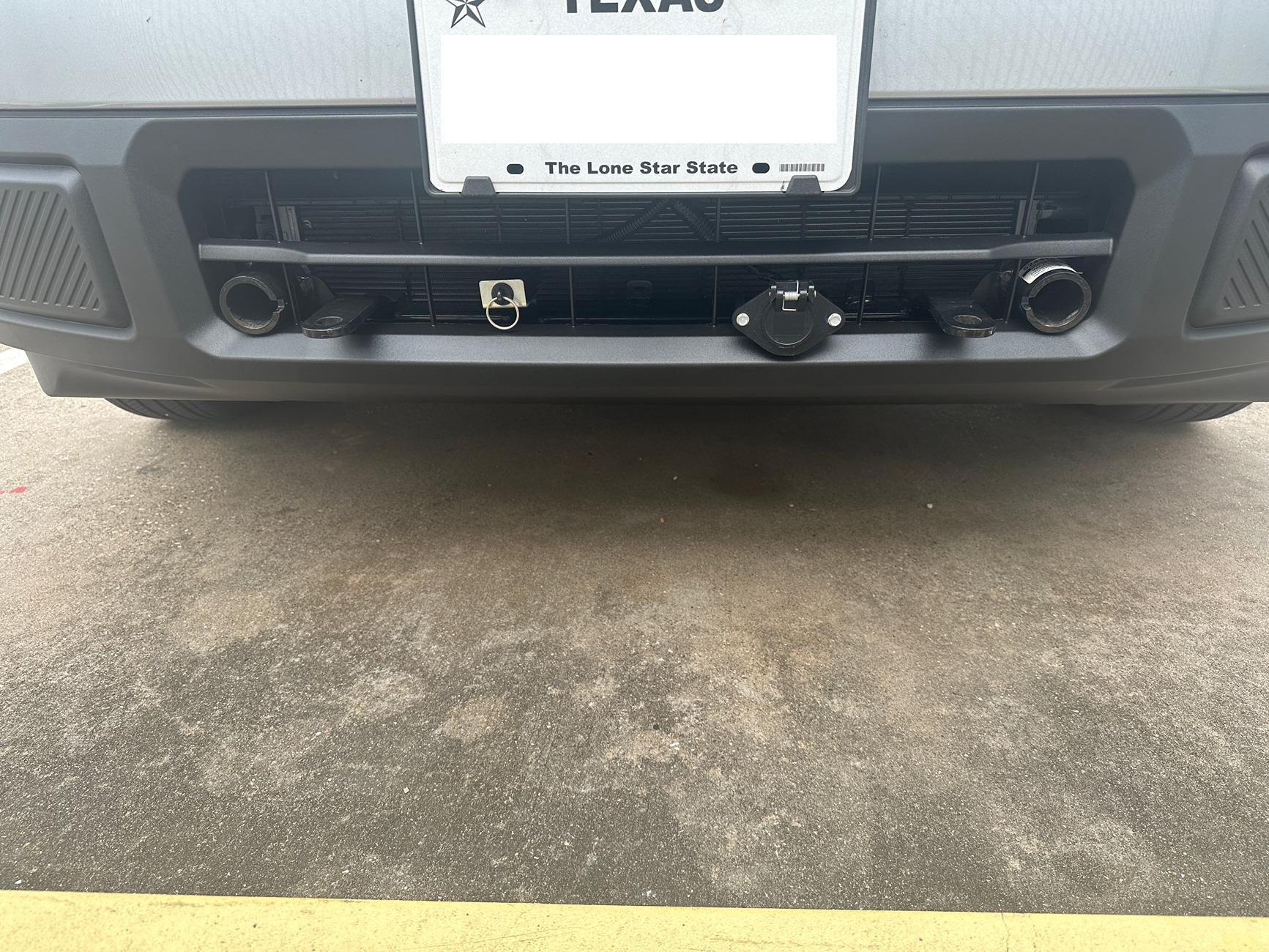

I put a Roadmaster Base Plate on my 2024. The lower shutters had to be removed. No cutting oh the grill required. Using a Falcon All Terrain tow bar. Tows great.
