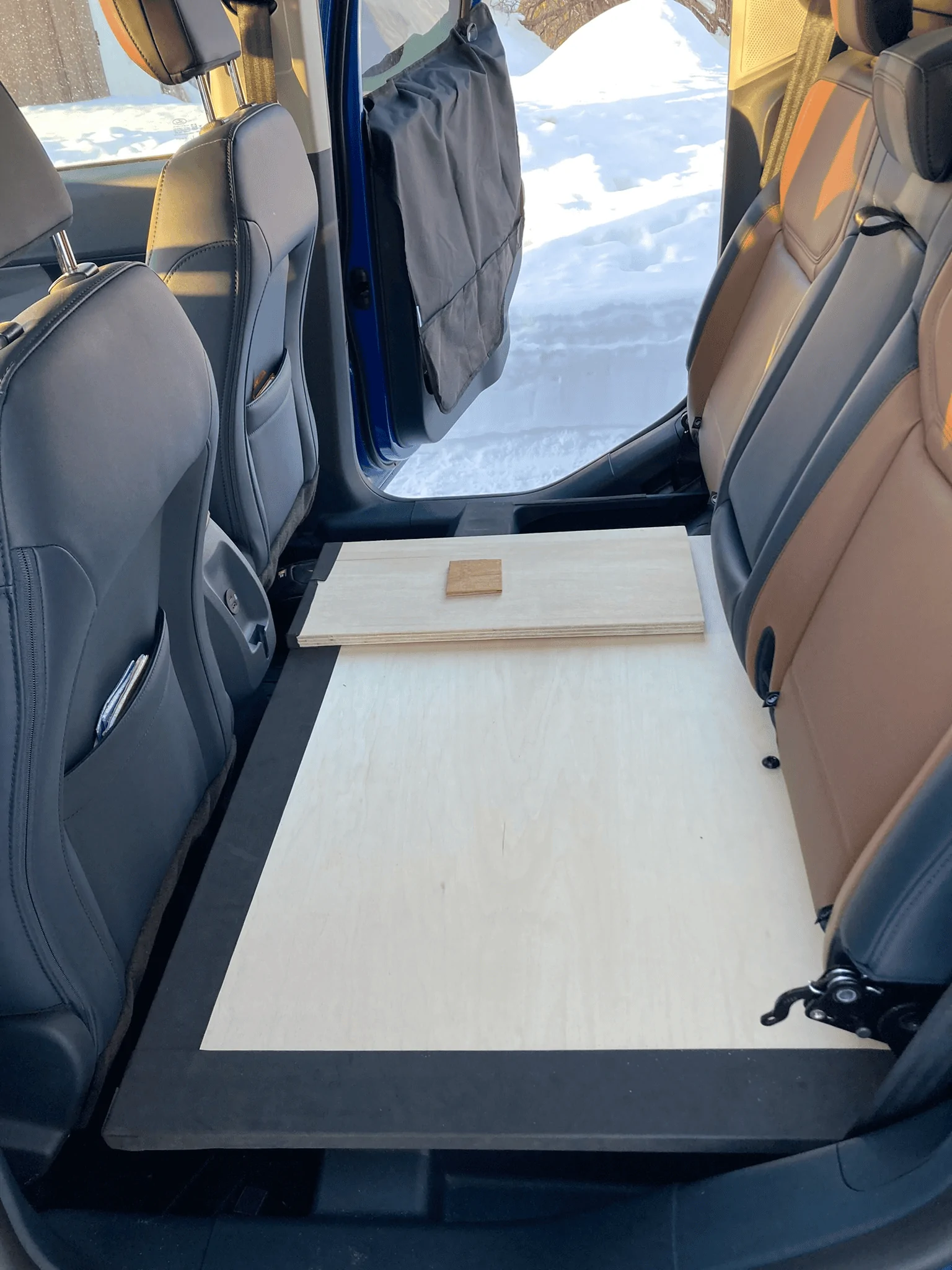

With no aftermarket rear seat "delete" kits apparently available (yet), I took it upon myself with a sheet of 3/4" plywood.
There's another thread out there from someone who used a 4'X2' sheet and just bolted it down into the seatbelt floor anchors. My solution took considerably longer because I wanted to fill a few more inches of space in each dimension. I ended up buying a 4'X4' high-quality 3/4" sheet and cutting out a 27"X40" section that I bolted in. Then I added a hinged smaller section (11" wide - I forget the length dimension offhand, but it's shorter in order to be able to clear the seatback and swing up). This allows access to (part of) one of the underseat storage areas. This configuration took up just about all of the usable width inside of the rear doors (51").
Due to a lot of little issues, this took a lot longer than it should have, but I'm pretty happy with how it turned out. Only slight regret is that I'd thought about finishing the plywood somehow for those times it gets wet. Instead I settled for attaching adhesive neoprene (which I already had) along some of the edges - I need to buy some more to finish it. I play to leave most of the platform covered with a foam mat as shown.
There is one problem with bolting in a pre-cut sheet and just being done with it: Although there is a mostly solid, plastic-covered metal frame around the front and back of the underseat area, the back middle of it (the crossmember) is slightly higher than everything else. So once I got the plywood fitted, I ended up sticking on small, thinner pieces of wood - shims, if you will - in several spots to make sure the sheet was level and had no noticeable curvature or "give." So it's not just supported by the higher center piece and wobbly on either side of it.
Tips:
  • The seatbelt anchor bolts are M10 1.5 pitch. I purchased new ones with 50mm length since the original bolts were not long enough for the 3/4" plywood.
  • The small holes behind the seatbelt bolt holes are for screws that protrude from the floor; I wanted them to be able to pass through the board.
  • I also attached adhesive neoprene to all contact points, especially weight-bearing points, in the underseat storage/support area.
  • I left the seatbelts attached behind the seat. It appeared it might be a challenge to remove at least the driver's side belt. Also, removing the wiring to the seatbelt sensors would have triggered a fault warning every time I start the truck. I found a Forscan fix for this that supposedly worked on a Ranger, but I decided it wasn't worth the experimentation. Maybe later.
The main reason I did this was for the dog (I want her as low in the vehicle as possible for safety and minimal distraction). But it will be much better for cargo capacity even when she's not there. I have absolutely no need for a rear seat 99.5% of the time.
Maybe eventually a good solution will be developed to put a cover in place of the seatback as well, but for now I'm not concerned about it. Everything looks good and I'll probably cover the seatback with a sheet for protection.

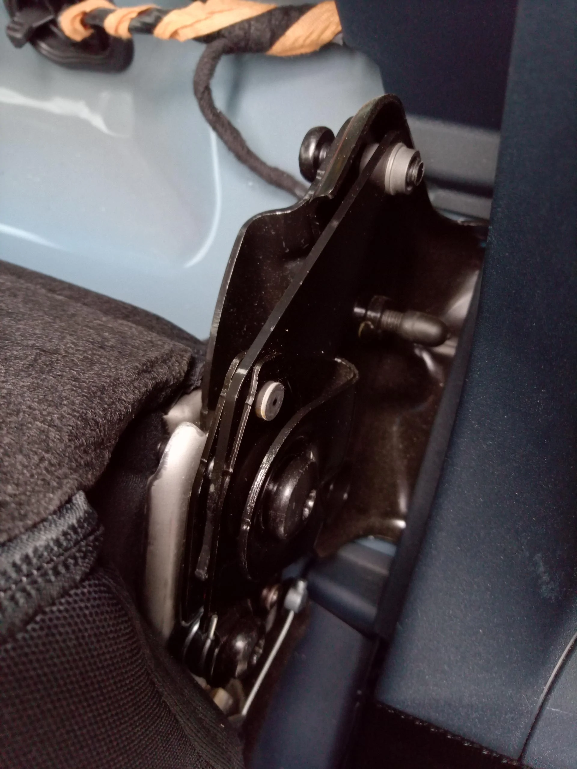

Thank you for this information. A question did you happen to take pictures or document on how you removed the bottom rear seat? Which bolts need to be removed?
Thanks in advance.
P.S. I am still waiting for my 22 Mav 444 days. Can't find a transport for the last 45 miles to my dealer.
Had to put the seat cushion back in today. Once you get the plastic covers off each side there are two torx bolts, one T45, one T50. The top (faces out, partly removed) and third one down with the larger head (faces in) in the pic.
Hope this helps.

Great idea. I for one will be using the mav as a one/ two seater and will not use the rear for people. It's seems like you are still giving up one pocket under the wood on the driverside. Any thoughts to build an access door for that side or was that considered and dropped for some reason?

I was wondering if someone would bring that up! I wanted a larger single piece of plywood on the driver's side because it's more stable. The dimensions of that side were originally based on the dog, but either way I think it's better this way for heavier items. But I wanted to still be able to access at least one bin. I could definitely see having a hinged section on each side, and also having those sections span the whole storage bin - here it's about half covered. There are several ways to do it based on what works best for you!

What about using like a drop leg to go into the void a little and possibly add a piano hinge? Might be a little sturdier.

Yep. At one point I thought I might need to do a drop leg even without a hinge but decided it wasn't necessary in this case, especially with the 3/4" plywood. I agree it would make hinged sections more sturdy. I might have hinged the other side if I wanted to put any more time into it... which I did not and do not!
I also could have fastened my hinges to the edges of plywood instead of the top surface, but I didn't want to screw into the edges/plies, and that would have also left a larger gap. Some way of hinging that would create a flat surface would be the ideal.
