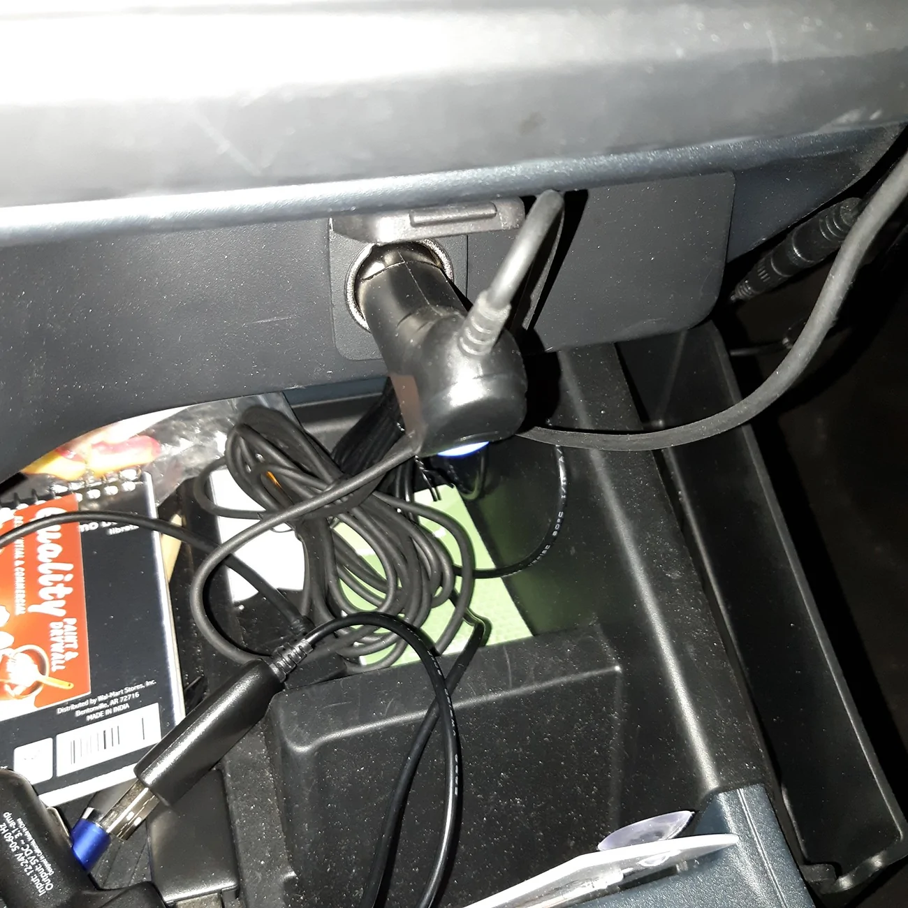

This pertains to the 12V power outlet, formally known as the cigarette lighter port. :crazy:
It is documented here as staying on for 90 minutes after the ignition is off give or take with a good SOC on the battery. I decided to power my dash cam from the 12V port to utilize the 90 minutes on time to power the cam while parked shopping or running errands. If I need longer I will just use a power bank.
I started to notice that during very cold weather say 20F and below the 12V port will not stay on after the ignition is turned off regardless of SOC. It has been crazy cold here for a long stretch but today a heat wave to 40F and the 12V port is working again with the ignition off.
This all had me going for a while and thought I would share this. After over 2 years if ownership I am still figuring out my Mav. :thumbsup:

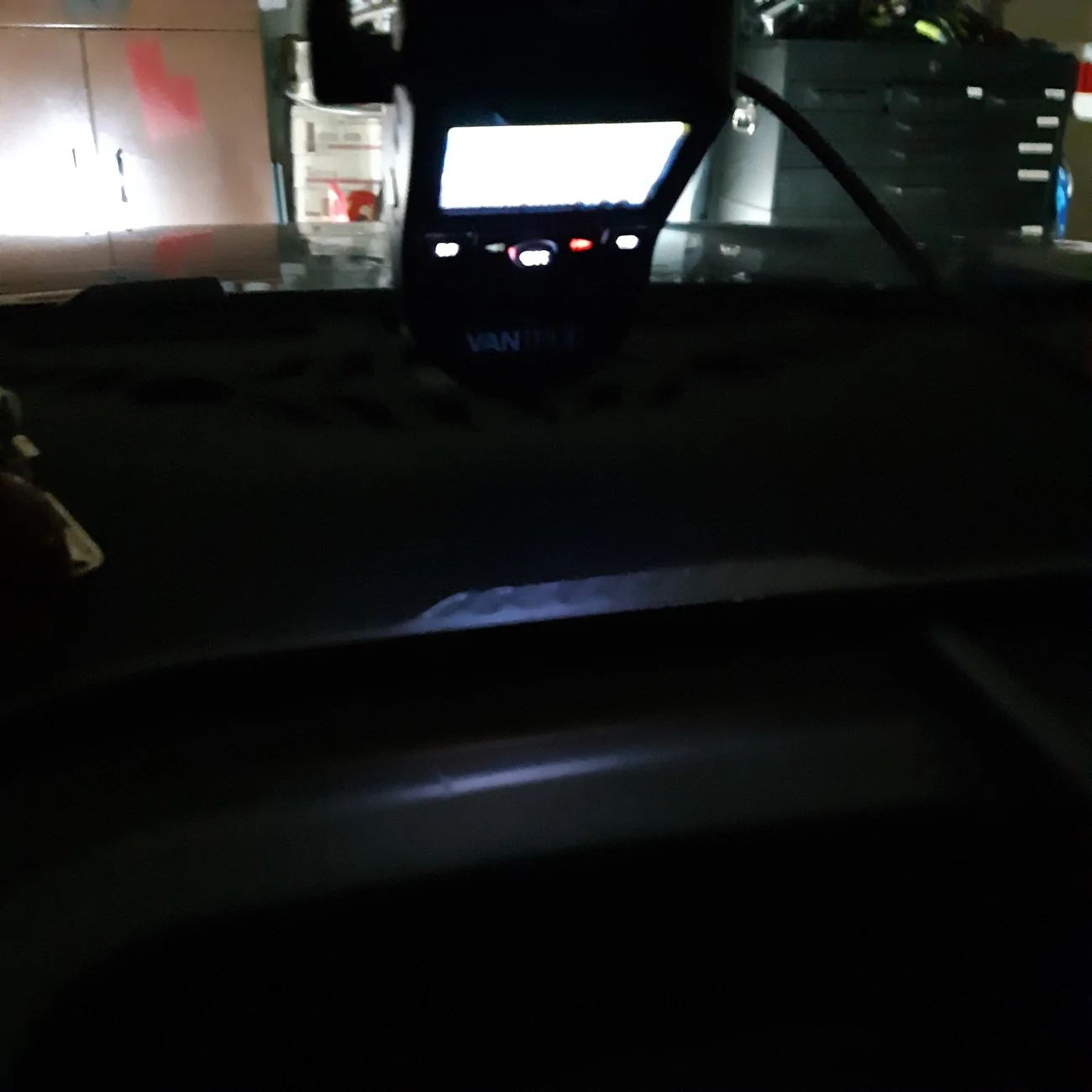

🤔 My dash cam is plugged into the 12V cig. Socket. It has a glowing blue light.
When I shut off the truck and and open the door, the power to the socket turns off immediately. Video below.
Sorry, it's dark to show the
light/Power turning off.
Even with a good charge on the battery, 12.6VDC with the engine off, my blue light was still going off as soon as I opened the door. Today, different story. :crazy:

Been some debate about that here. Some say shorter times, some longer. Apparently it is adjustable via Forscan. These modern vehicles do a lot of weird thing electrical wise. Not necessarily bad, just weird, different. Takes some getting used to for this old timer.

The max time to sleep is 75 min pre-25MY. 60 min newer.
So power port shouldn't stay on longer than that.
Considering the charging amps even changes depending on the battery temp - I wouldn't be surprised if the BMS system see too much of a difference between discharge to charge amount logged, and due to short drives or low charging when cold - it cuts off power earlier.
Since the SOC is calculated figure, it knows it can't totally trust that until another relearn happens after a few days.
Service Manual
Battery Drain Check
Check
NOTE: No factory-equipped vehicle should have more than a 25 mA (0.025 amp) – 50 mA (0.050) draw depending on the vehicle's accessories. Check for current drains on the battery in excess of 25 mA (0.025 amp)
– 50 mA (0.050) with all the electrical accessories off and the vehicle at rest for at least 75 minutes (depending on region). Current drains can be tested with the following procedure.
