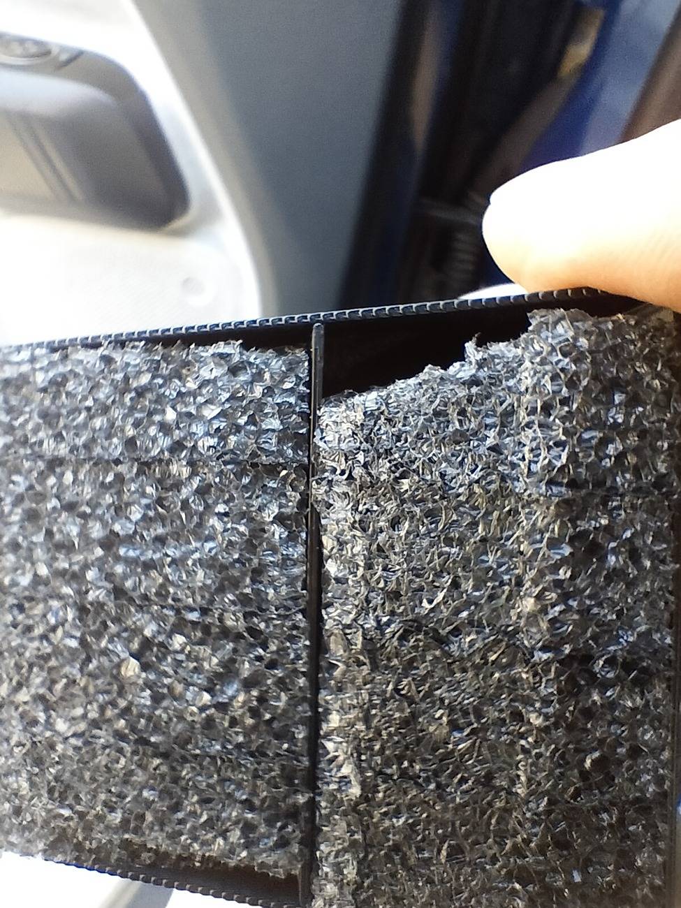

Double the price, terrible quality, the seller playing games with the shipping labels, no communication and you will have what I bought. But it fits well.
The 3D printed item was so thin the bottom nub that holds the drawer in the cubbie in broke off putting it in. The sides are so thin I had to fill the inside to keep it from flexing and cracking.
3D printed garbage.
But It did fit properly.
Good luck finding a product you're looking for.
I wish Mabett would make cubby drawers with removable attachments phone, GPS ball mounts etc.

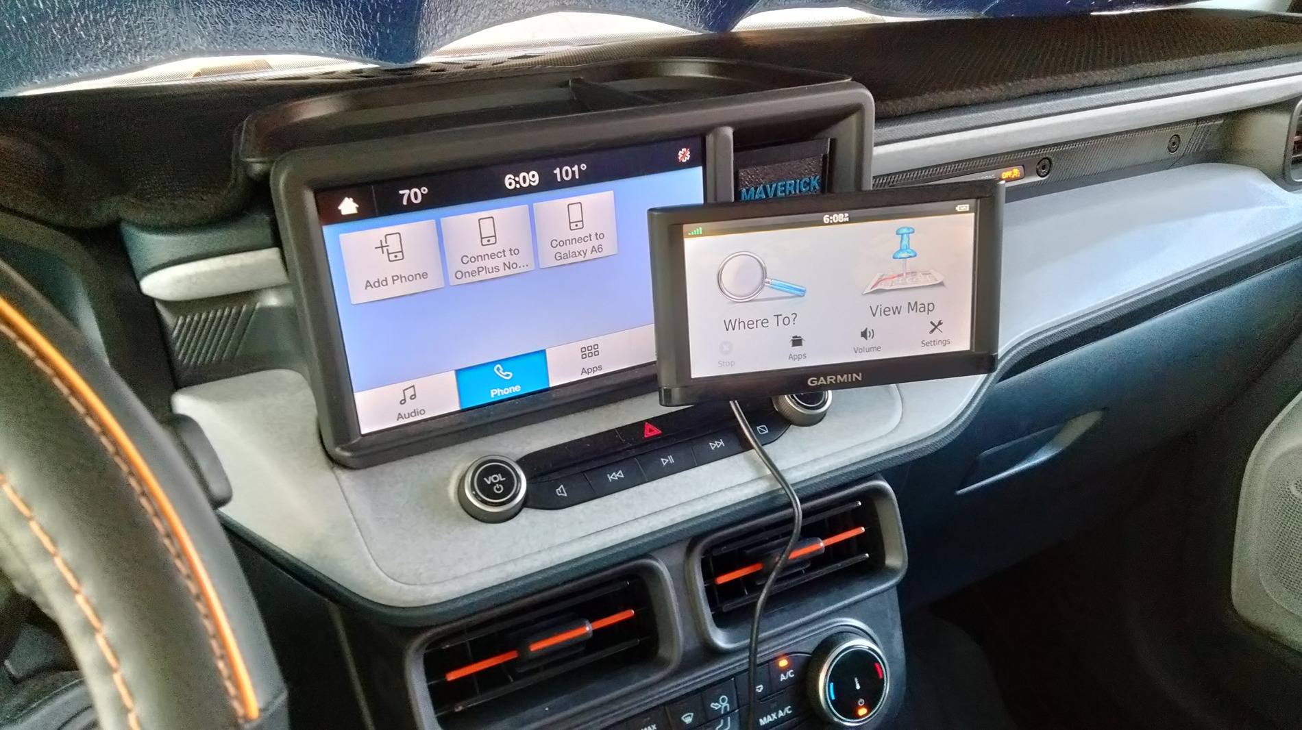

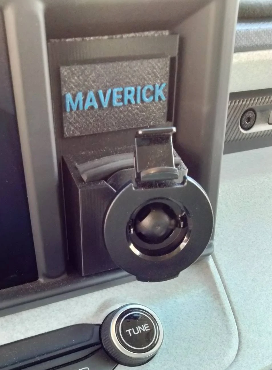

Unfortunately none of the above sellers sell a cubby drawer with a place for a removable ball attachment for my Garmin GPS.

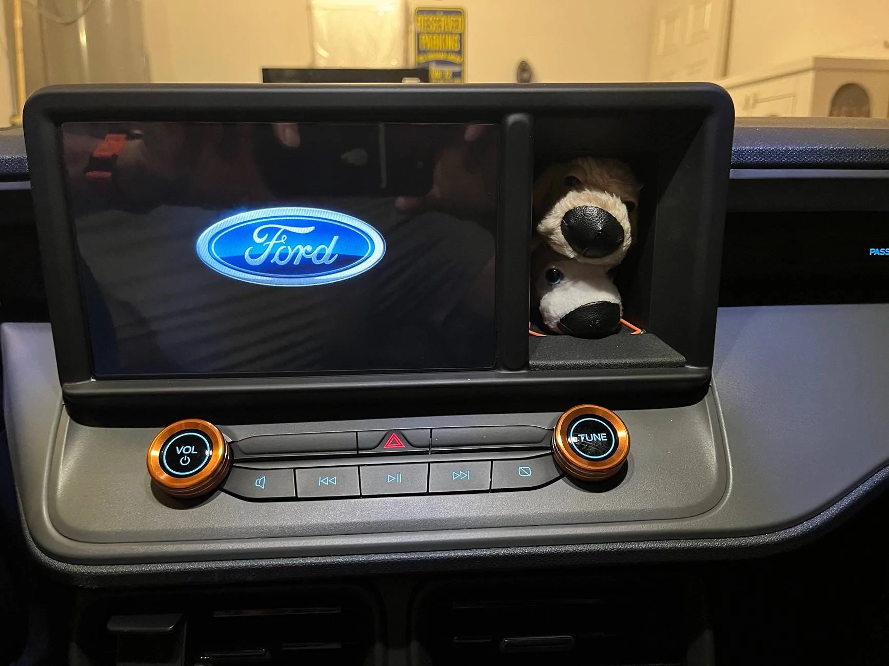

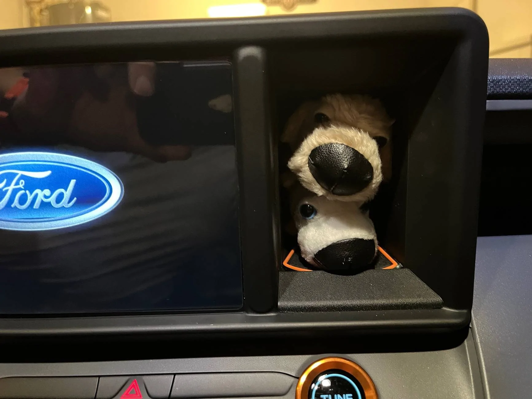

Who needs drawers?

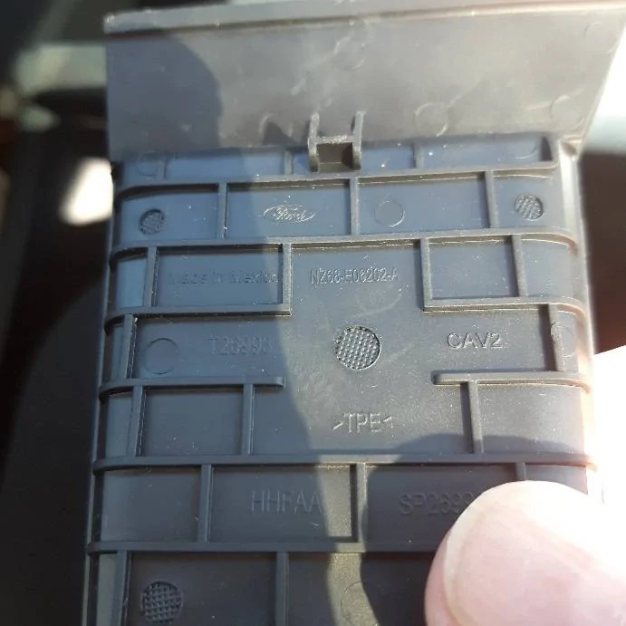

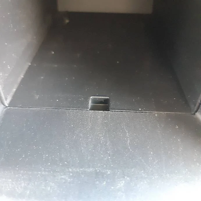

The insert will not pull straight out.
There is a little nub on the front of the insert. That holds the insert, so that when you pull things out of the cubby the insert stays inserted.
That nub fits into a hole on the bottom of the cubby. Lift up on the front first and then remove.
