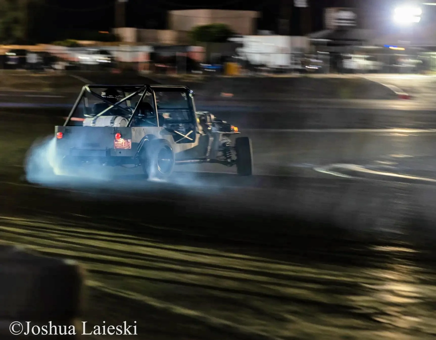

Is that a fucking Jeep Wrangler drifting?! See something new every day!
technically a 1950-1953 Willys M38 Tub (Korean war) . But the frame is 100% made using 2"x4".120 wall mild steel tubing. Front suspension is from a 06 crown Victoria, rear suspension, is a S197 "style" 3 link, but with a Watts Link Track locator. Its a Twin 66mm turboed 5.3L LM7 Chevy "LS" engine, on a Holley Terminator X engine management, running on e85. Makes 786.9 wheel horsepower, 745 wheel foot pounds of torque, on 13 psi of boost. I used to drag race it, but redid the rear suspension, added a TR6060 6 speed manual, and added a second set of rear calipers with a sealed hand brake master to run them. Now i drift it. ROFL. I have had a "1450" 5.0l ranger, i off-road raced, have had very built Subaru's i auto X-ed and then also Rally X-ed, drag raced a lot of different things, and then i currently own a 2020 RZR Turbo 4 with long travel suspension, but Drifting is by FAR the most fun thing ive ever done.
