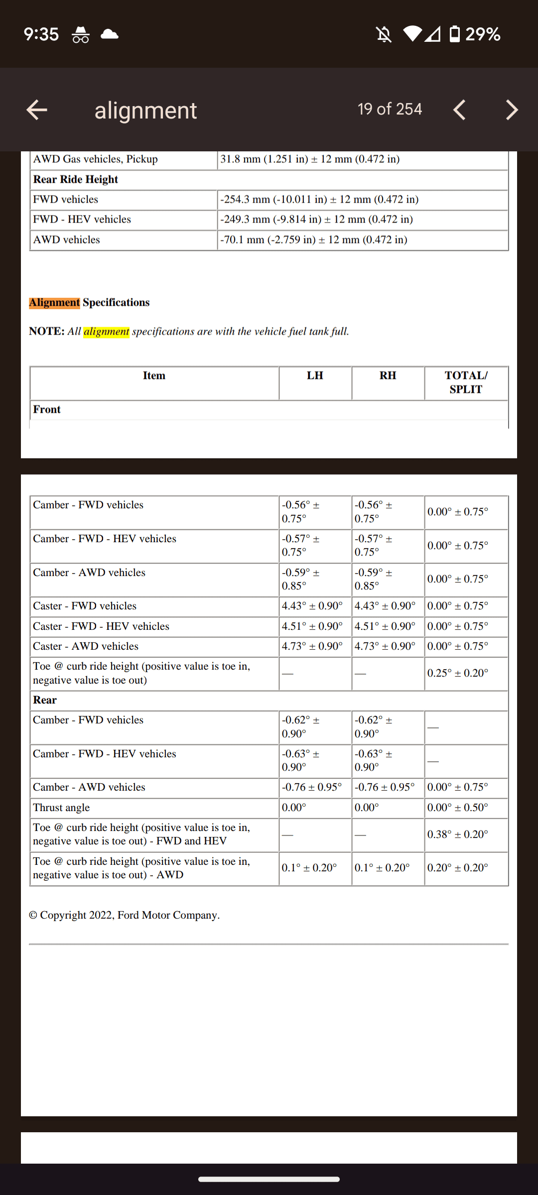

Does anyone have access to the alignment specs for these yet? I leveled mine and want to align it, but our Hunter machine does not have the Maverick. Any help is very much appreciated. I did a Google search also and came up empty.

I levelled mine and would like to align it, but our Hunter machine lacks the Maverick. Alignment specifications are often specified in degrees and minutes. Nonetheless, I am unable to obtain the alignment specifications. I also ran a Google search and came up empty-handed.
Ford Maverick Alignment Specs Screenshot_20230629-213550
I'm not sure what the values are for the Tremor though.

This is why I love this forum. Obscure information found and now helping others

This is very helpful. Do you happen to have any updated alignment specs for a 2025 Lobo?
I do not. I only have access to the 2022 manual.
