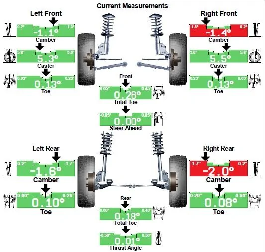

Checked with Eibach and the engineer had a Maverick and after installation his Hybrid Maverick was close enough without the camber bolts.
Attached is his alignment printout.
