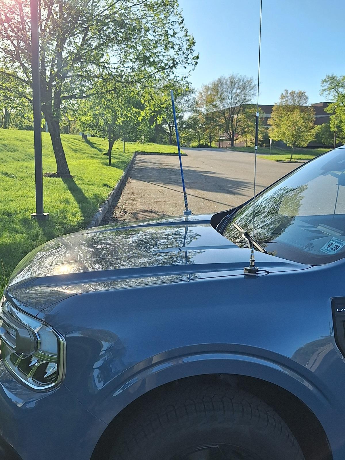

You spent all that time on the install but you need to upgrade your CB antenna. 2' isn't going to do much even with a SSB radio. You need a 4' antenna minimum to really start getting some good performance. I'd suggest a nice base load with a 40" plus steel whip. Difference will be day and night. I talk regularly on my setup to Australia and made some nice contacts into Europe this year from the truck.
So far I have not found that to be true. The firestik II 2' antenna has recieved and transmitted just fine. Have been able to talk to people around the country during skip no issues. I believe it being a 5/8 wave antenna helps. Of course bigger antenna will have better performance. I had a 4' firestik II on there but did not like the look of it on my Maverick.
