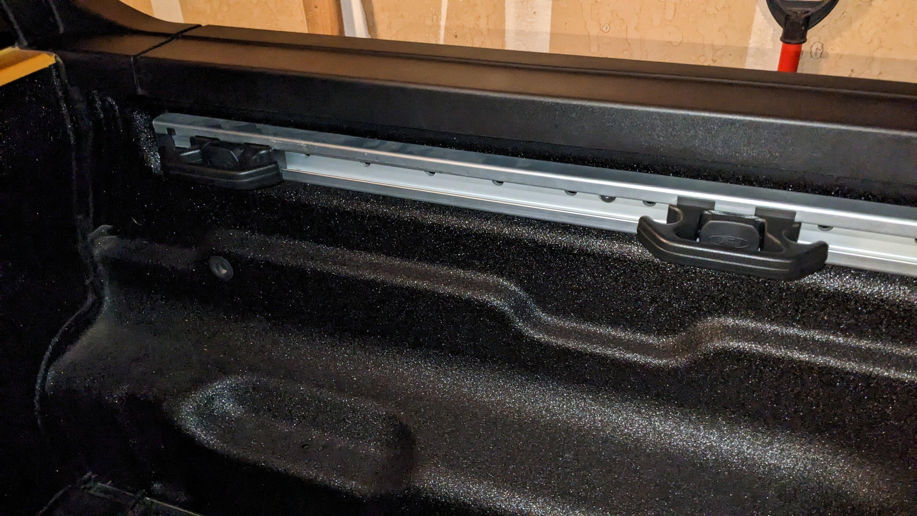

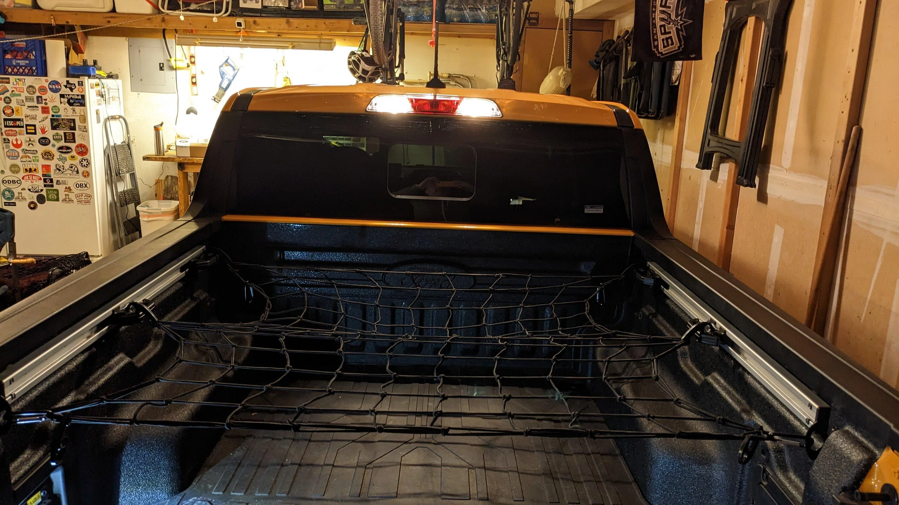

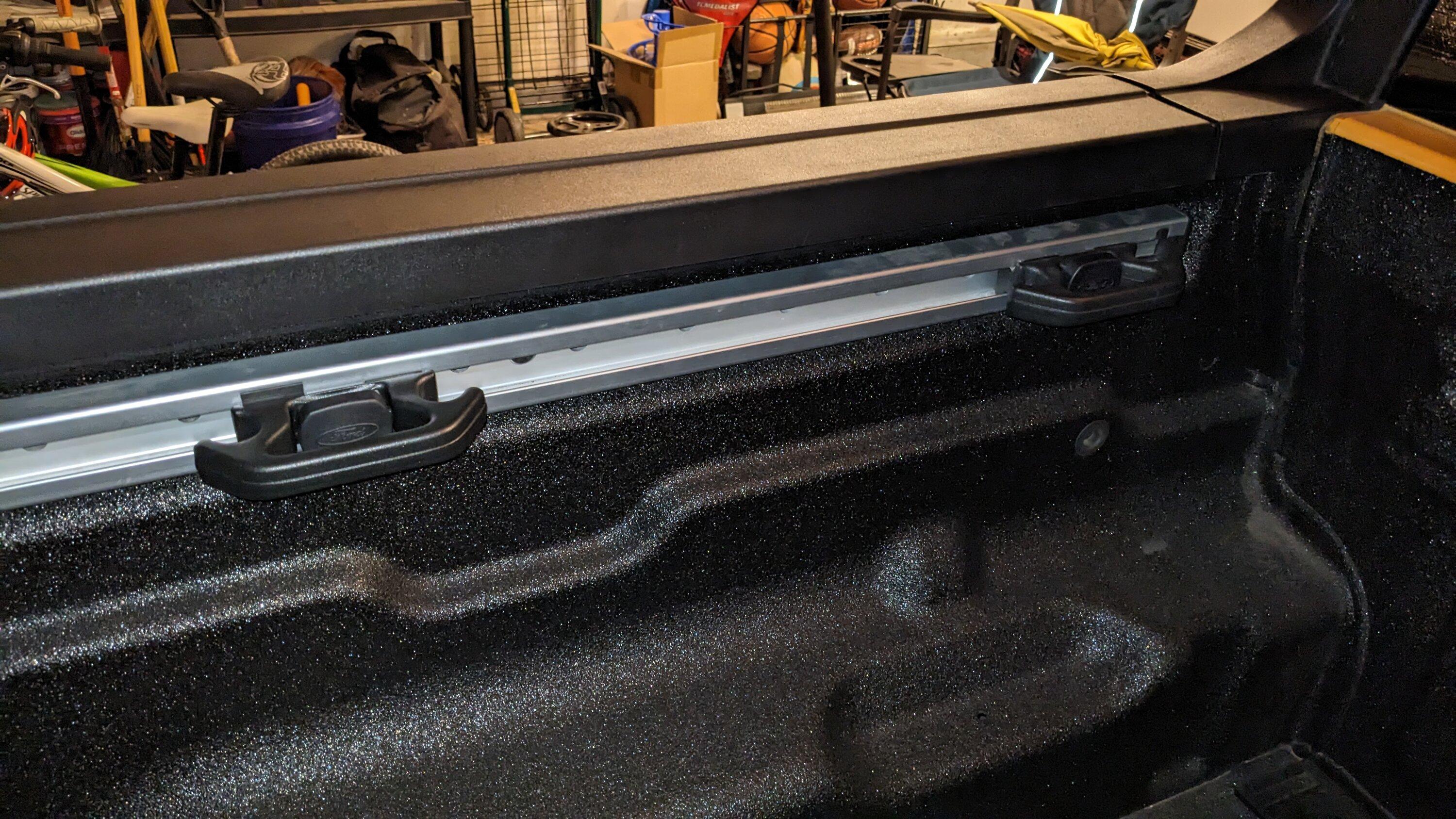

Hey MTC. I added a pair of OEM cargo management cleats to my bed rails to have 6 tie downs for my cargo net. I bought the 2 cleat kit from Ford accessories: https://accessories.ford.com/products/cargo-management-system-2-cleat-kit.
Installation was easy. You have to remove the rail, pop off the plastic end cap, then slide on the cleat. Then put the end cap and rail back on. You need a torx T30 bit to remove the rail.
Sorry the pics are dark, I installed at night in my garage. I'll take better pics during the day tomorrow.

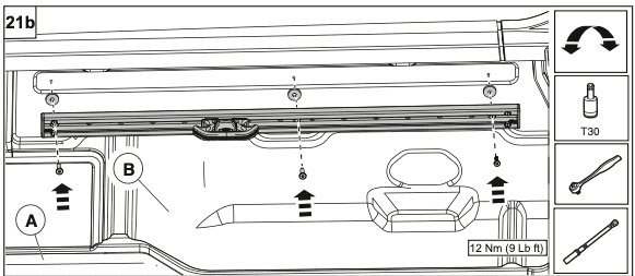

Do the instructions list a torque spec to re-install the bolts? Thanks.
Nah, they’re just simple little machine screws. Just turn ‘em until they’re tight.

I ordered the bed rails after receiving my 2022 XL. Torque specs on the M6x1.00x25 which is the one nearest the cab is 106.2+/-15.9 in. lbs. Torque specs on the M8x1.25x28 which are the middle one and the one nearest the tail gate is 132.7+/-20.3 in. lbs. These are taken directly from the installation for the bed rails I ordered.

This is from the drop-in bedliner instructions referencing reinstalltion of those bolts. It calls for 9 lb ft.
