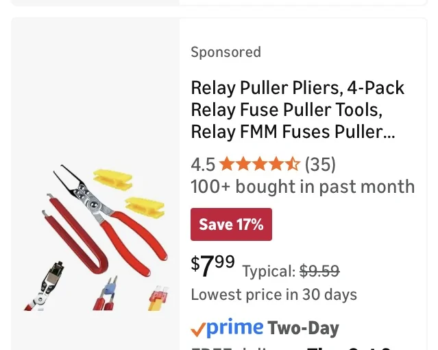

Sorry, but I still haven’t figured out how to access my inside fuse box to remove fuse 11. Maybe we’ll need fuse pullers of some sort?

That's a good point - IIRC Ford was too cheap to include those plastic pullers attached to the lids in either location.
