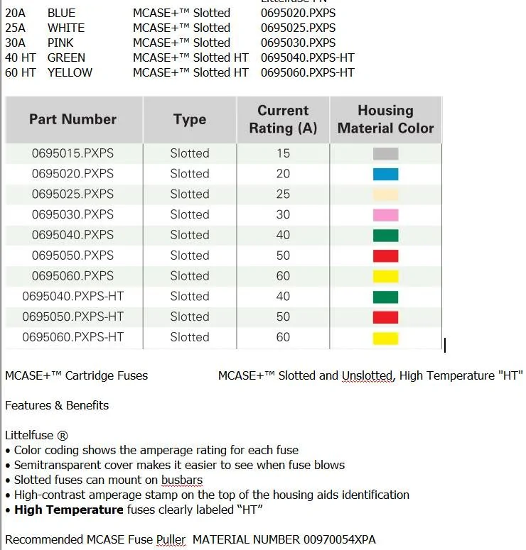

As far as I can tell there is no kit for the Maverick. There will be no best kit to buy since there are 6 different types of fuses and 22 fuses based on amps. One is marked as a circuit breaker so I don't think you will need a spare for that. As far as I can tell all the 'M Case' fuses are the slotted type but the higher amp ones are marked HT and I can't find what that means. There are 2 'J Case' fuses but I don't know if they are the normal or short variety. When you're counting fuses the Micro3 fuses take up 2 slots but it's one fuse. You don't say what model of truck you have but if you have an XL there will be a number installed fuses that you can consider spares for things that are not installed such as a moonroof, heated mirrors, heated seats, heated wipers, power rear window, etc. Hope this helps and good luck.

2025 probably has some fuses that are the same, probably some difference too.
My 2023 Maverick has: Micro2, Micro3, Low Profile JCASE, MCASE+ Slotted fuses, and a 30 MAXI CB.
Low Profile JCASE
Littelfuse 0895040.Z 895 Square Car Fuse 40A Low Profile JCASE Cartridge Fuses Rated 58V
Littelfuse 0895060.Z 895 Square Car Fuse 60A Low Profile JCASE Cartridge Fuses Rated 58V
MCASE+ Slotted
Ford Maverick Fuses Maverick BJB - Littelfuse MCASE+ Fuses

Excellent work. Thank you so much for your help and Happy New Year.
