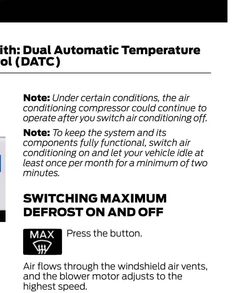

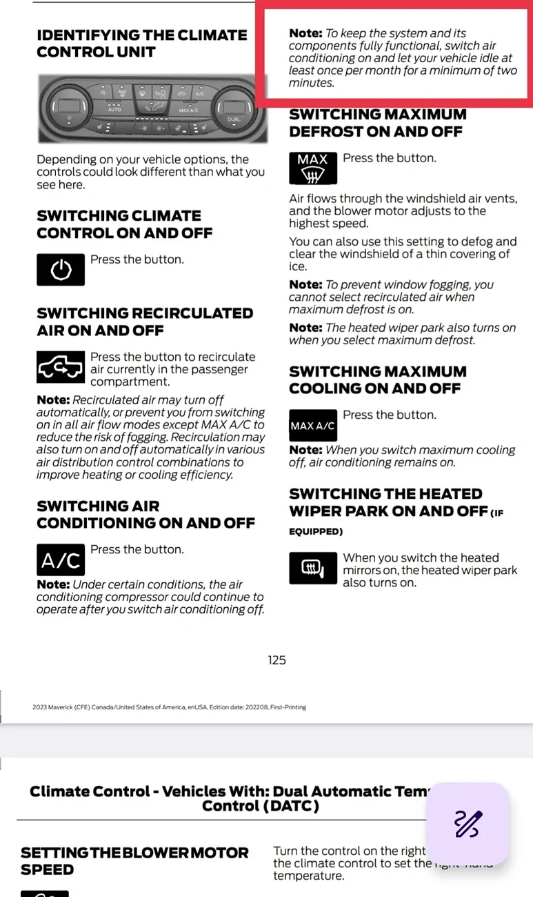

Heard it is advisable to run A/C in winter once a week for lubrication, necessary or not anymore on newer vehicles?
Page 125 in my 2023 owners manual.
Not one word is mentioned about storage.

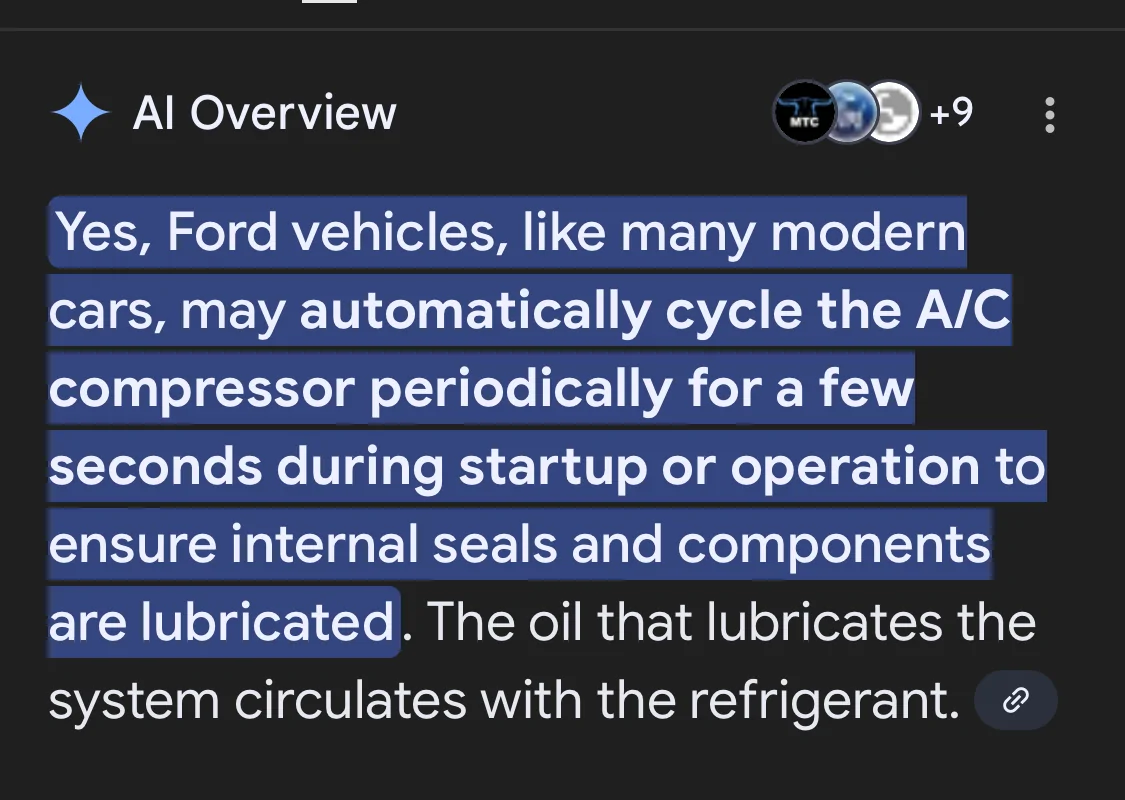

It can be so short, you wont notice it.
But it gets the job done.
If it's not 2 mins all at once, it's not getting the job done. You can do what you wish, it's straight out of the manual though.

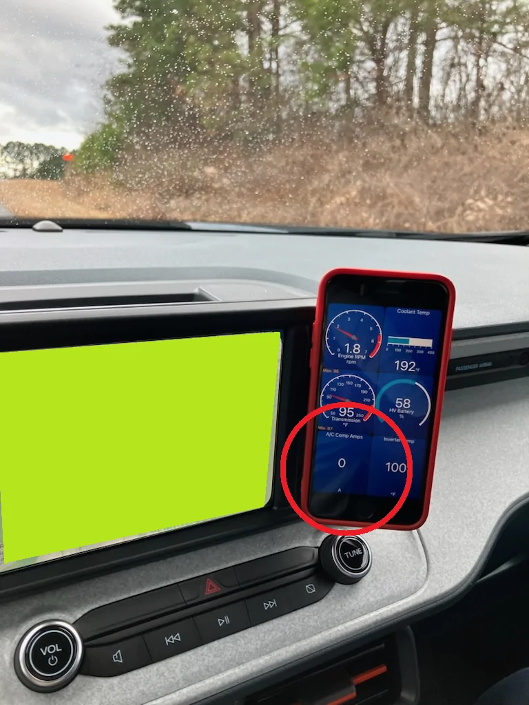

I watch this and when it comes on it turns green. It doesn't turn on hardly ever in the winter for me. And no, it's not broken. It works fine.
In the summer, yes it will turn on even with a/c button selected off to reduce the moisture buildup inside.
