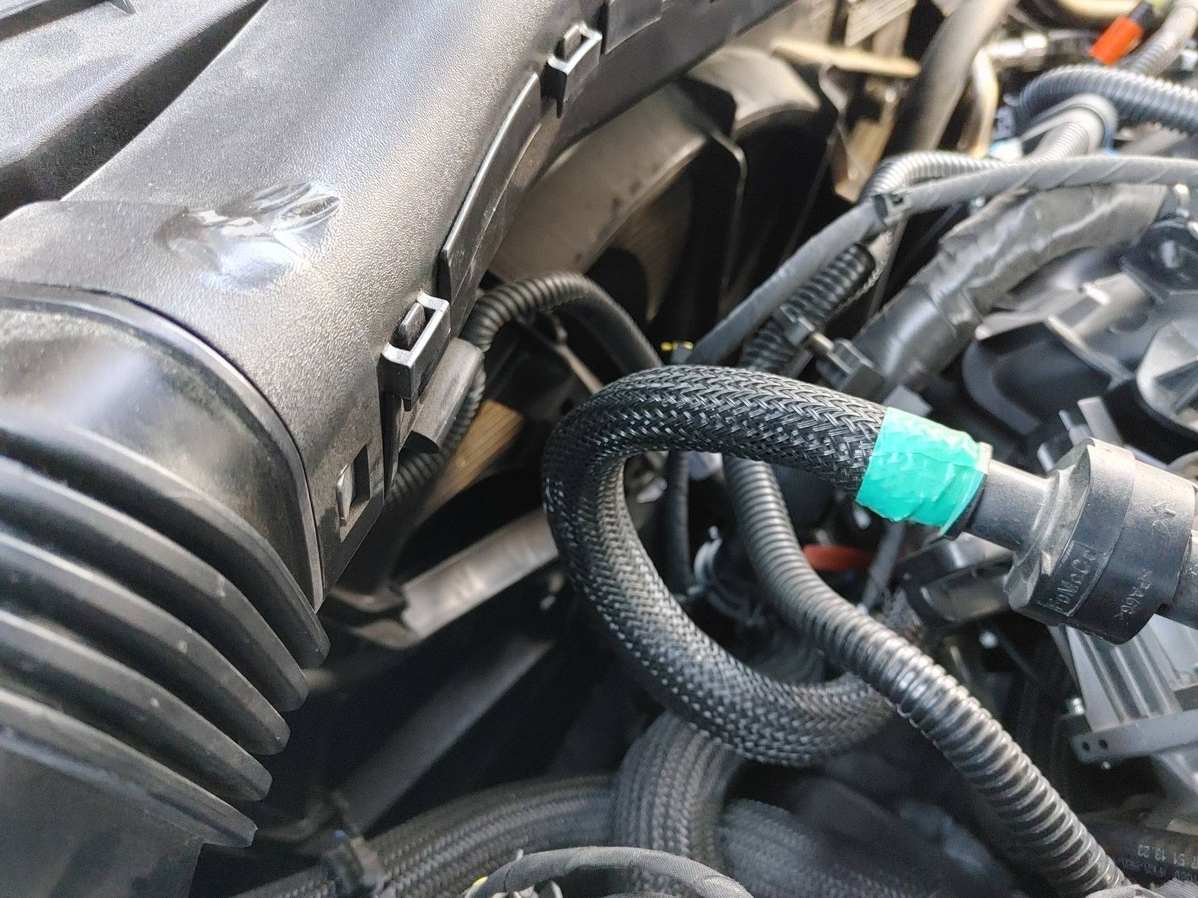

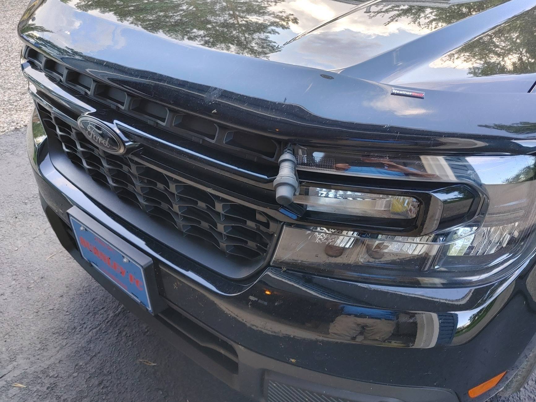

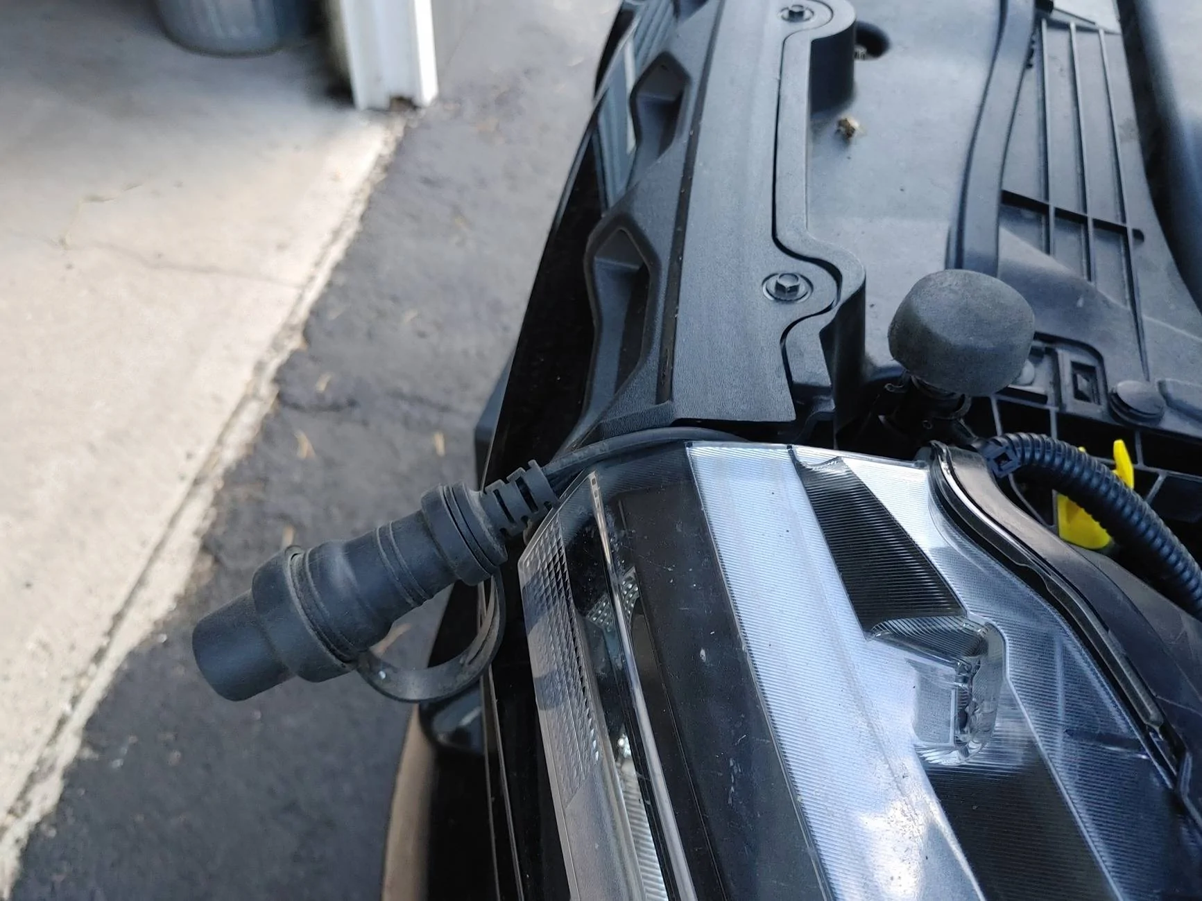

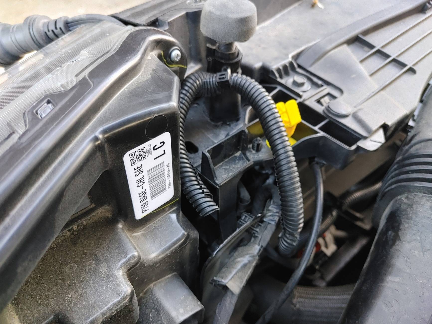

I have read quite a few posts on how to route the plug in cable for us cold weather drivers. This is what I did, I used three of the four original cable clips just in different locations, the last one being secured a on the hood stop post(see photo). After removing about four inches of the plastic cable wrap I found the plug in cord to be flat, I simply routed that between the headlight and the grill. This is almost identical to my Escape, it may not be the prettiest but it works and easy.
