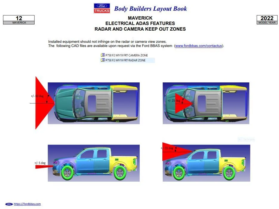

Found Ford has recently published Body builders layout book for Maverick. Thought I would share as it has some handy data and specs. These guides are published for vehicle up-fitting for fleet and commercial vehicles. Attached and can be found at https://fordbbas.com/home.
Ford Maverick 📒 Body Builders Layout Guide for 2022 Ford Maverick: Tech Specs, Weights, Dimensions, Measurements, Radar/Camera, Wheels/Tires Data BBG

The GVW front to back 2300/1400 lbs is what gives the FWD great snow traction in front wheel drive only! And I knew this would be the case. Very happy to see confirmation of double the weight over the front wheels :cool:

Good to know! Wanted to make sure a windshield brow tint wouldn't mess with the camera and this clears it up!

Yikes...if I understand this correctly the total weight for pulling a trailer is a little over 800 lbs for the Hybrid. GVWR is 5200 and the GCWR is slightly over 6000. My understanding that to calculate the rating for hauling a trailer is subtracting GVWR from GCWR. Have I miscualculated this or do I have this wrong?

GCWR - Curb Weight - Payload (passengers, cargo, etc) = margin for towing

Does anyone have any contacts that might have a ford body builder account? It would be really helpful for my canopy/ladder rack build to have those CAD files.
