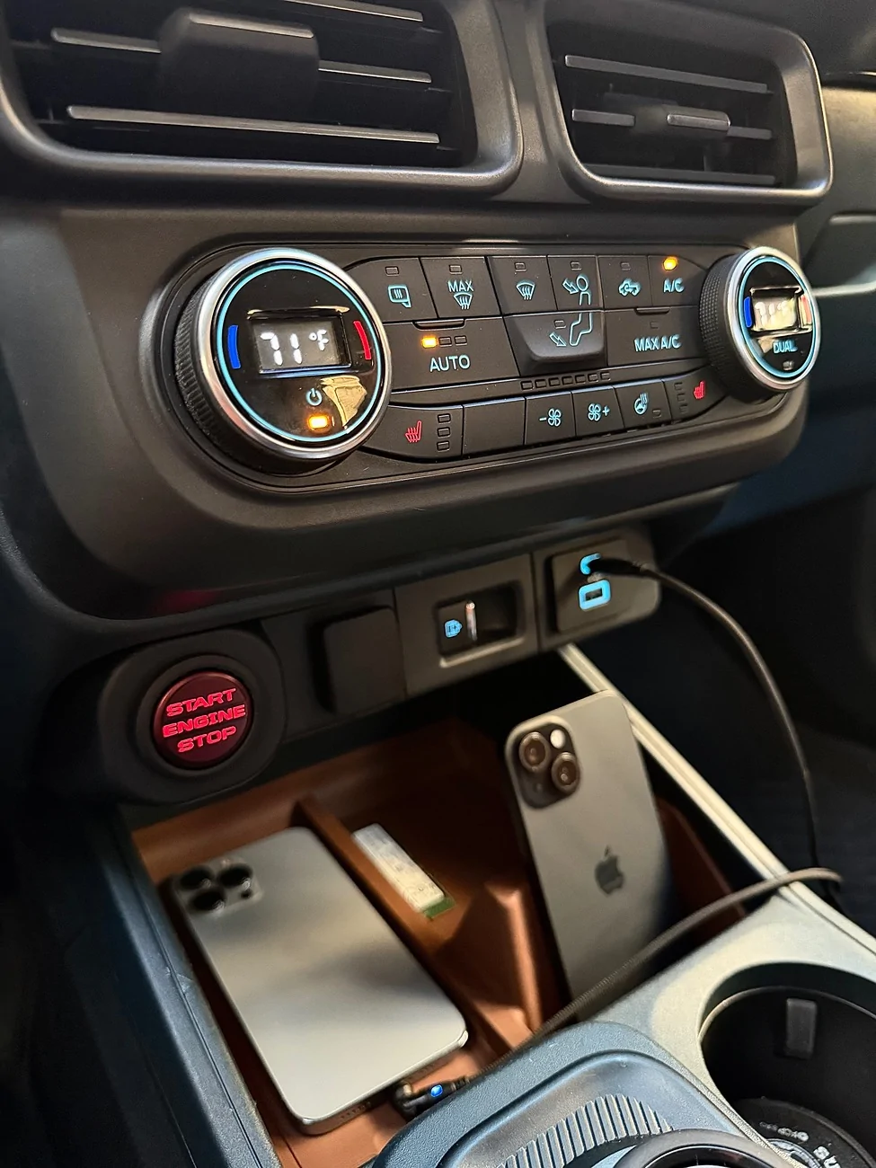

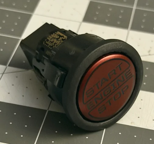

While sitting in a Ford Mustang I noticed they have a Red Start Stop button and I wanted it :devil:
After some Ebay picture searching, I noticed the connection is the same, so I ordered one.
Fair Caution without any modifications the Mustang Button does not fit flush but after some cutting and creating a spacer to 3d print I got it fitting flush like factory.
Ford Maverick MOD: Red Mustang GT Start Stop Button installed IMG_5647

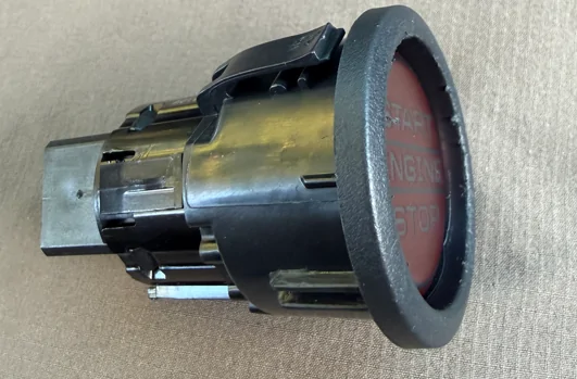

here is how it fits without any modifications
Ford Maverick MOD: Red Mustang GT Start Stop Button installed 1778966102306-gk

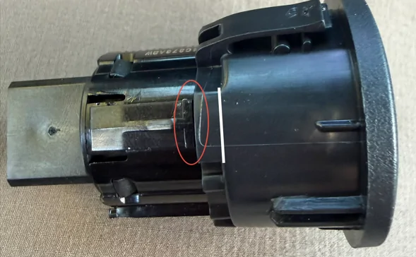

White Line is how much i had to trim to get it flush
Ford Maverick MOD: Red Mustang GT Start Stop Button installed 1778966200724-0j

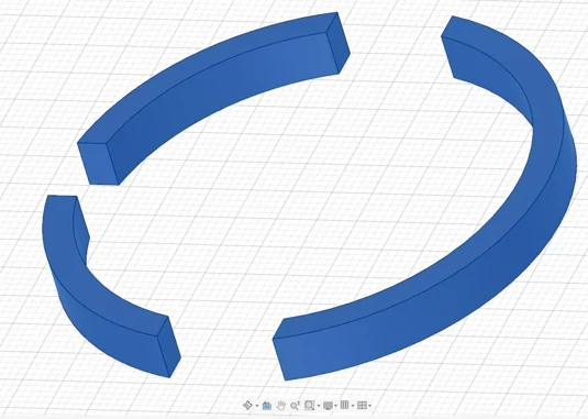

After trimming I 3d printed a spacer to take up the gap so it clipped in flush
Ford Maverick MOD: Red Mustang GT Start Stop Button installed 1778966338552-ba
All done
Ford Maverick MOD: Red Mustang GT Start Stop Button installed 1778966392037-40

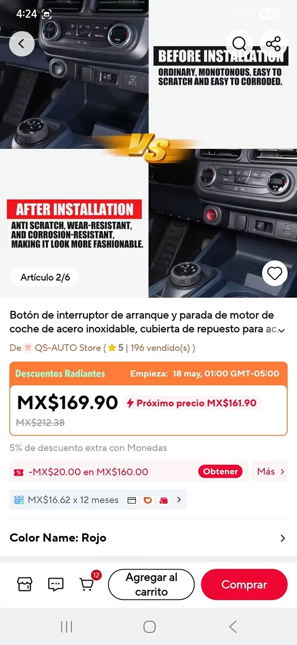

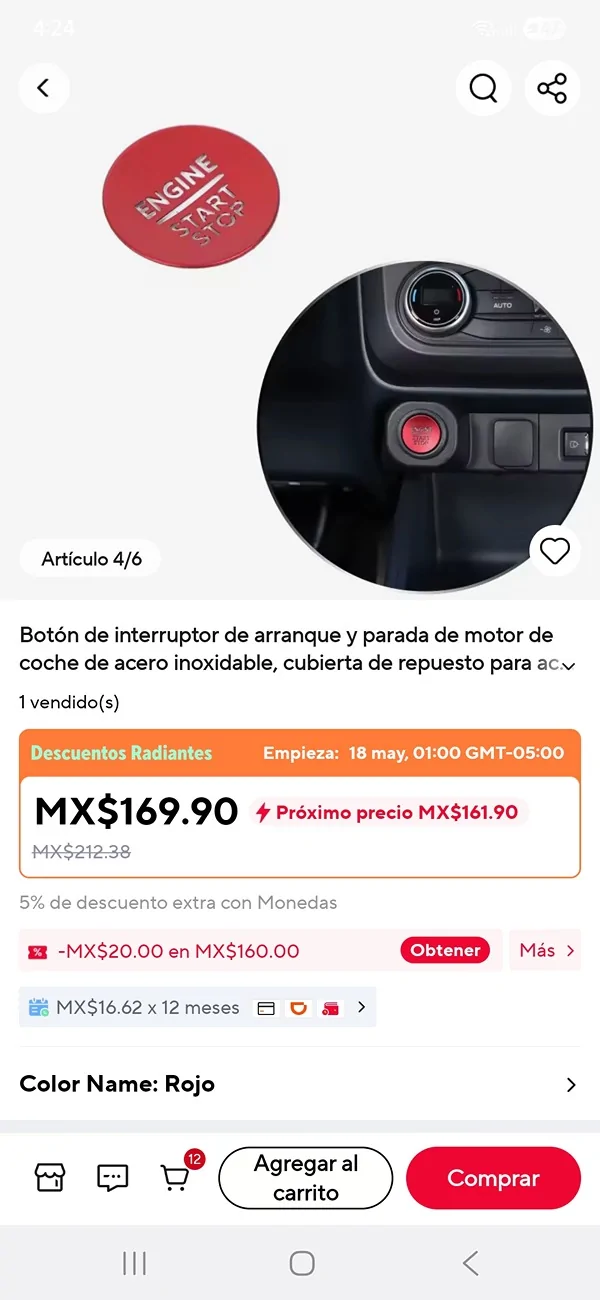

Oh boy!
I did think you got just the "skin" cover!
Ford Maverick MOD: Red Mustang GT Start Stop Button installed Screenshot_20260516_162417_AliExpress
Ford Maverick MOD: Red Mustang GT Start Stop Button installed Screenshot_20260516_162404_AliExpress
