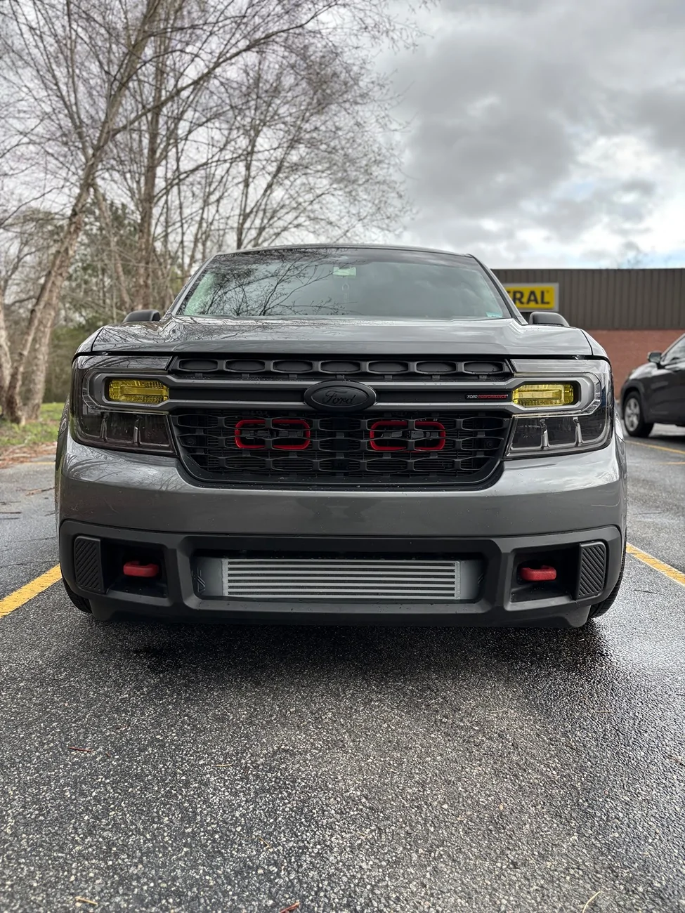

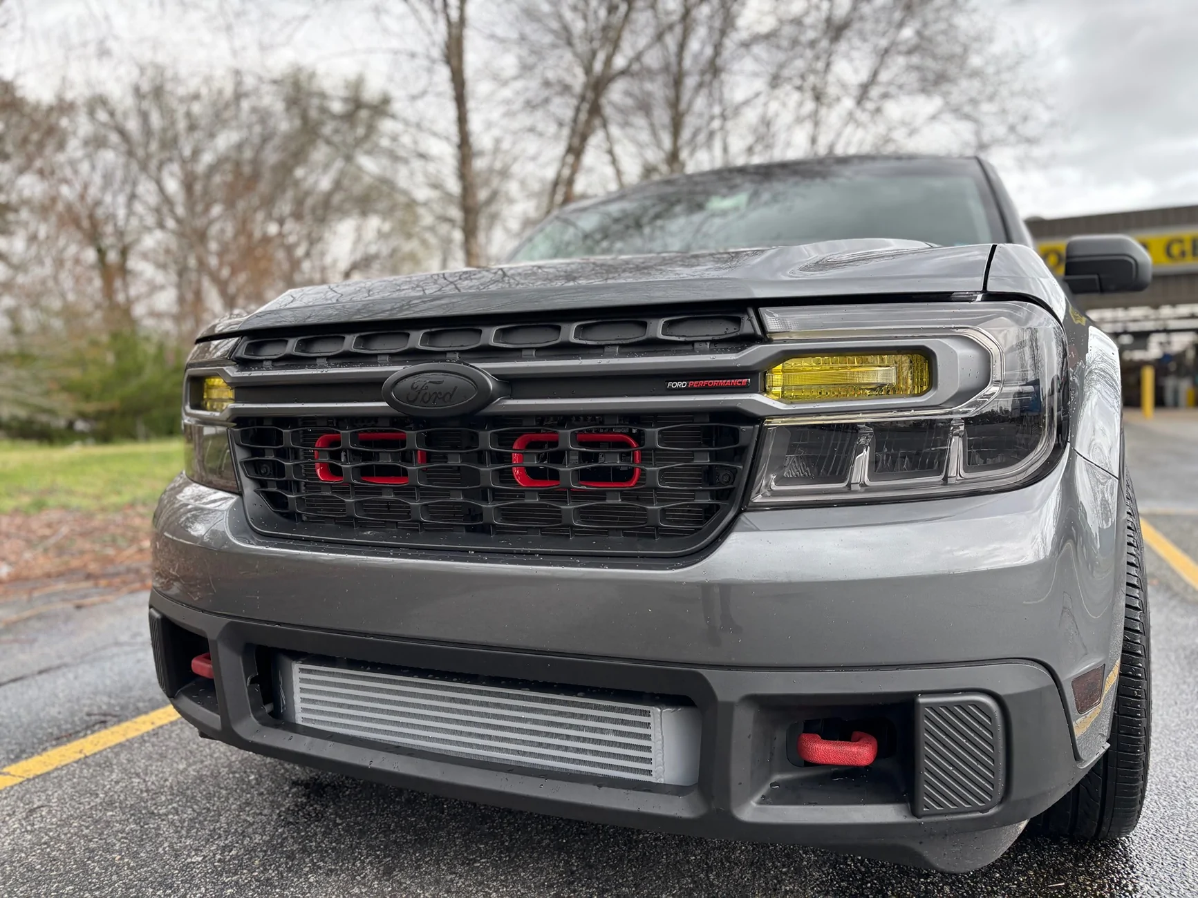

BADMAV HAS HAD A BUSY MONTH! Velossa tech big mouth, CVF downpipe and intercooler installed!
Ford Maverick BADMAV Maverick build gets new performance upgrade parts! Velossa tech big mouth, CVF downpipe and intercooler IMG_4799
Ford Maverick BADMAV Maverick build gets new performance upgrade parts! Velossa tech big mouth, CVF downpipe and intercooler IMG_4798

@LemonHead is that still the AFE Rebel exhaust? Did you run that exhaust before the downpipe? How did it sound then?

Yes still aFe rebel. Same type of tone but turn it down a few notches. The CVF downpipe and removal of secondary cat really opened it up

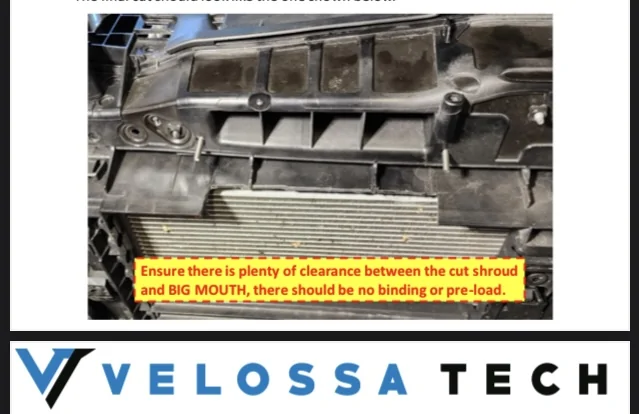

The Big Mouth intakes look very nice but:
1) Did you have to permanently remove all the adjustable radiator slats? Will the truck take longer to heat up in cold weather?
2) Have you noticed any over heating in the Summer with so much of the radiator covered up the the Big Mouths?

So ALMOST all slats need to be removed. I opted to remove all instead of leaving two on each bottom side.
It does take a little longer to warm up in bellow freezing temps but nothing too crazy.
No overheating noted. Don’t think I’ve seen temps over 185 since install. Granted it’s only been a month and the hottest day so far has been 85. But I know guys in hot states with them and no issues

I’m thinking about cutting the trim below the OEM mouth (per the instructions) to let more air flow into the OEM mouth.
BTW, how did you hold the hood up while the prop rod was removed?

I have hood struts installed

to the op: what temps are you seeing post intercooler upgrade? Sorry if I missed it!
I’m not the OP, but I’m curious also because I plan to get the Ford Performance Garage intercooler for my Lobo.
AI tells me to expect a 20 to 25 degree Fahrenheit reduction in incoming air temperature to throttle body versus the OEM intercooler…nice:)
