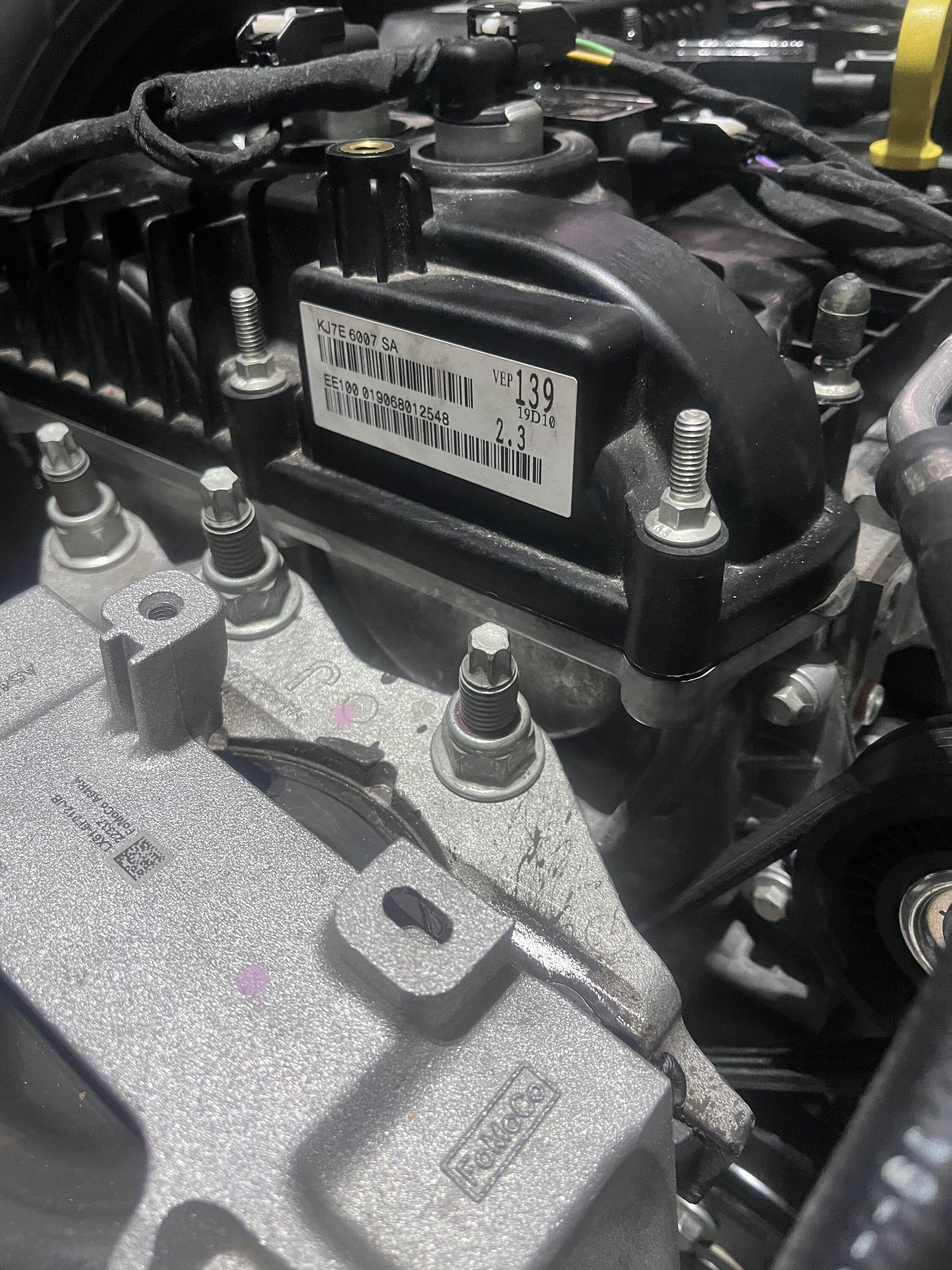

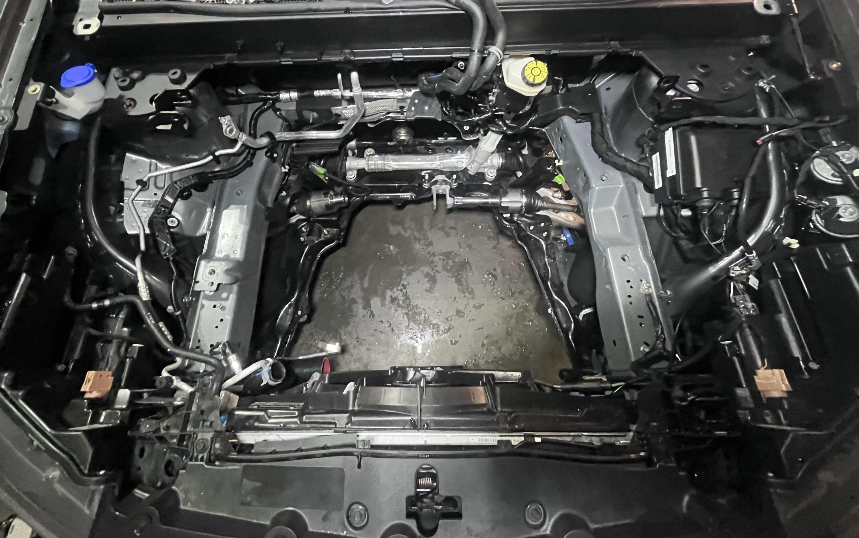

By now I had several parts in the works and more in the pipeline. I started looking for a used 2.0 to use for mock up and stumbled across a few 2020 Corsair 2.3 long blocks for not much more. I found one with 10k miles for $3700 that said “Make Offer” so low balled them at $2500 knowing they’d decline. Boy was I wrong! The accepted and I had a 2.3 on the way for $2700 shipped.
Fast forward a few weeks and I’ve added Eibach springs, dual catch cans, and the first version of my Intercooler upgrade. I’m also waiting for the first CTR57 Turbo from Comp. As time passed I kept getting more and more anxious. The axles and transfer case are off, as is the driveshaft and exhaust.
The more I looked and tried to resist, I couldn’t shake the thought that the engine was a handful of bolts from being ready to pull. So I pulled out a perfect 3000 mile engine out of a 3 month old 2023.
From there it snowballed to where I am today. A 2023 with 5,000 miles on the chasis and 12,000 miles on the engine. As far as I know this is the only 2.3 Maverick around. Current mods are:

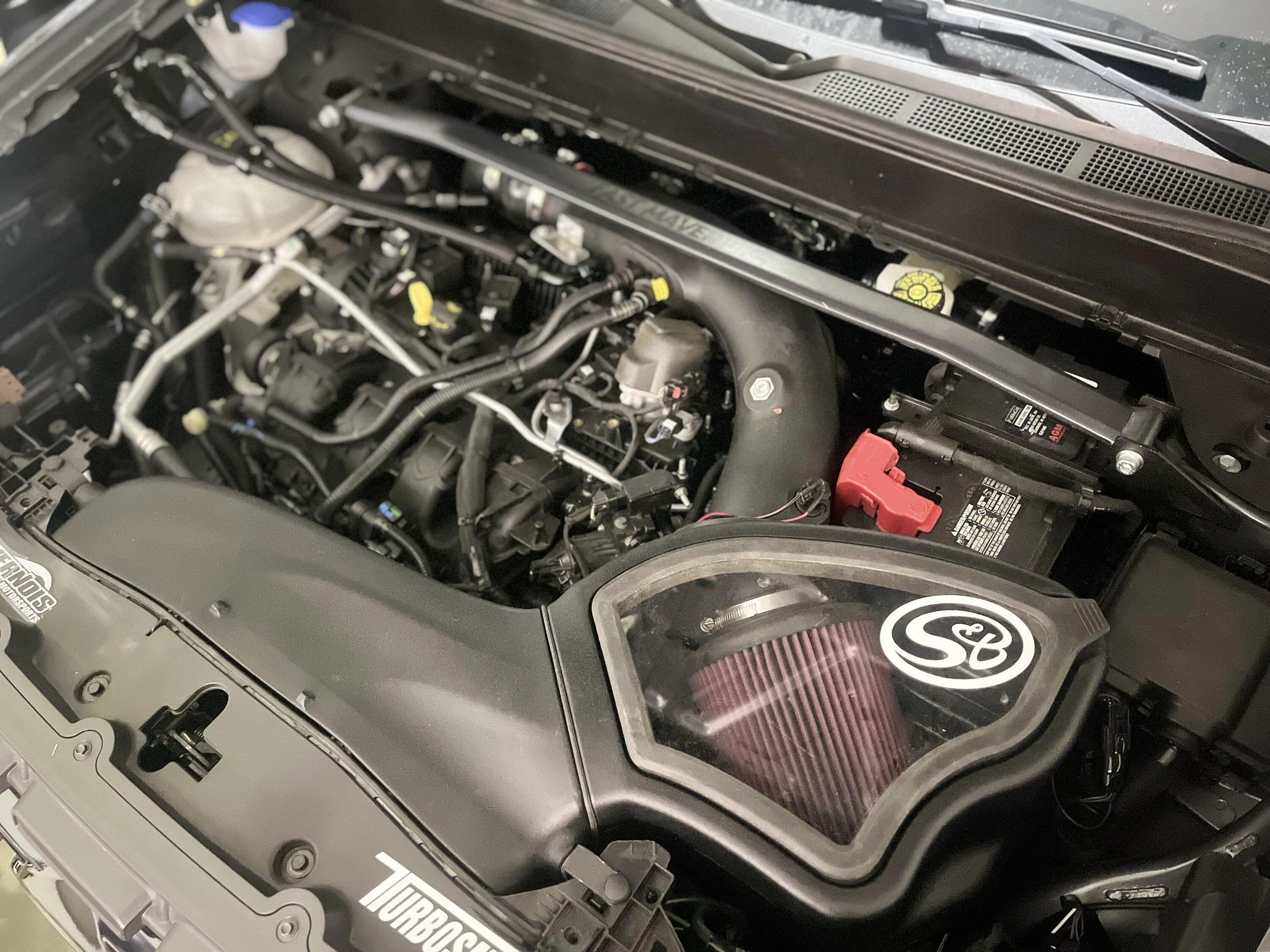

2.3 Engine

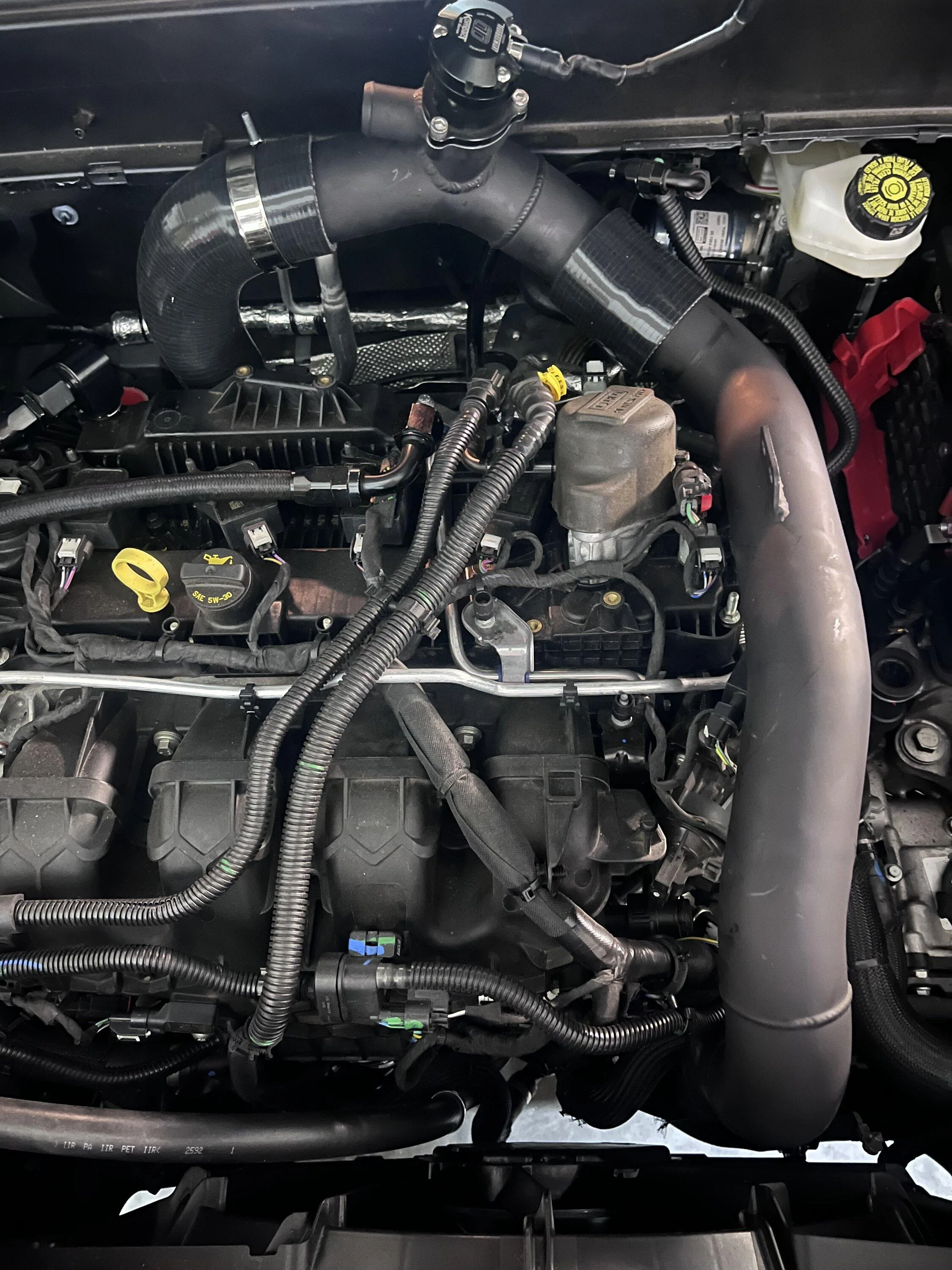

CTR57 Turbo
3 inch 304 SS downpipe
3 inch Electric Cutout with 3 inch pipe to stock catback. This is the best of both works because it’s quiet when I leave home early and loud at the flip of a switch.
FM intercooler upgrade and aluminum hardpipes with Turbosmart blow off valve.
S&B Intake with Velossa Tech Dual intakes.
Has a custom front strut brace which I will be building with 3 mounting points.

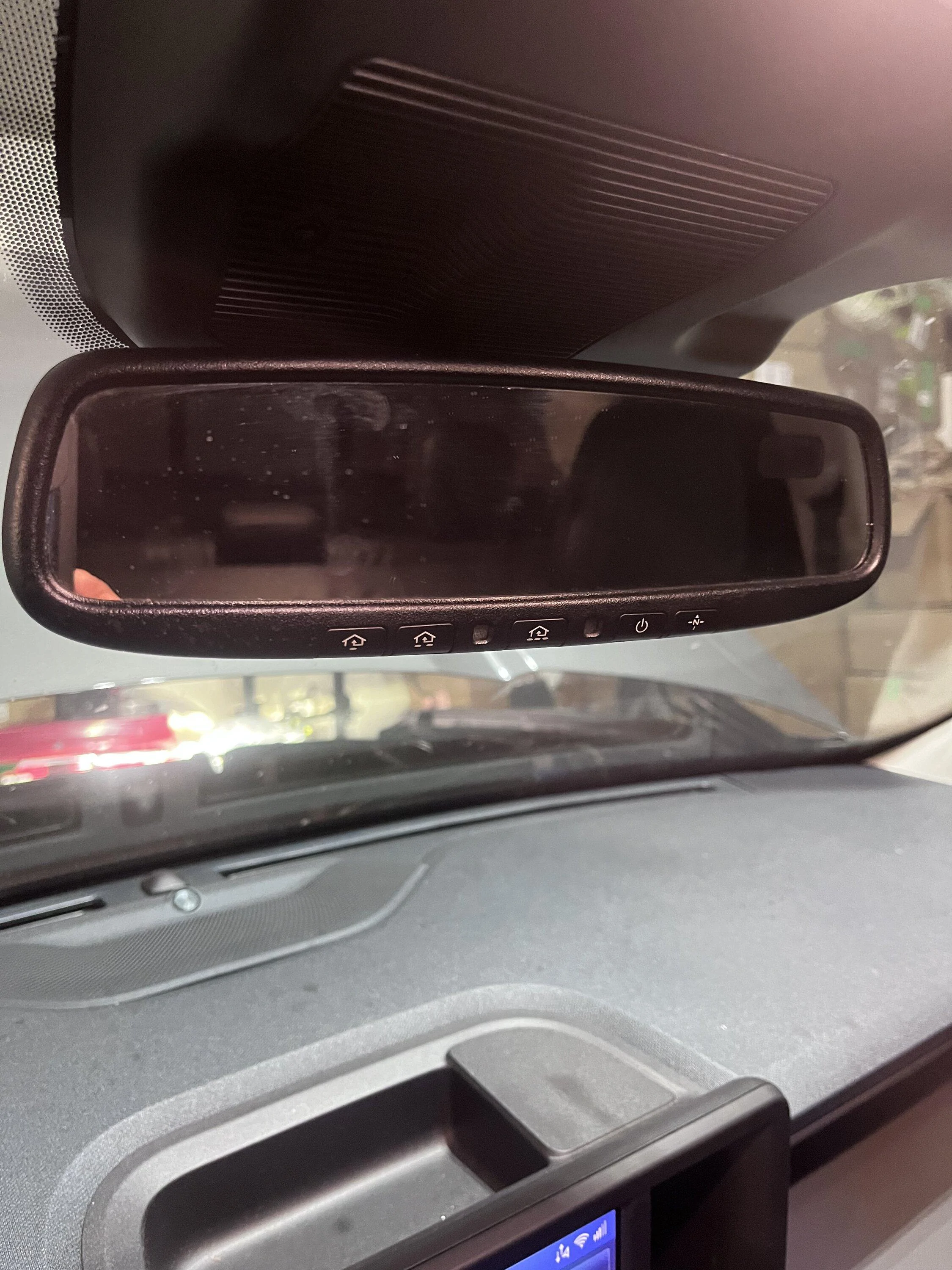

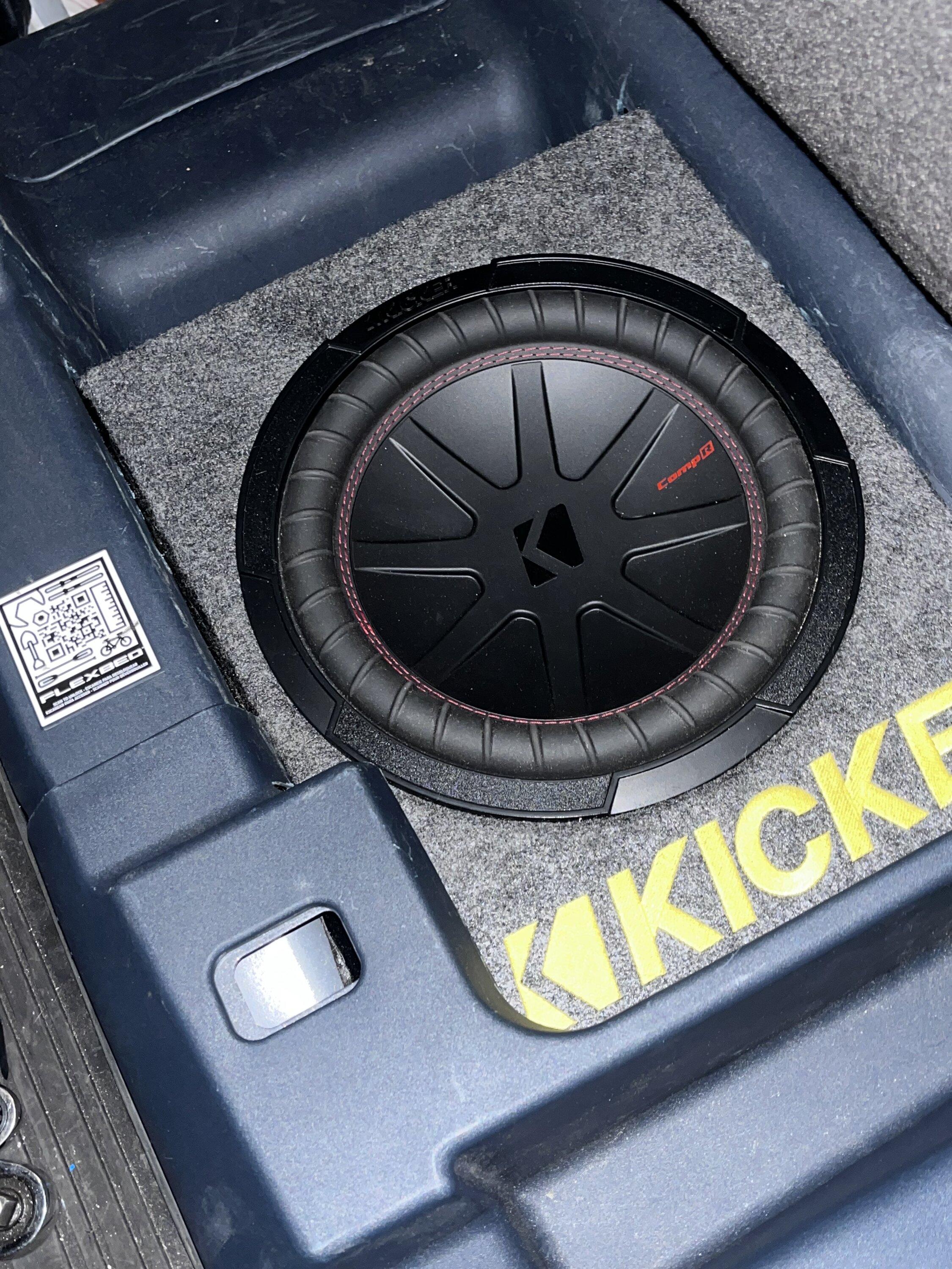

Interior has an Escape Digital cluster, Gentex 453 homelink mirror and I just replaced the B&O sub with a 10 inch Kicker sub in a custom box I made and Kicker Amp. Also waiting on a heated, leather, flat bottom with grey stitching steering wheel from a Euro Focus.

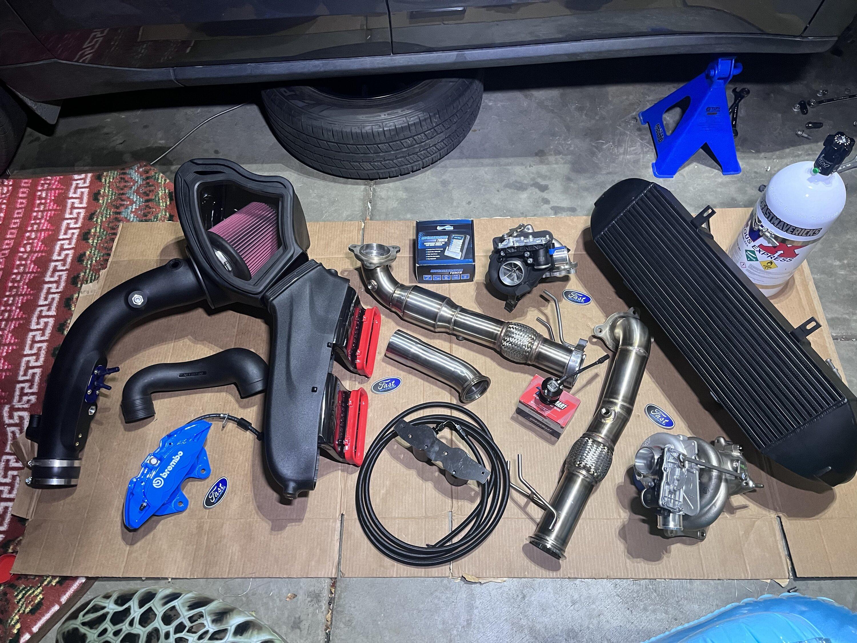

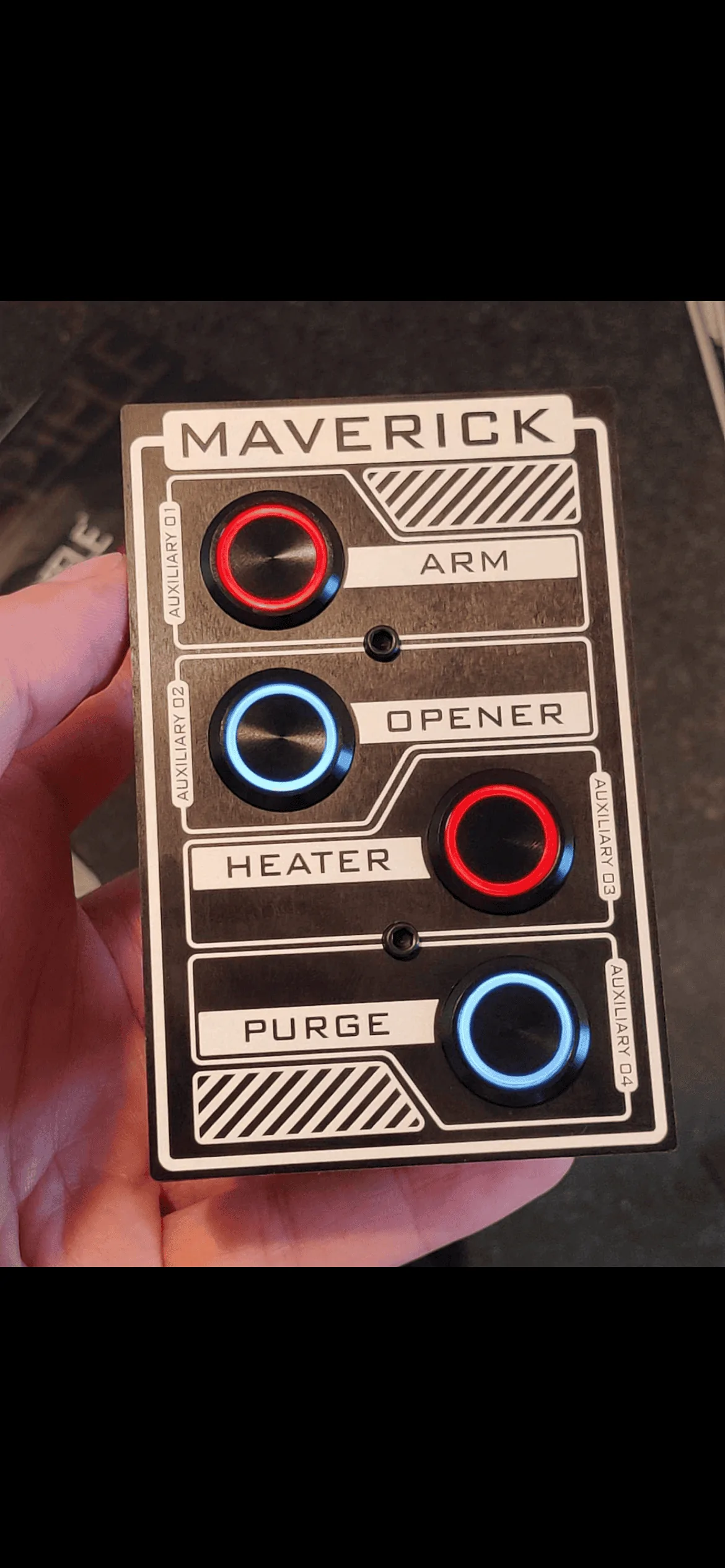

I’m working on a front brake kit that uses Focus RS Brembos. As an added bonus I’ll be installing a Nitrous Express kit and maybe give it a small 35-50 shot, you know “For Science”

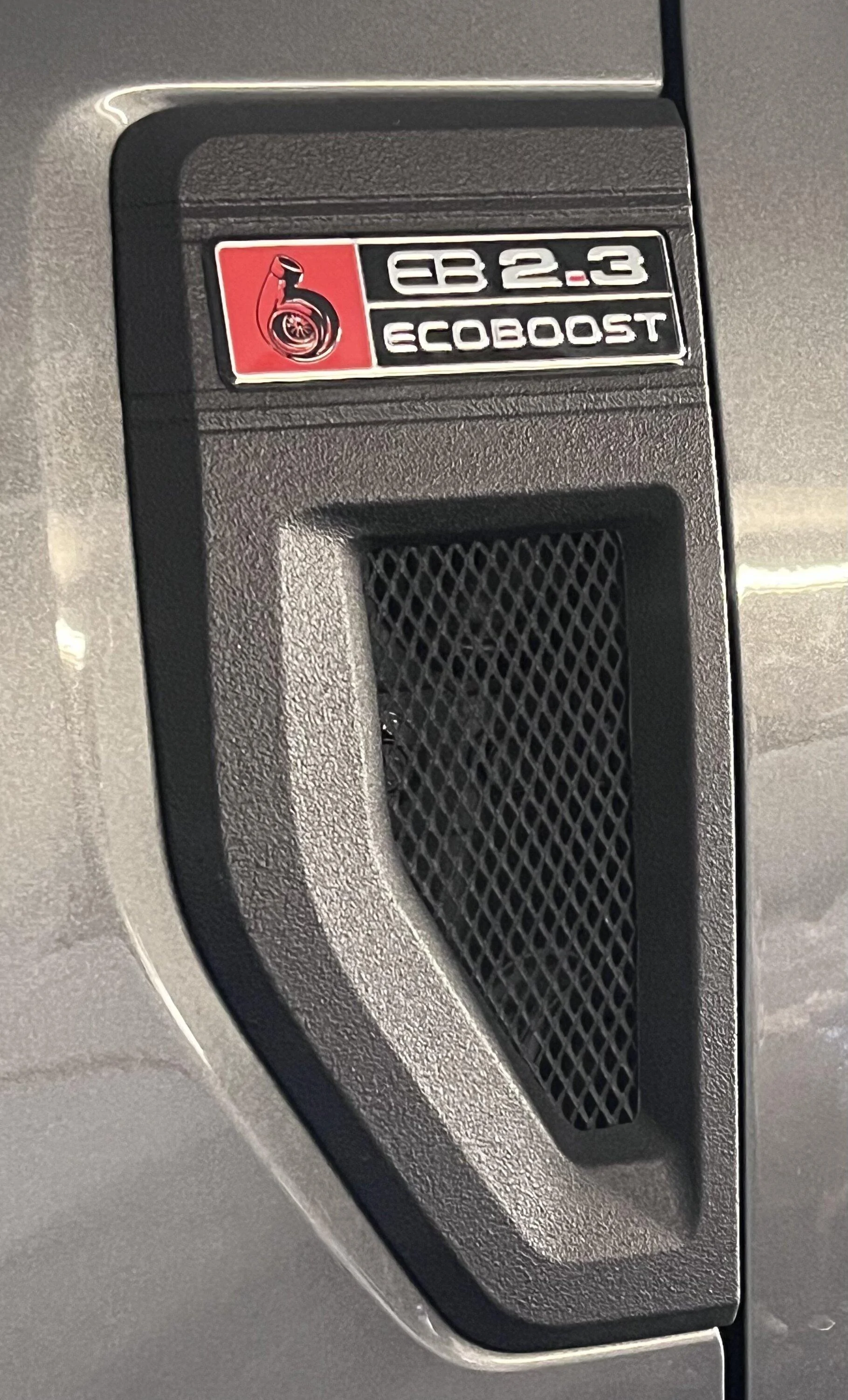

My most recent mod and one that triggered the masses is a 2.3 Ecoboost fender emblem. 😄

I test everything I sell on my truck before I sell them. How can I offer support if I haven’t gone through it? It’s like a priest giving marriage advice when he’s never been with a woman lol.
Im happy to say that we’re nearing the point where parts will start rolling in and in no time Mavericks will be terrorizing the streets. Until then I won’t stop because we’re just scratching the surface. The aftermarket is catching up and soon all the big fish will have pages of maverick parts and I’ll be an afterthought. But I’m perfectly fine with that because i know that our small group of 2000 members led the charge and we will always be 5 steps ahead🔥

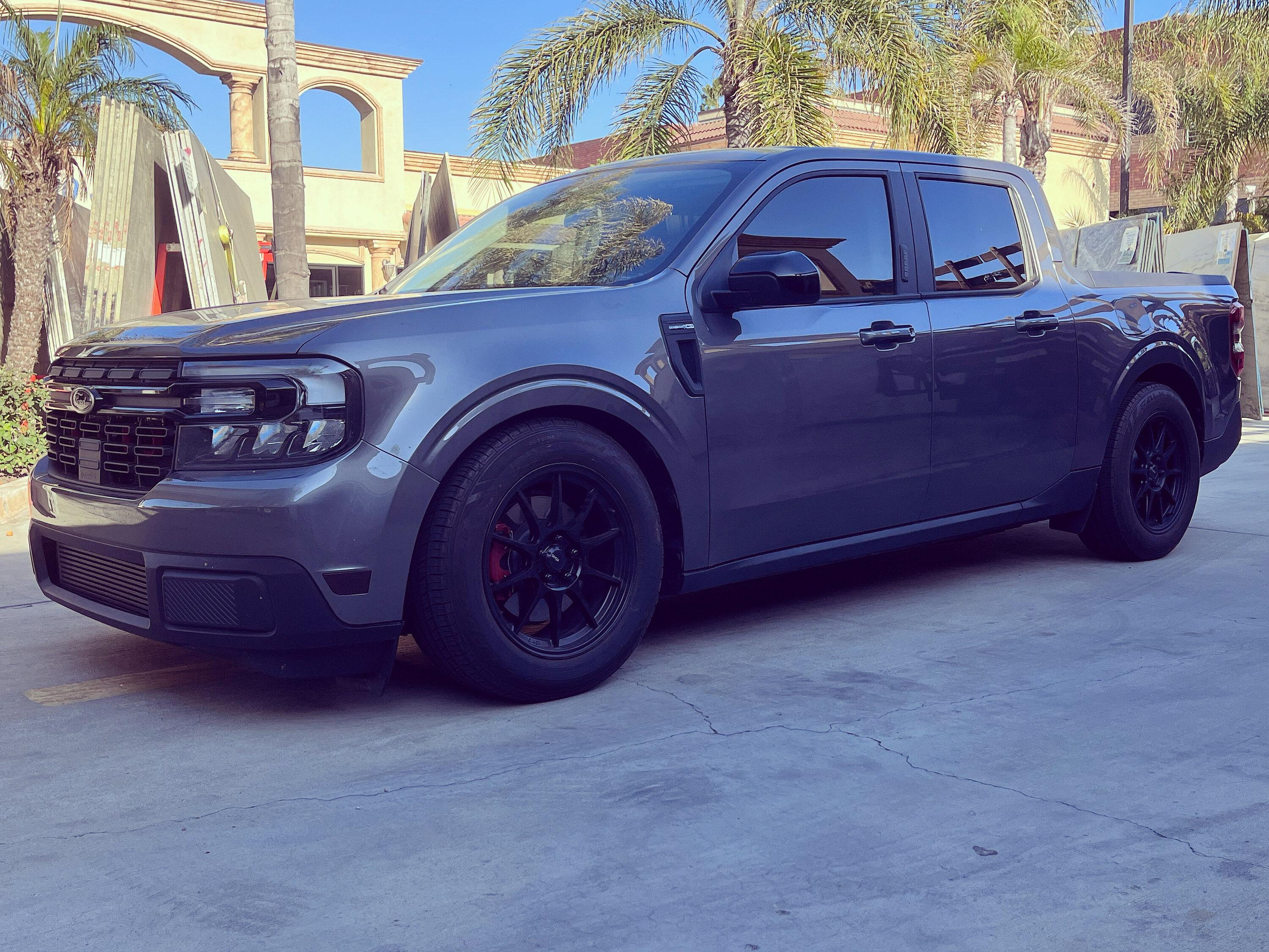

Enough of mys story and enjoy pictures of my “ST” 🤣

What you did is so cool and I am thinking eventually Ford might do the same thing. So is the 2.3 engine footprint the same size as the 2.0. I am not mechanically inclined myself but for someone who is, how hard is it to but a 2.3 in a Maverick. Does it take a lot of man hours?
Side by side they are identical and everything was plug and play. Just make sure it’s a 2.3 from a 2020+ Lincoln Corsair as they also made them with a 2.0. I did it all myself spread out over days so I didn’t track the time.
