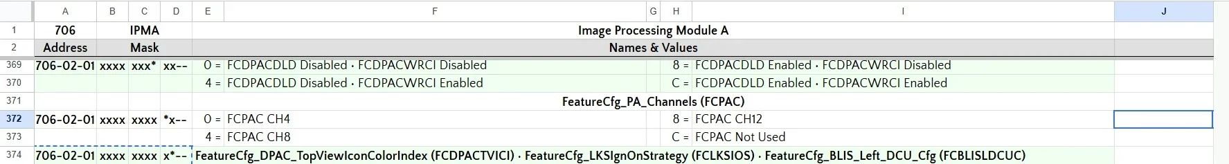

If there are specific areas which don't have the codes for the various options, how would I go about figuring out the options/codes?
for example, the bottom line of this screenshot..?
