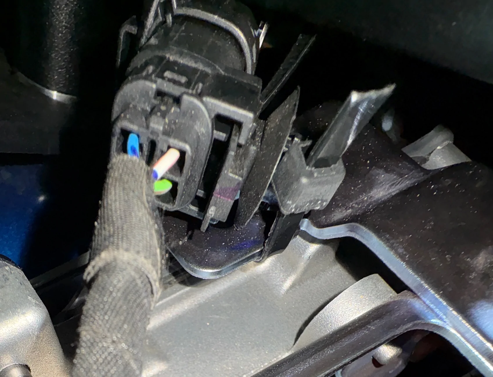

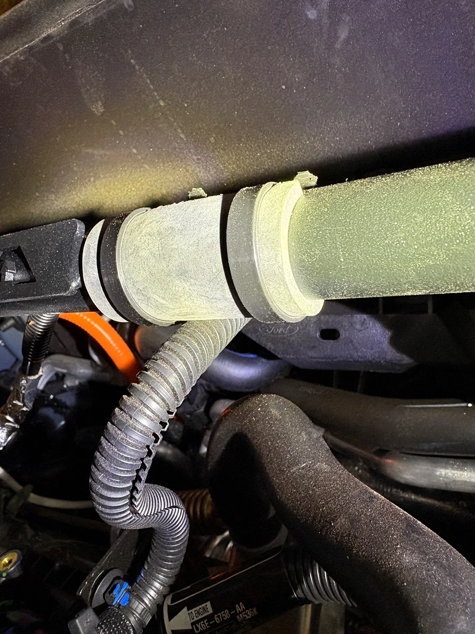

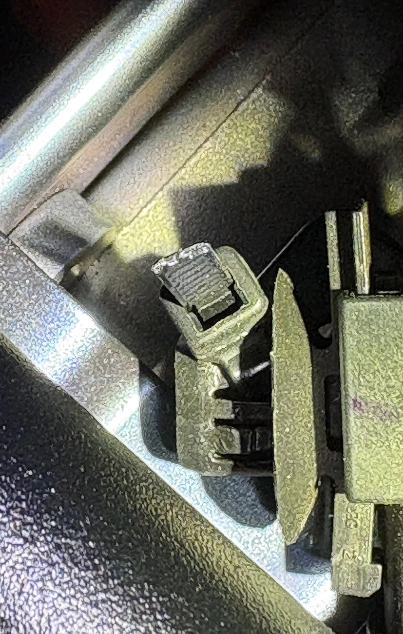

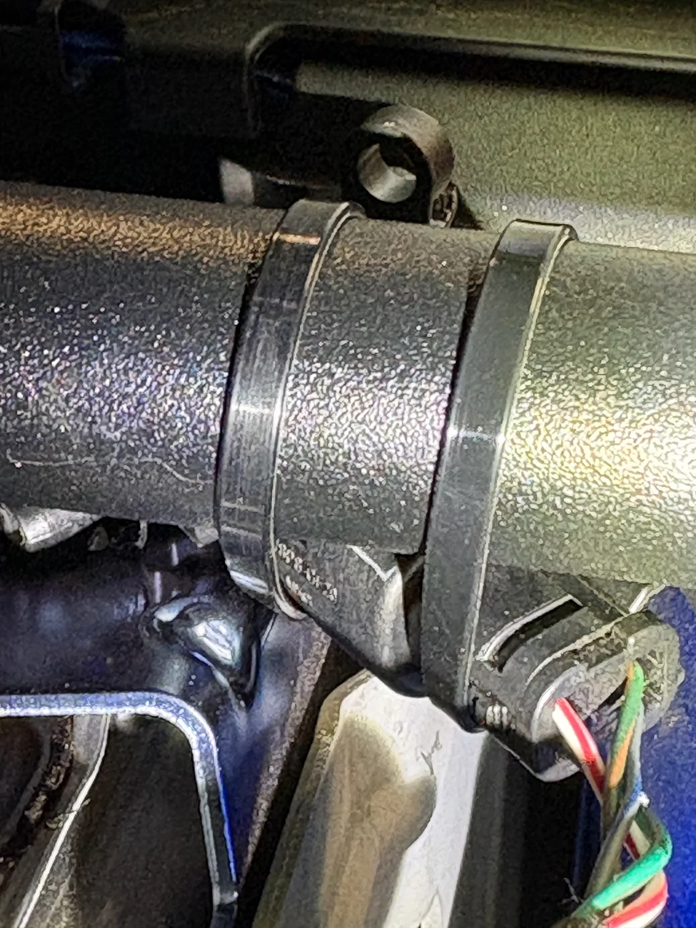

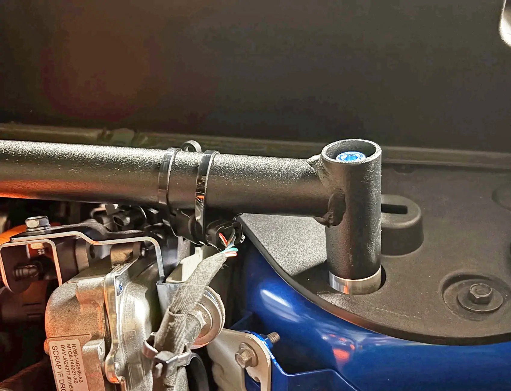

I just finished installing this with minimal instruction, so basically what is needed is a 6 mm hex socket, torque wrench (23 ft/lb) , 5 zip ties (came with 2), 1 inch rubber hose about 2 inches long. I split the hose lengthwise to wrap the bar.

Hmm, I installed mine today. I didn't use the pipe hose, just a little electrical tape. I also didn't feel any difference between before and after (whereas I did when I added a Ford Performance one to my Mustang convertible that had noticeable cowl flex).

It’s late and dinner/beer time so haven’t even driven mine yet. The instructions didn’t mention the line rubbing the pipe but the line will move as the engine vibrates so i wanted the rubber to take away the friction that might wear through the plastic line.
The reason i went with the Steeda is because a few weeks ago i was driving to the store behind a 22-24 Maverick 2wd that took a corner very quickly and the body roll was really excessive; it looked like the front strut was about to pull out of it’s tower lol :)
I still have to install the rear Steeda sway bar, so hopefully when i take that same corner i won’t feel like i'm going to roll it into the ditch.

I don't know about that. I tried that initially but the angle of attack was better going under:

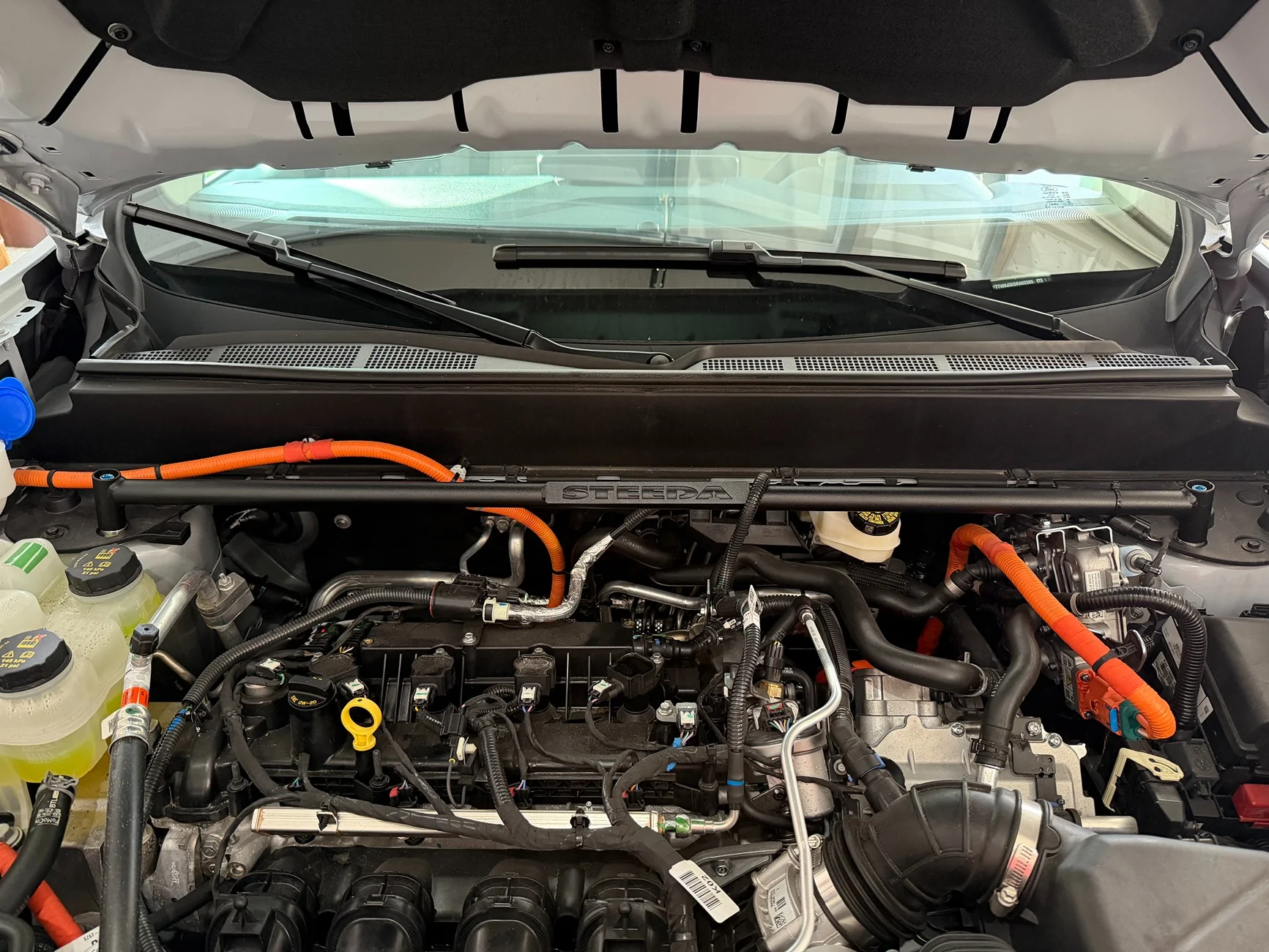

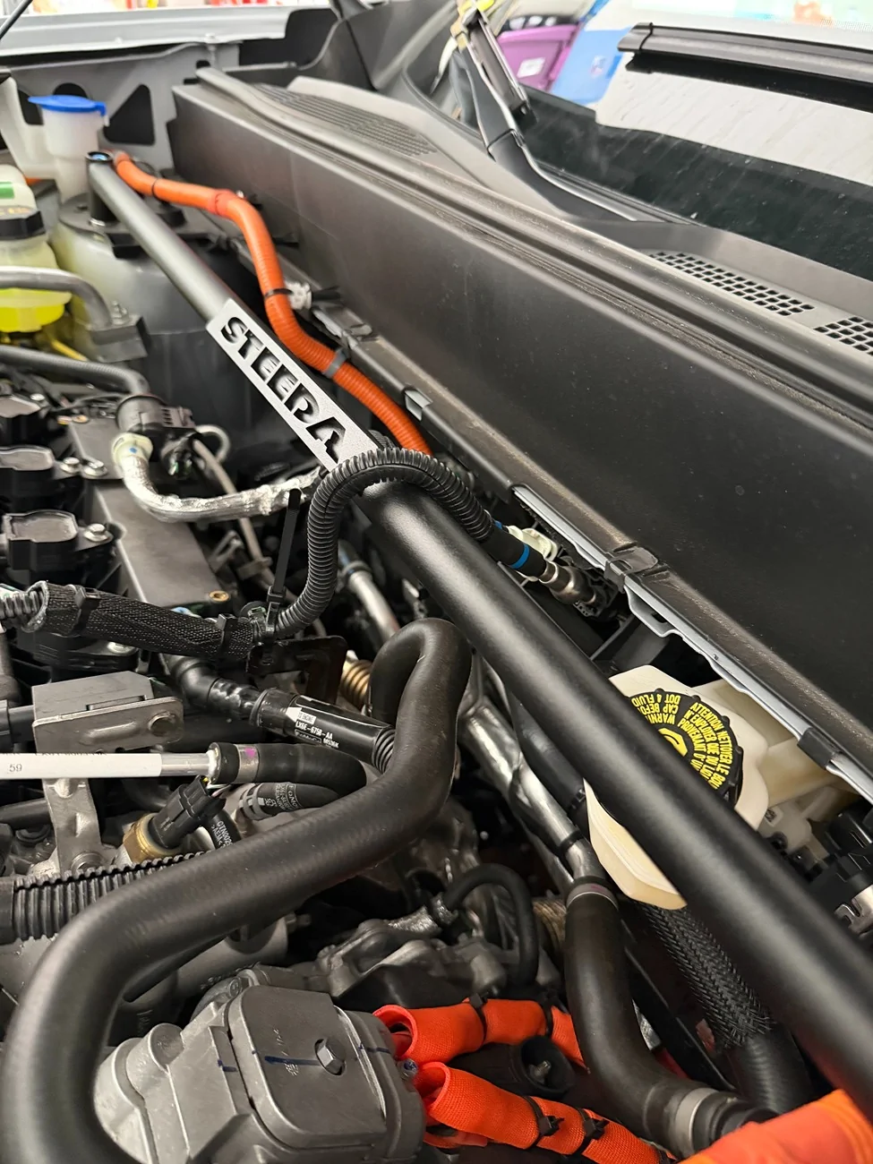

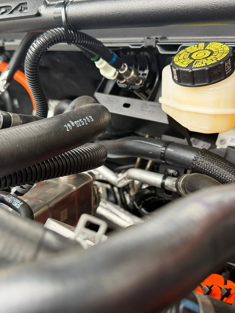

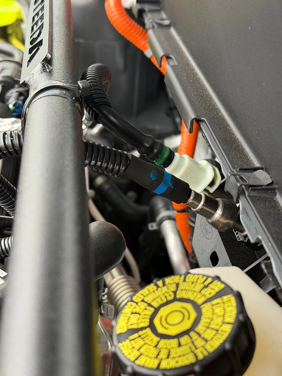

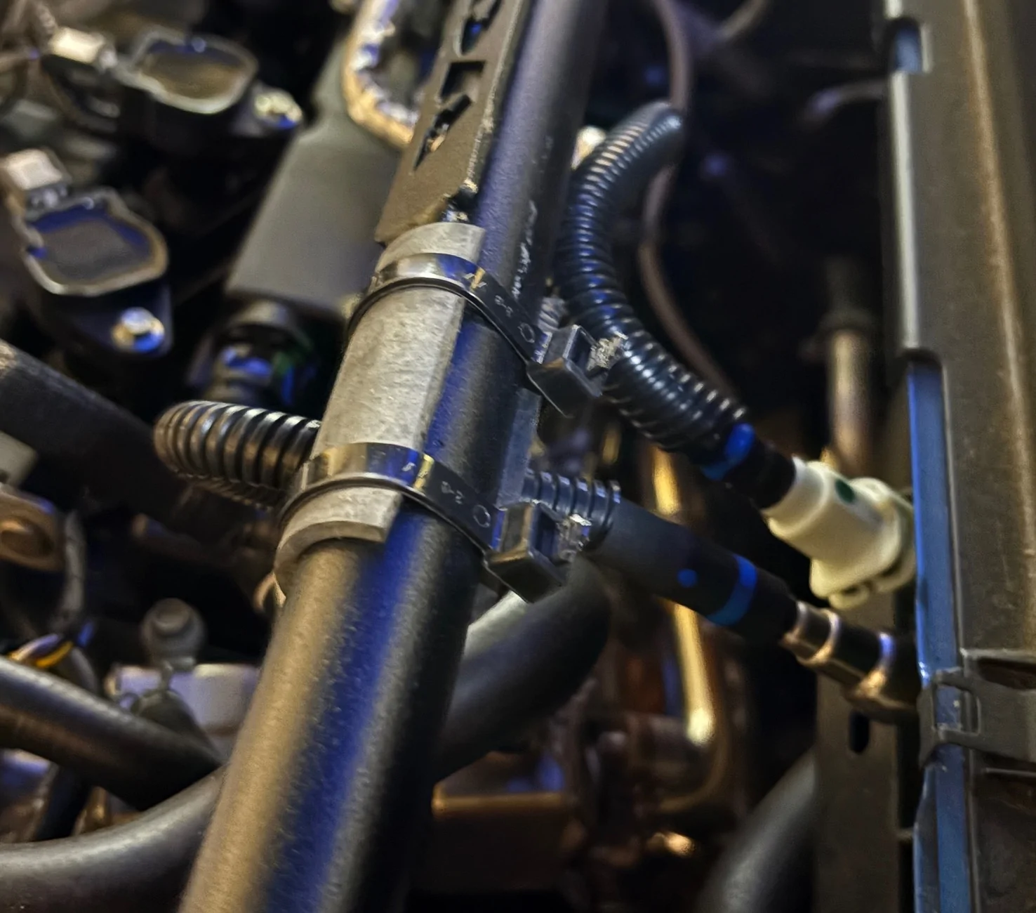

The fuel line is supposed to go over the bar. You’re putting a lot of downward pressure on that connection.
When i set the bar in there was less movement of the line going over it.
I have a hybrid so i assumed that was because the added mounting blocks that Steeda provides lifted it up about a half inch.
Ford Maverick Steeda Strut Tower Brace - Black (2020-2025) installed IMG_9131
Here is an old pic from someone else’s hybrid installation.

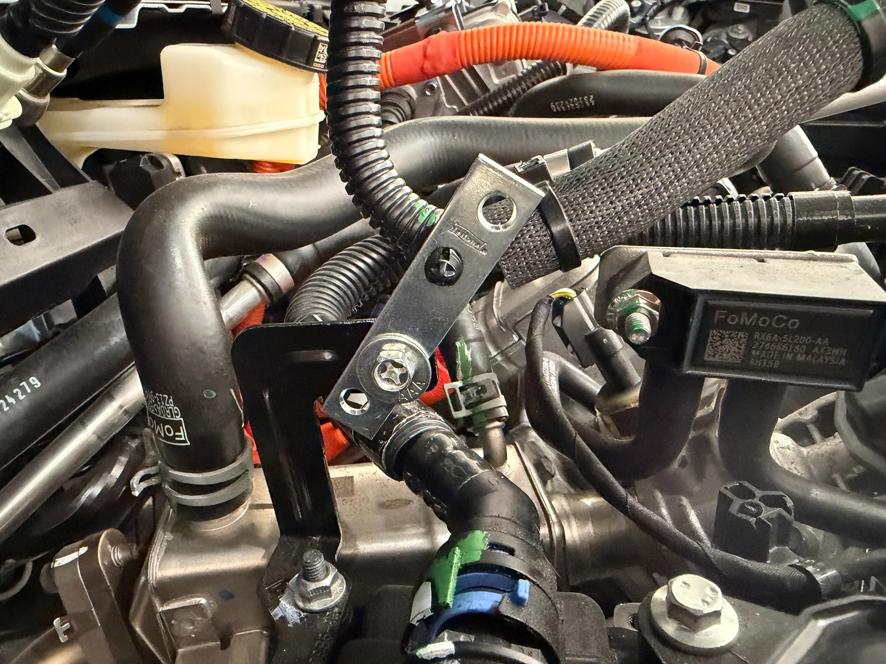

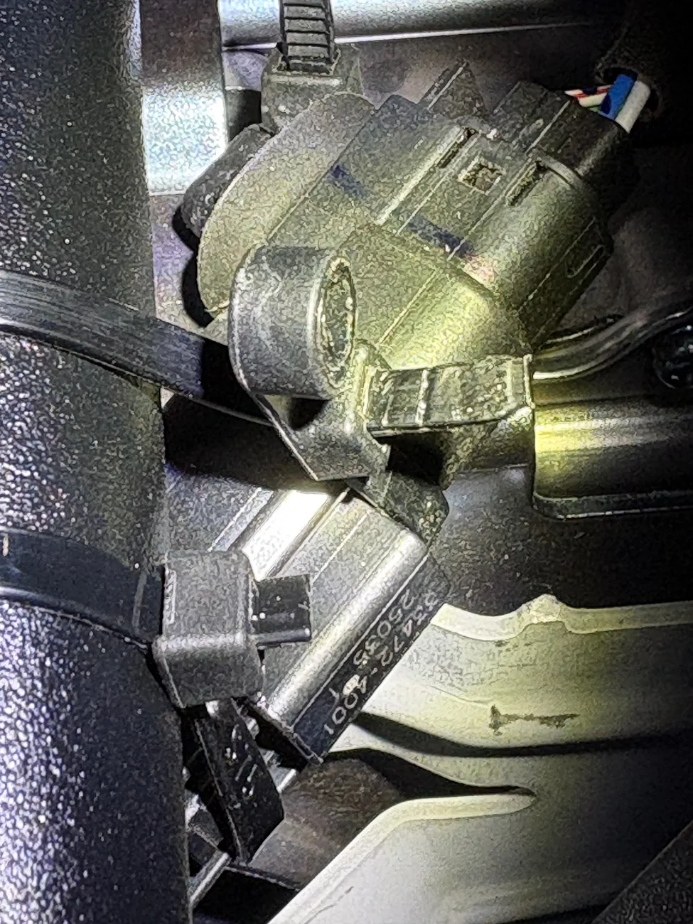

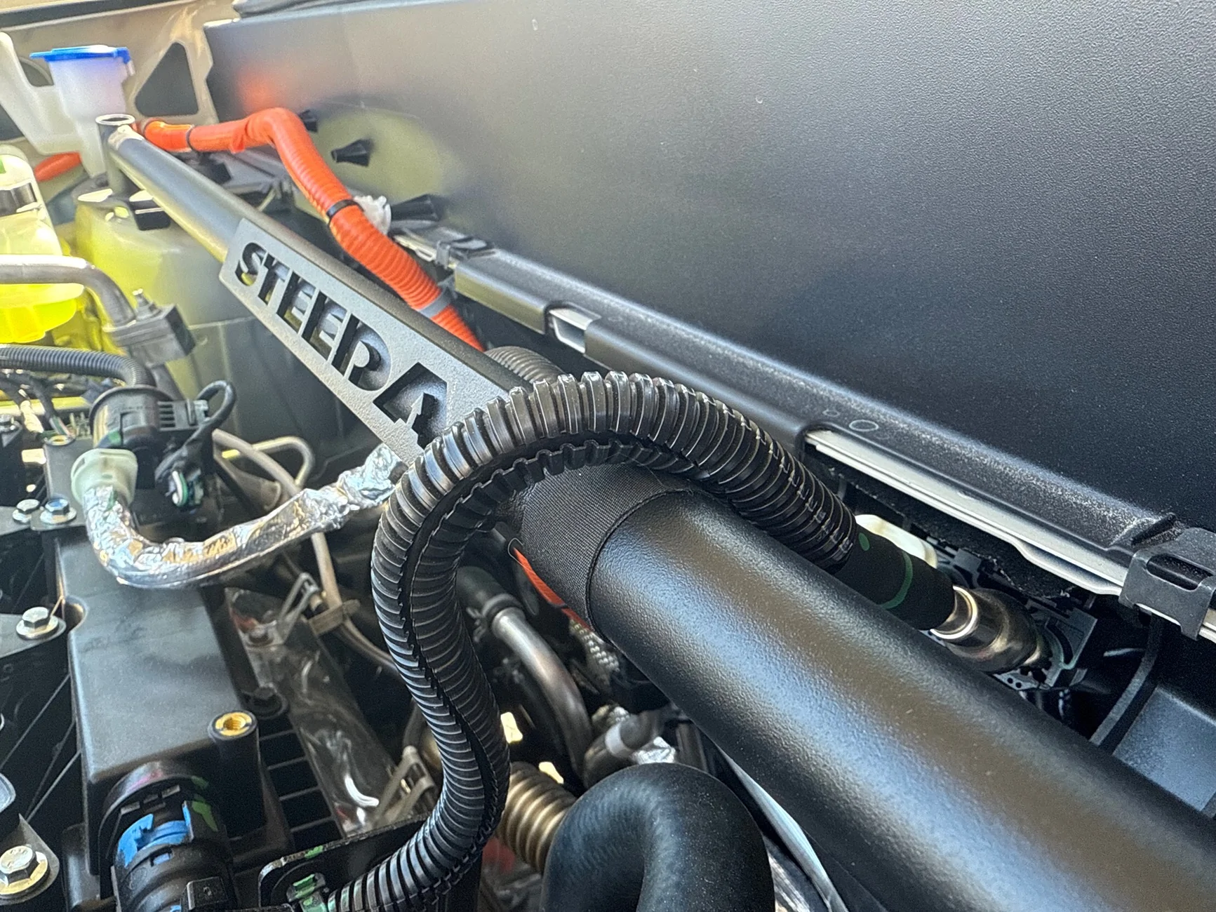

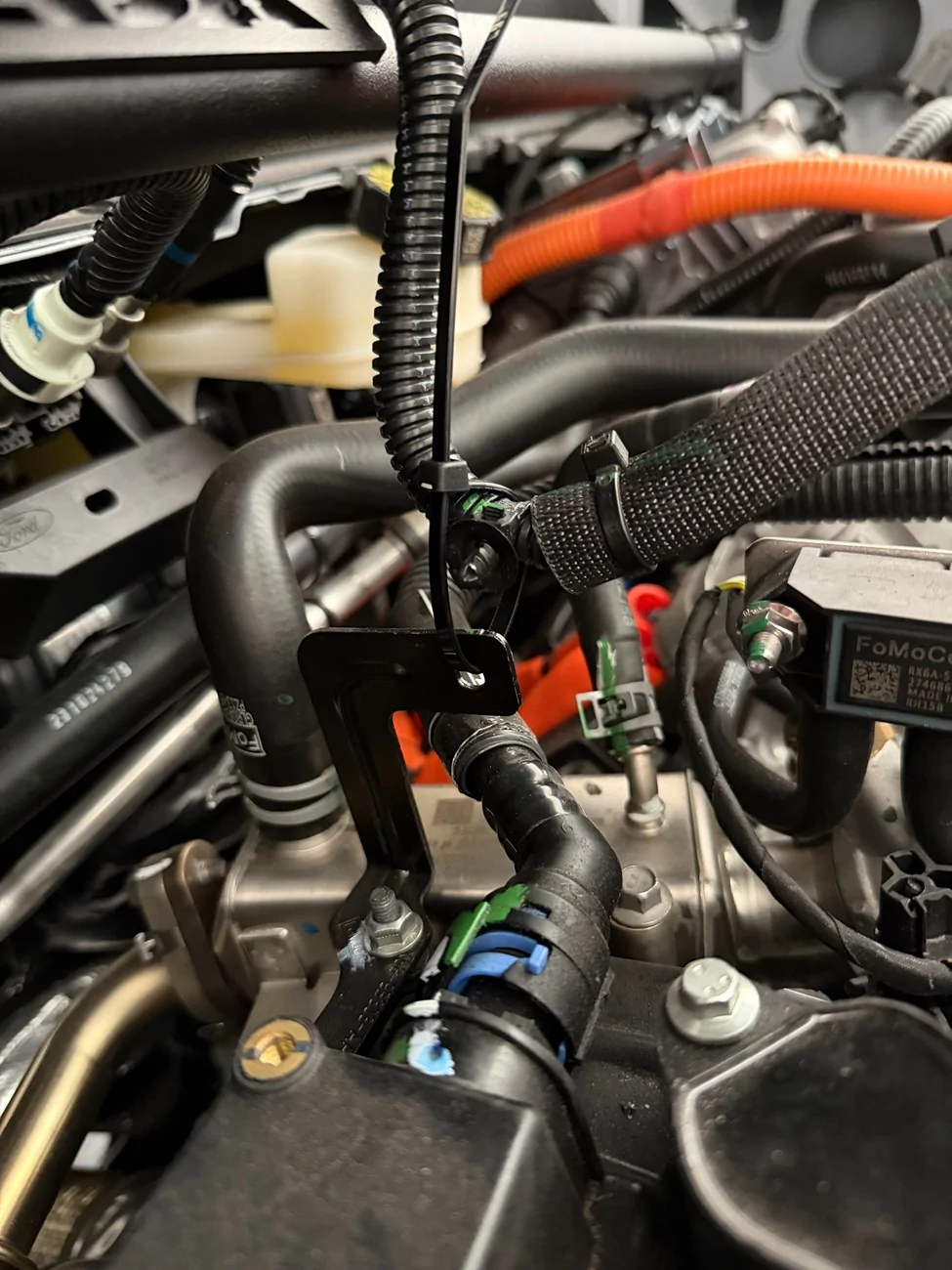

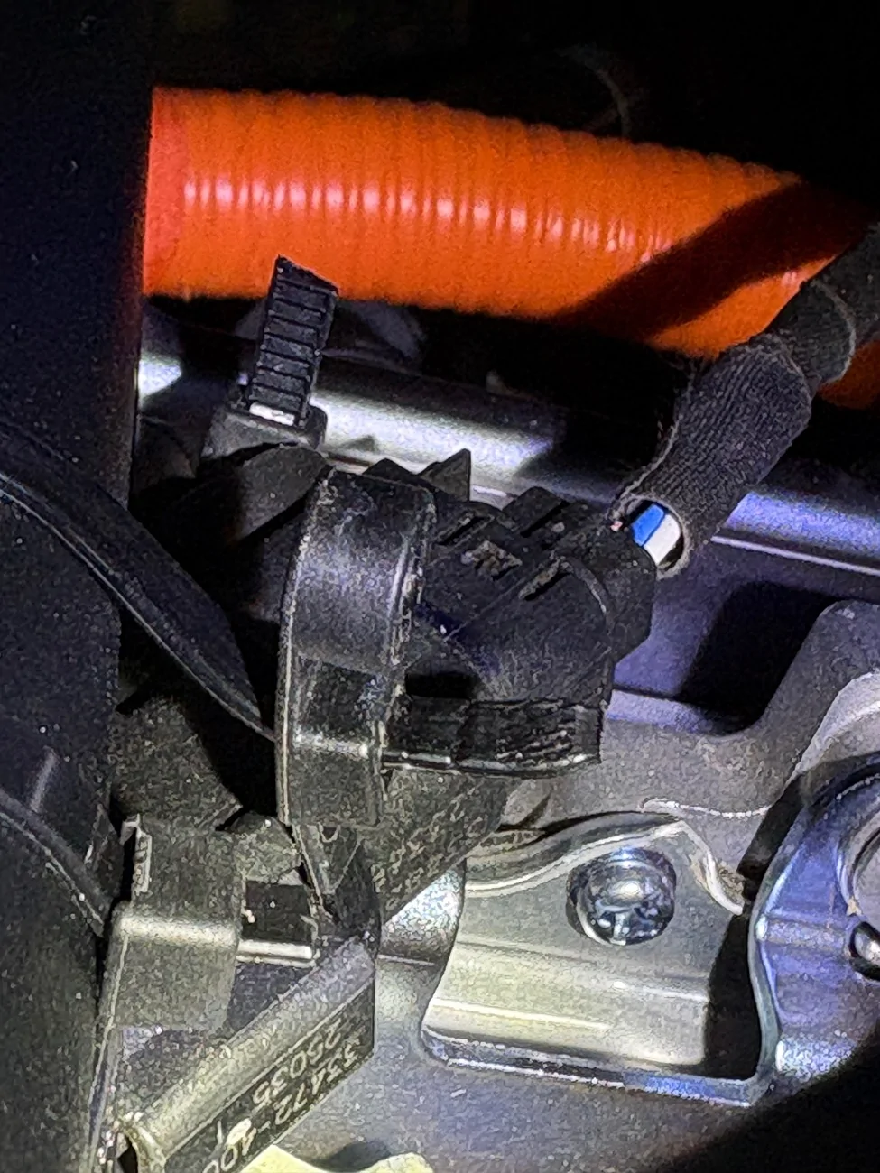

I just installed mine and I agree having the fuel going over the bar without modifications is not a good option. But pushing it underneath still put quite some pressure on the line, more than I was comfortable with.
I popped the midline connector out of the metal bracket.
I
Ford Maverick Steeda Strut Tower Brace - Black (2020-2025) installed IMG_0657
Then I added a metal piece and attached the hose to continue giving support.
Ford Maverick Steeda Strut Tower Brace - Black (2020-2025) installed IMG_0658
Now the hose easily goes over the bar and there is very little stress on the connectors.
Ford Maverick Steeda Strut Tower Brace - Black (2020-2025) installed IMG_0656
This photo was taken before I added the metal support bracket.
Ford Maverick Steeda Strut Tower Brace - Black (2020-2025) installed IMG_0659
It seems that Ford added the mid support bracket for a good reason, before I added my modified bracket, there was some resonance vibration around 1200 rpm. It is gone after I added the metal support. I'm guessing that without the mid support the hose was vibrating around that rpm, making the noise.
