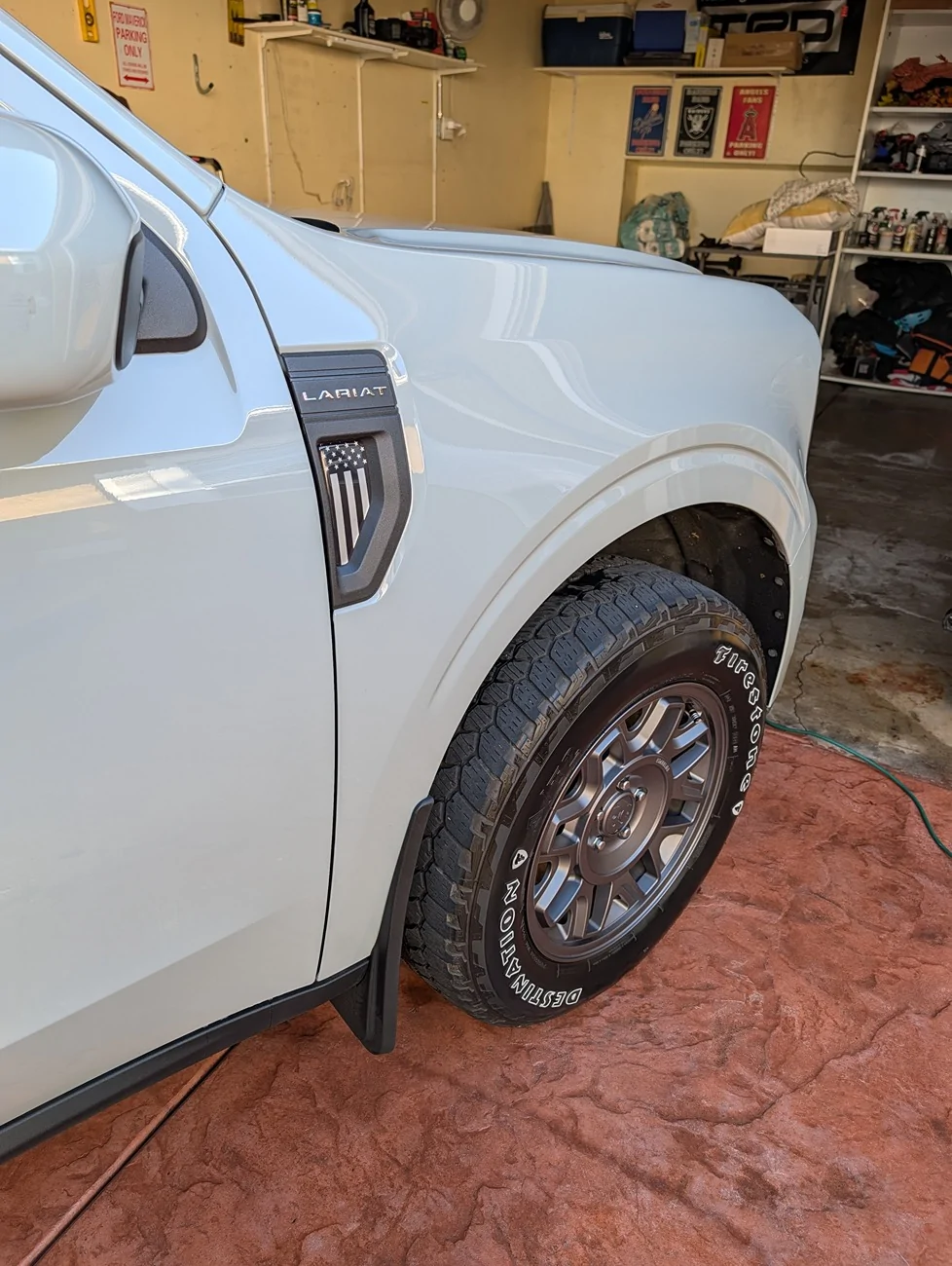

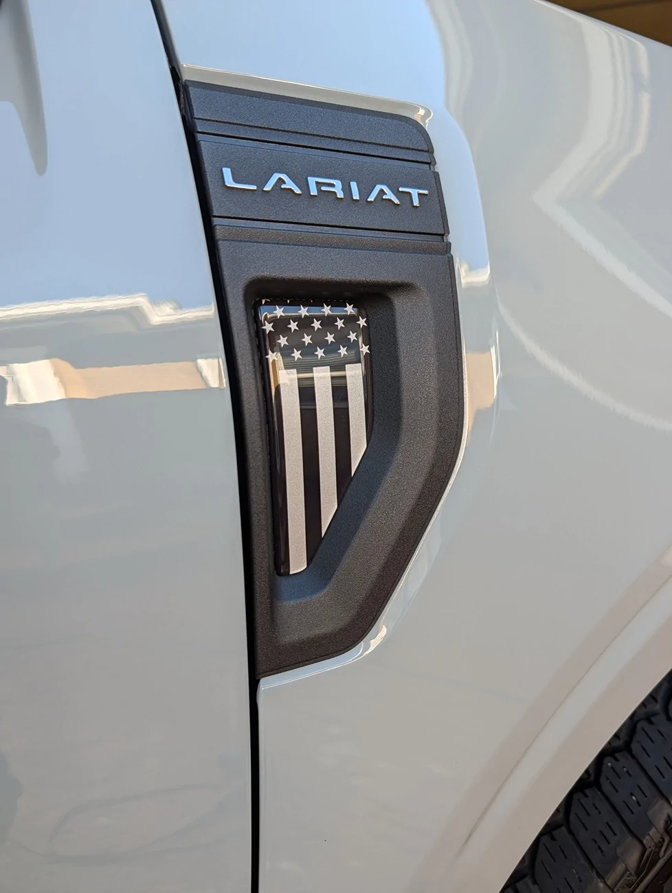

I took the easy route and just dropped in some Tufskinz 🤷🏼‍♂️
Ford Maverick Fender Vent Mod: Mesh Installed on OEM Vent PXL_20251109_231841995
Ford Maverick Fender Vent Mod: Mesh Installed on OEM Vent PXL_20251109_230540714
Ford Maverick Fender Vent Mod: Mesh Installed on OEM Vent PXL_20251109_231628467
