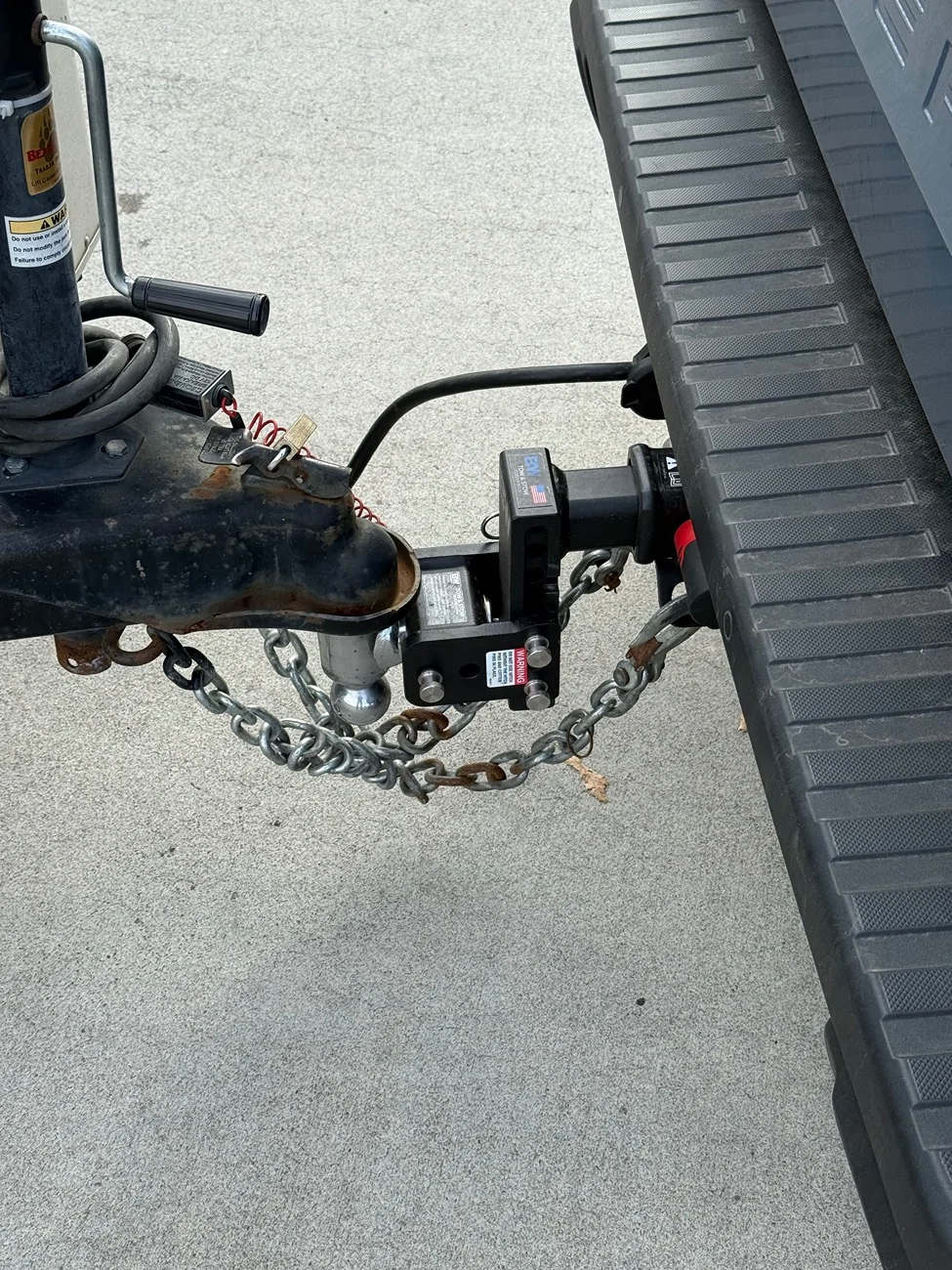

Here is the hitch setup. Simple: NO weight-distribution, NO sway control

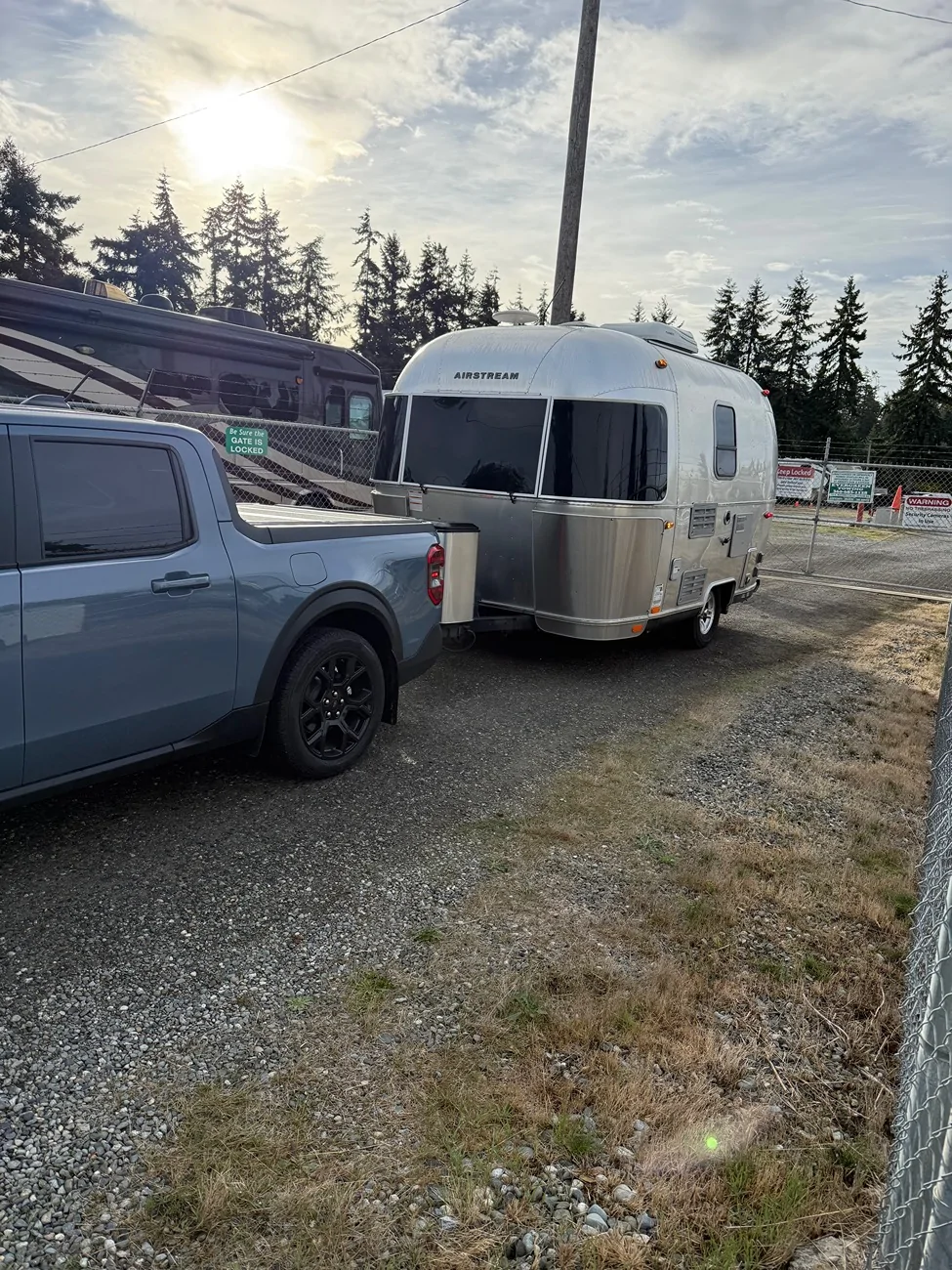

And here is Bambi on the ball:
Ford Maverick Lariat Hybrid tow test: Airstream Bambi (3500 GVW) IMG_0746
The Mav towed Bambi the 500 yards from my storage site to the gate on the e-motor alone.
Towed it just fine but then I realized that I should really be in Tow-Haul Mode!

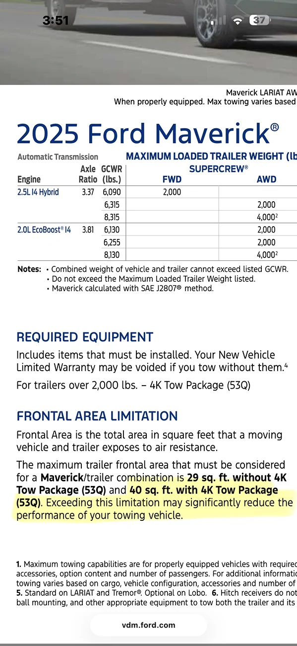

The one place you’re breaking the rules is the frontal area. I couldn’t find published frontal area number for the Bambi, but I see it’s 6’3” tall inside, so let’s say 7.0 feet when you include box frame, floor and ceiling. It’s 8.0 feet wide, so 63 square feet. Then add a couple extra feet for the AC unit on top and another foot or so for the tires and you’re around 66 square feet of front area.
Ford Maverick Lariat Hybrid tow test: Airstream Bambi (3500 GVW) IMG_4765
Ford literature basically says, “tow a normal size camp trailer under 4k lbs and your engine might blow up.”

That’s exactly my point. The 2k tow package will be nearly maxed out on weight and frontal area with a popup trailer, but it is still within their recommendations.
But then you step up to the optional 4k towing package and the towing weight goes up by 100%, but they only increase the recommended frontal area by 37%.
It’s effectively saying “popup campers only”

The info just says “if you exceed those suggested frontal area recommendations, your performance will suffer, every truck I have had paid a heavy penalty when towing.

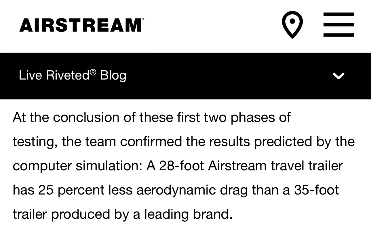

Airstream says that when they compared their best 28 foot trailer wit the competition’s worst 35 foot box trailer, they found that the airstream was 25% more aerodynamically efficient.
Completely unfair test and wildly optimistic, but 25% reduction. So the 16 ft airstream is still 50 square feet of frontal area if you make fudge factors for aero profile. That’s still 25% over what Ford recommends.

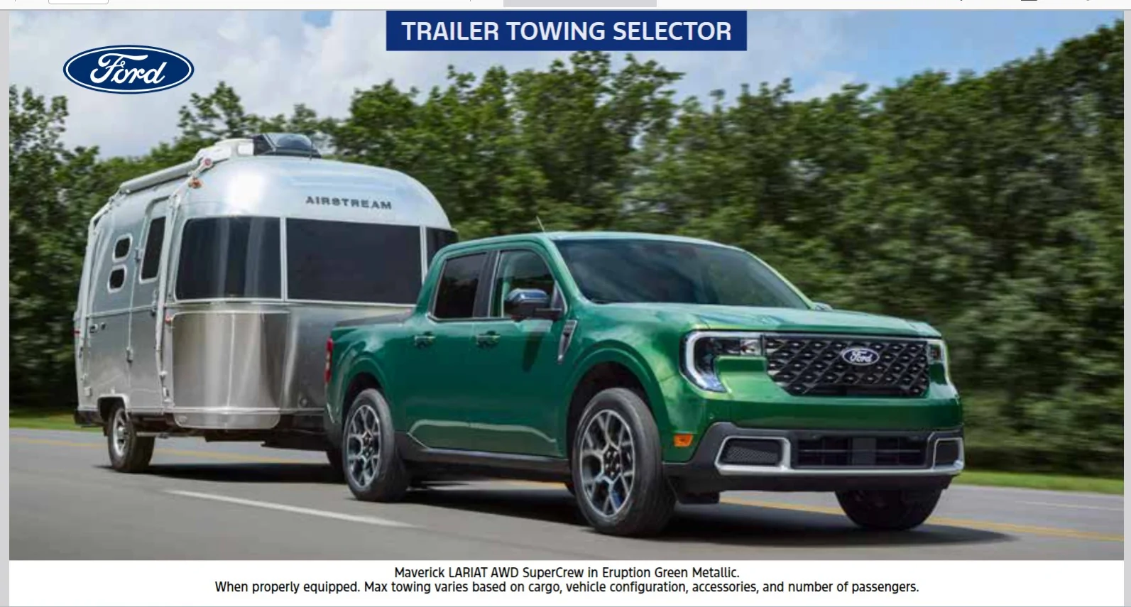

And yet this is the exact trailer that Ford shows in it's towing guide,,,,,,
https://www.vdm.ford.com/content/da...f/2025_Ford_Maverick_Towing_Info_fnl-Dec5.pdf

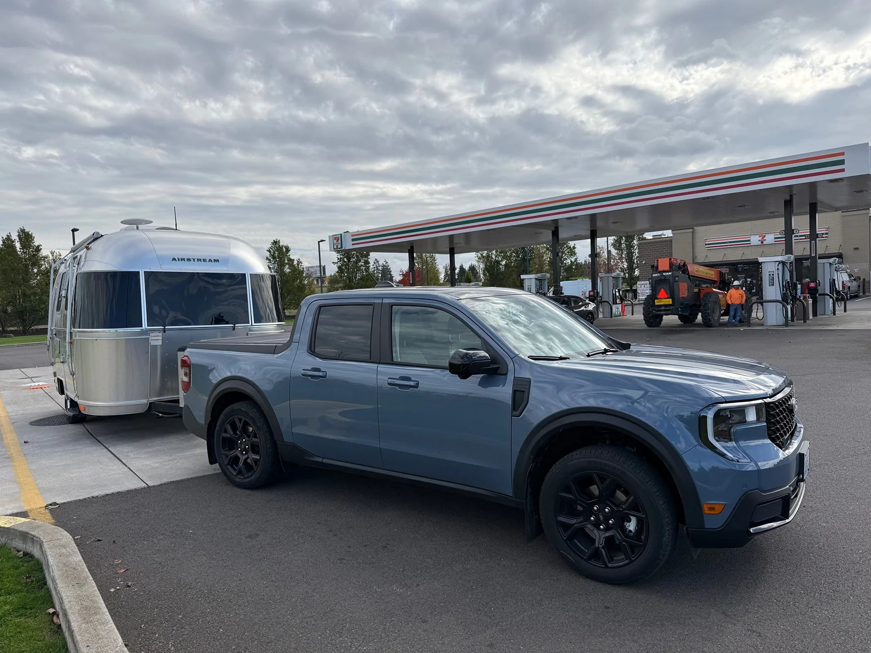

As others have noted on this thread, Airstreams aerodynamics are well established. Even the (heated) underbelly area is relatively clean aerodynamically. I had a 16ft Jayco before buying a 25 ft Airstream Flying Cloud. The Jayco was as aerodynamic as a shoe box. The Jayco's Murphy Bed meant towing an eight foot high vertical wall, eight feet wide. That was 64 sq ft of wind resistance. I was shocked at how well the Flying Cloud towed compared to the boxy little Jayco.
Much of the frontal area of the Bambi is in the lee of the Maverick tailgate (including 100% of the boxy propane tank cover). So it's not accurate to assume the the frontal area of the trailer is 100% additive to the frontal area of the Maverick itself. Also the edges of the Bambi are "faired" just as edges of aircraft are faired. Even the door hinges are faired on Airstreams!
I found the Bambi towed well even at 70mph but the fuel mileage at those speeds made for 150 mile fuel stops! At 15 mpg I'd rather be in the SuperDuty :)
The skull mirrors are marginal for multilane freeways but the BLIS (Blind Spot Information System w/ Trailer Coverage) meant that I was getting alerts from vehicles becoming adjacent to the trailer as well as adjacent to the Maverick. Its took about a minute to teach the Maverick the Bambi's dimensions (ball to bumper length and width) then when the Mav detected a trailer connected I was prompted to "select" the trailer from those previously saved. Once Bambi was selected the BLIS cone of protection was extended to include the trailer.
Ford Maverick Lariat Hybrid tow test: Airstream Bambi (3500 GVW) IMG_0752
Regenerative braking works quite well! With cruise control engaged the Mav will downshift as required on downhills to keep the set speed. With the cruise disengaged a quick tap of the brake pedal is all that is needed to cause a downshift. I ran the entire day with Tow/Haul mode on so the ICE ran all day without ever switching to e-motors yet never had the regeneration braking decline as the hi-voltage battery reached some arbitrary set point.
First night stop in Olympia.
