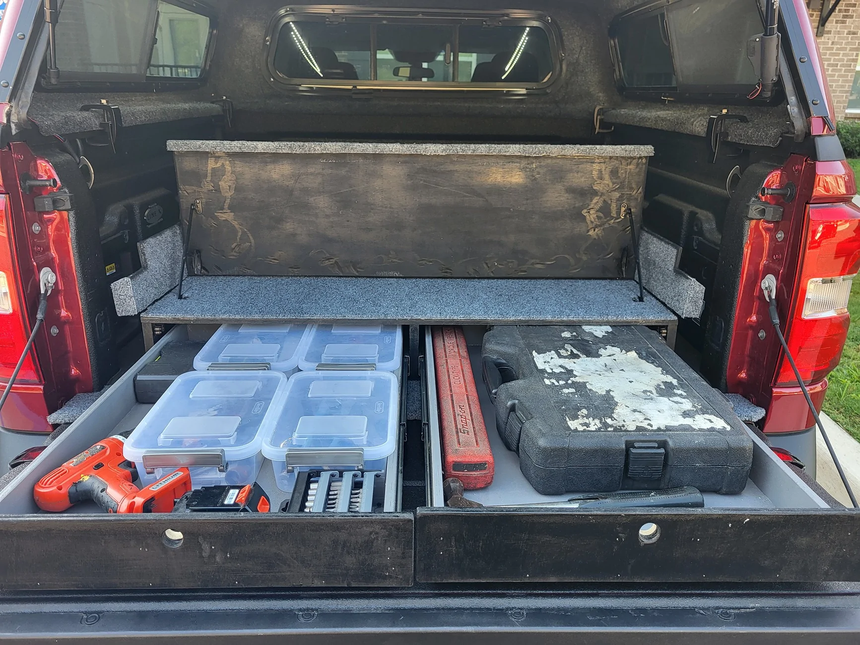

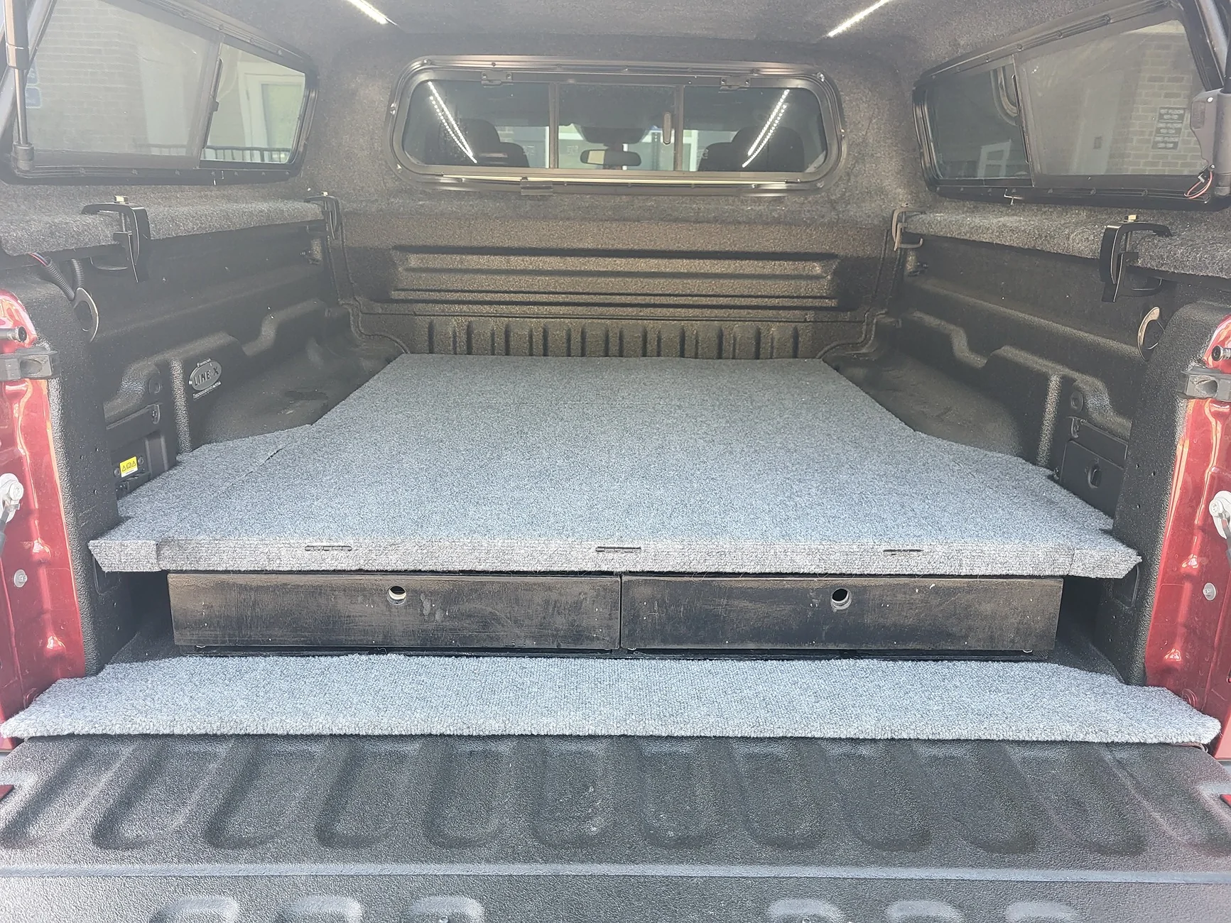

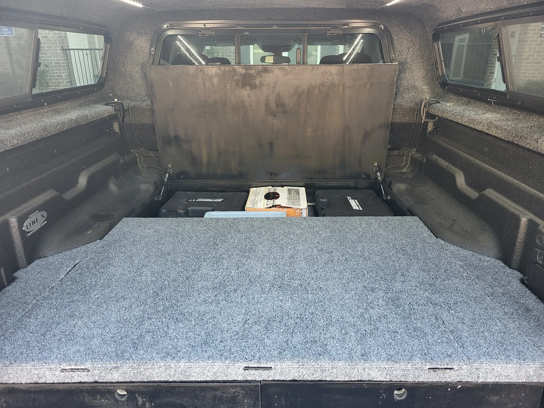

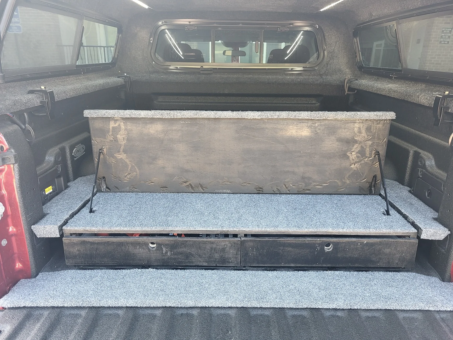

I built this for $300.00 to store my tools and have a place to secure my LP tanks or 5 gallon water bottles when I need to get them filled. The drawer cover drops down when you open the tailgate to keep things from falling in between the bed and gate. The left and right side filler covers flip up to gain access to the outlet and storage box, these also allow the box to slide out the back onto two saw horses if needed. I'm planning on installing 2 storage racks to store my beach chairs and umbrella and an adjustable divider that can be stored on one side of the bed when it's not needed.
Ford Maverick My multipurpose bed drawers / storage / divider 20250907_091329
Ford Maverick My multipurpose bed drawers / storage / divider 20250907_091419
Ford Maverick My multipurpose bed drawers / storage / divider 20250907_091454
Ford Maverick My multipurpose bed drawers / storage / divider 20250907_091530

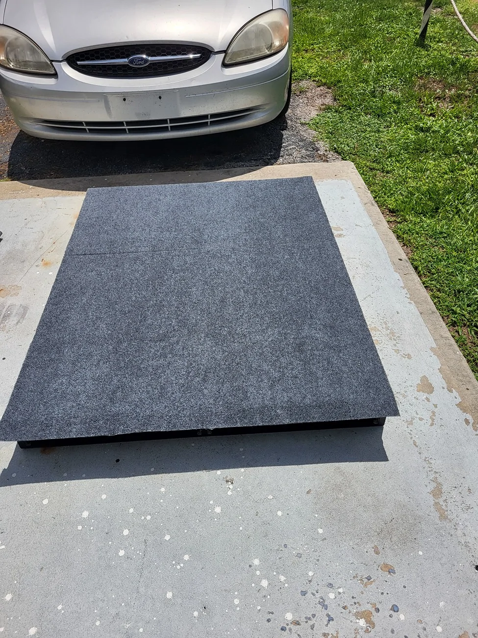

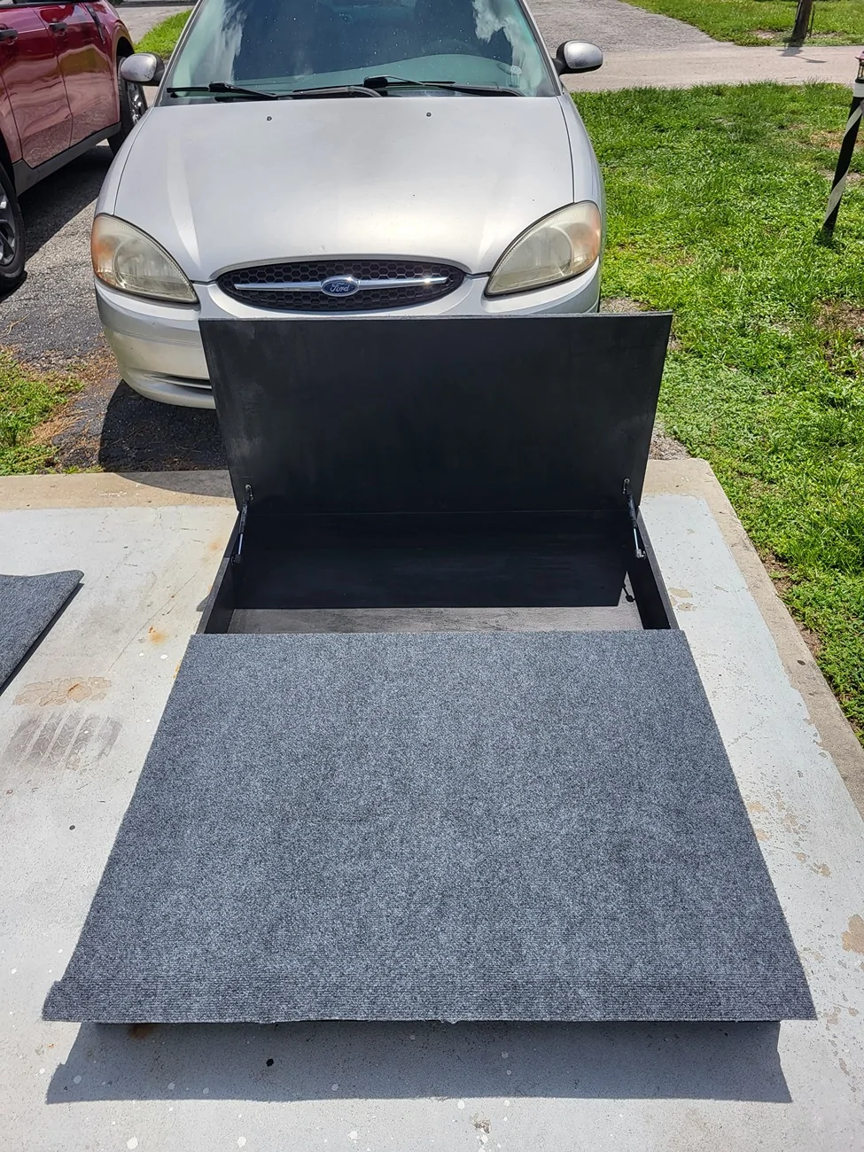

What did you cover the plywood with?
Little boy blue
Little boy blue
Feb 21, 2025
186
179
Okeechobee FL
1995 ranger but getting a 2024 Maverick.
I picked up some indoor/outdoor carpet from Home Depot and spray glued it on
Ford Maverick My multipurpose bed drawers / storage / divider 20250829_131356
Ford Maverick My multipurpose bed drawers / storage / divider 20250829_131409
