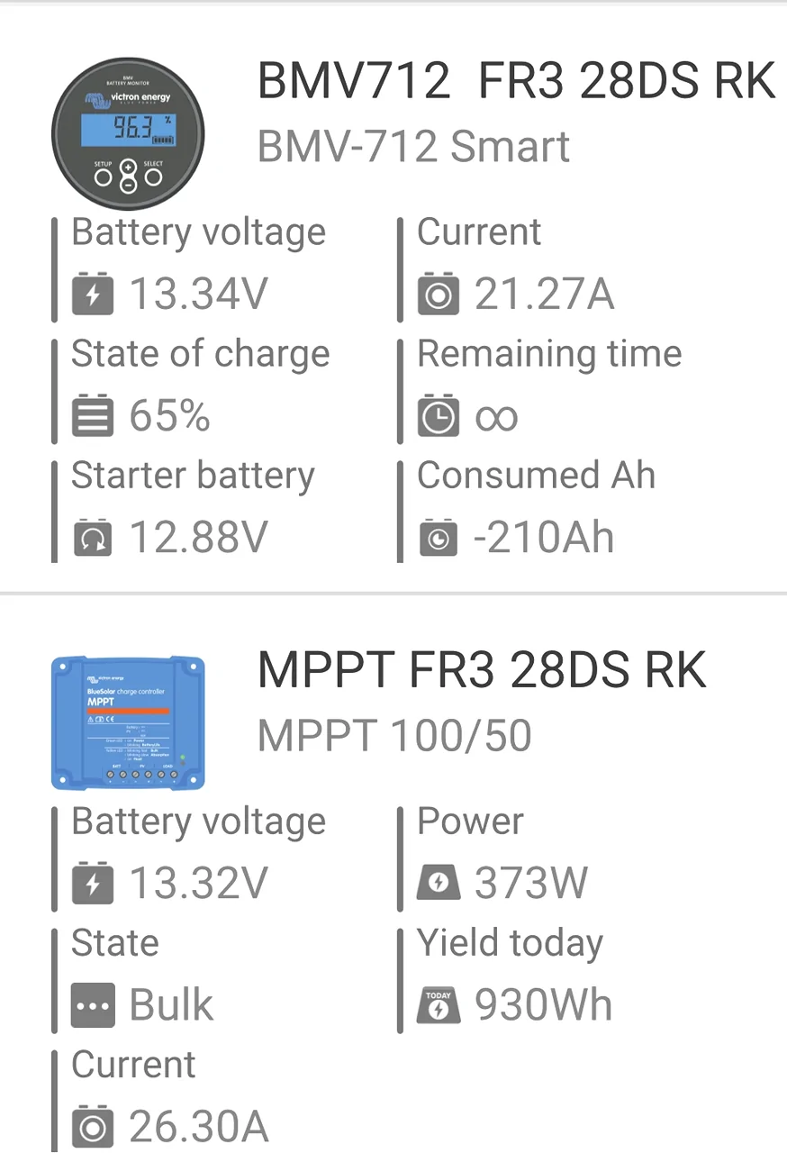

Solar is the way to go with boondocking. I have used it since 2018 on my 30ft class A. I am boondocking right now with a view of the Wrangel mountains. Currently my MPPT reports a 413w right now. I just used my Mr. Coffee to make coffee.

This morning:
