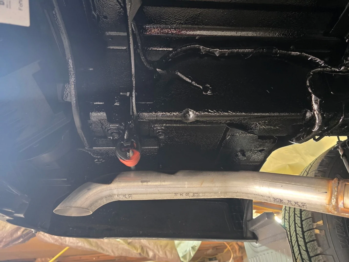

Just wanted to share my experience with a Rust Proofing/Undercoating product - Valugard. (valugard.net)
Coming from Western PA, winters are definitely challenging on vehicles with the salt and liquid brine sprays. Have experience with other products in the past (NHOU, Fluid Film, WoolWax, Zeibart, etc) - currently having NHOU on my F150. For my Maverick, looking for something different. Found Valugard. There are 3 different products - one for Rust Proofing (spray-in body cavities) VG-101 and 2 for Undercoating - either VG-104 or VG-160. I went with VG-101 and VG-160. Had it applied 2 weeks now. My installer invited me back for an annual checkup and free touch ups - if needed, but it is a once and done product - so no yearly 're-spray' as with NHOU (and others).
Cost was in line with everything out there - both products plus tax was $600. Had the rear 'famous' Mav cavity sprayed before putting the Mabett Underbody Cavity shield put on. Then the Undercoating applied. Rockers were sprayed before the Mabett Rear Wheel Splash Guards installed and the tailgate before the Mabett Tailgate Hole Cover installed. So, it is all sealed up. Again, this was my choice with this product. I like having the 2 products applied. No issue with the other products out there (as I said I use another currently on the F150). Simply put, the goal is to get to a minimum 10yr and 150k miles with no body issues. I am replacing a 2013 Ford Taurus with 165k miles and no rust issues. Obviously, I keep vehicles a long time. Have had the Mav since May 3, 2025. Approximately 2100 miles when coatings were applied.
Added benefits so far - a lot of sound dampening and it added some weight that you can feel. The Maverick replaced my 2013 Ford Taurus as the daily driver, and I have missed the weight/heavy feeling of the sedan on the road. Here are 2 pictures on the area after the Underbody cavity was sprayed and the Cavity shield installed with the Undercoating product applied. Remember - the Hybrid doesn't have the muffler in that location like the EcoBoost does for the Mav
