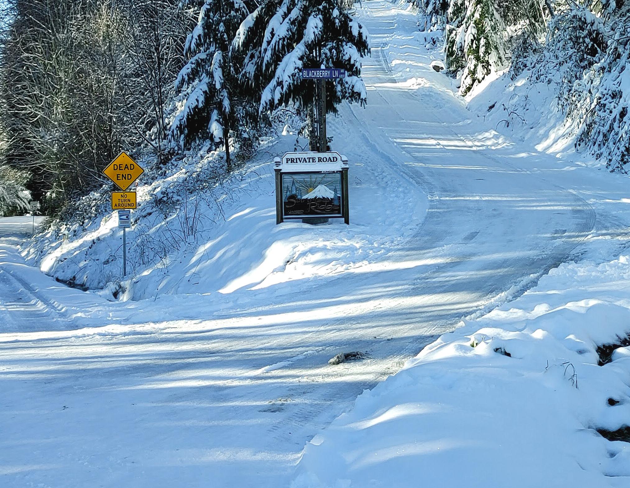

Looking up ominous Blackberry Hill. Because of the approach angle on the road I am on, it doesn't look as steep as it actually is in person. You can't really tell in the photo, but it was straight up packed snow and ice.

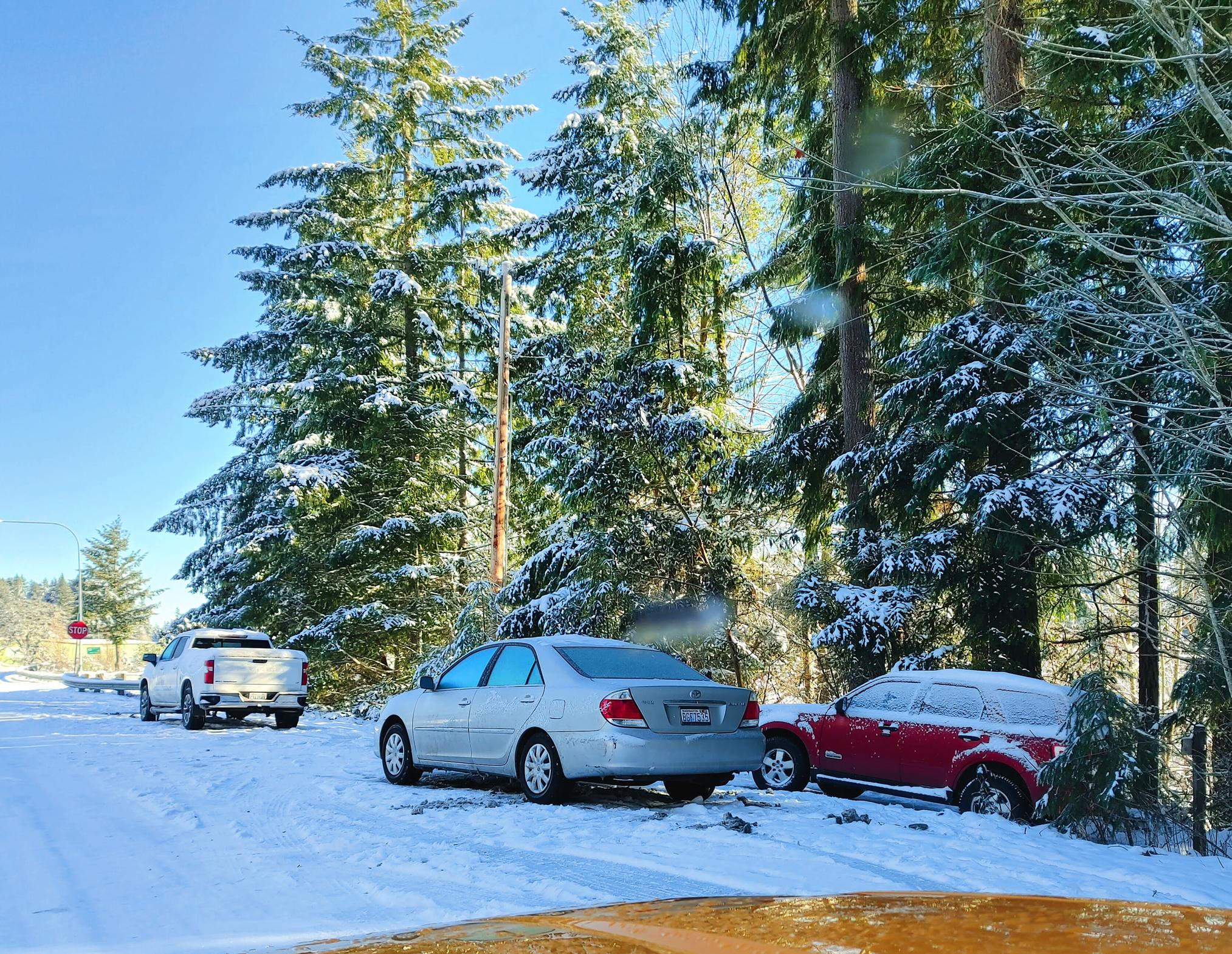

The cars at the bottom of Blackberry Hill. This was after morning commute. There were a lot more vehicles parked down here earlier. Even the 4WD vehicles didn't attempt it. How do people live up there in winter?

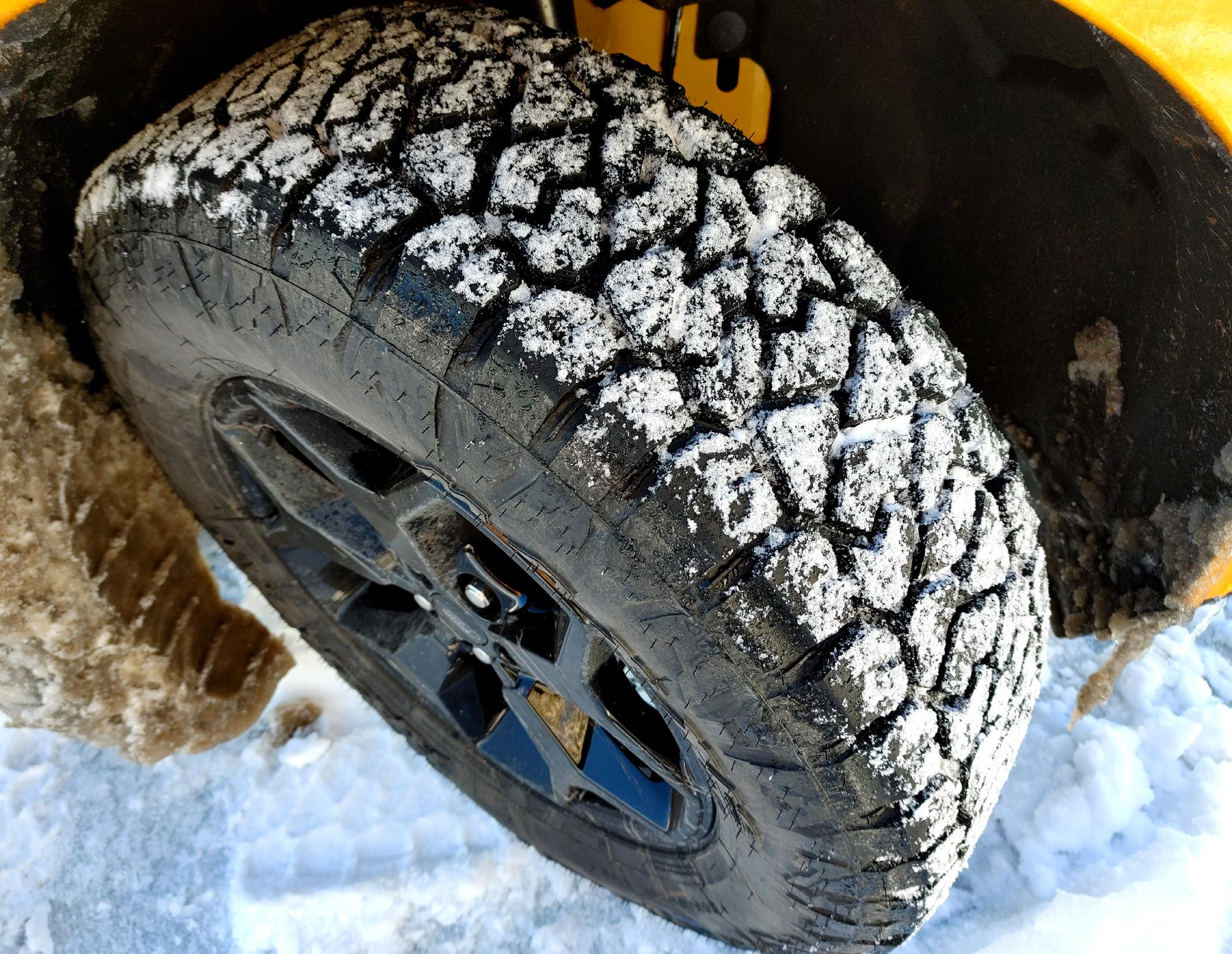

Example of treads after driving through 6" of undisturbed snow. It just loves to connect and the grooves just don't pack like other tires

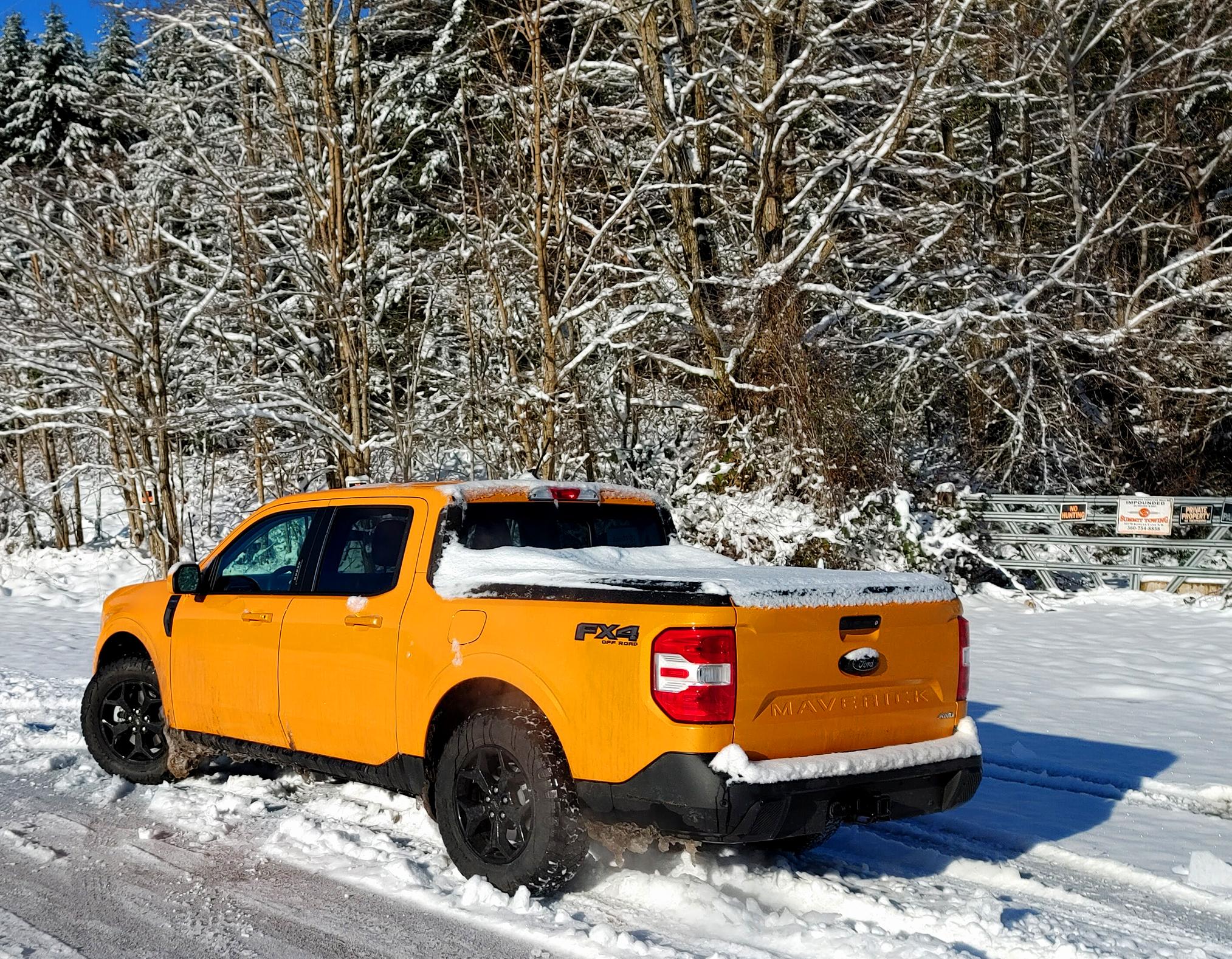

Naranjita idling in the sun after Blackberry Hill challenge
