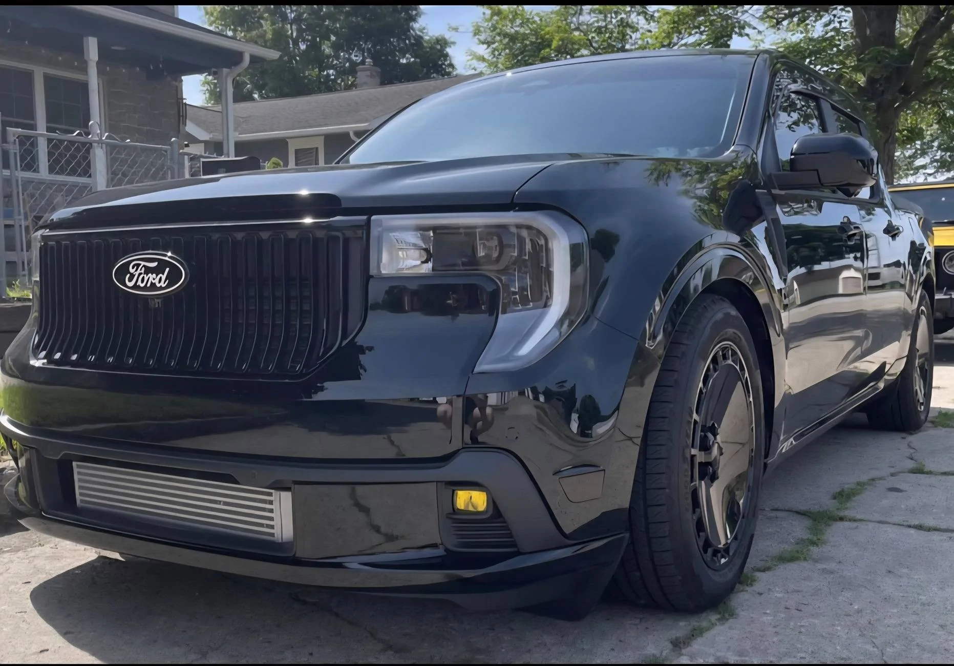

Looks great! Info on the intercooler?

Thx! I've been stalking their page. No 2025 that I can see. Got a link?
Its the same one that fits the 22-24. The downpipe changed for the 25s though.

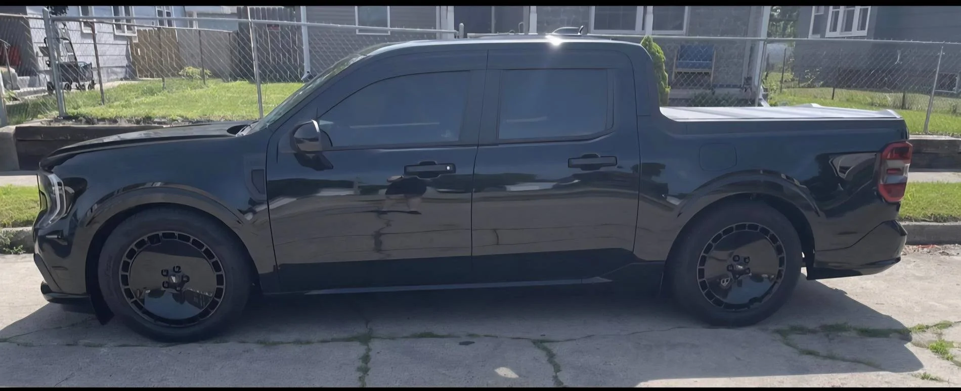

Love the stance, almost got a white one like that, but went for the lariat instead with all the bells and whistles, wanted the adaptive cruise, would like the paddle shifters though.

The lobo with the 702a package has adaptive cruise control

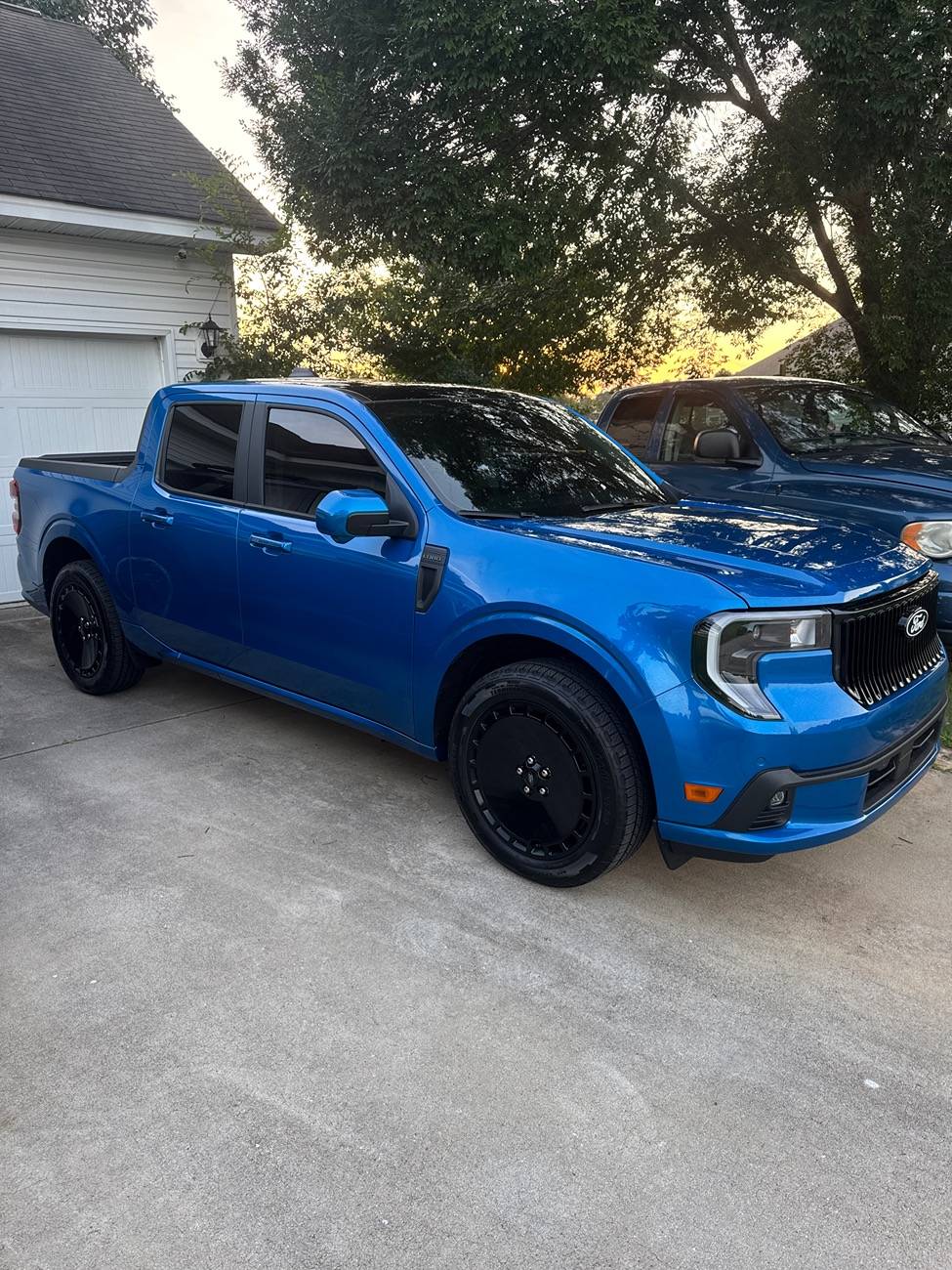

Silvers with swift springs 10k/8k, goodwin racing adjustable rear swaybar, massive strut brace and toe arms. Spc rear camber arms. Just need to take it in for alignment.
Which window visors are those? I just picked my Lobo up Saturday. Got it scheduled for the dealer to lower it this coming up Friday.

Didn't even think of that. Where does the sensor go after the intercooler inatall?
Have to relocate it back to behind the upper grill using the acc bracket from a 25 tremor.

Lund from Ford. Got them with points. They fit better if you mount them on the paint and not on the rubber like the instructions say.
