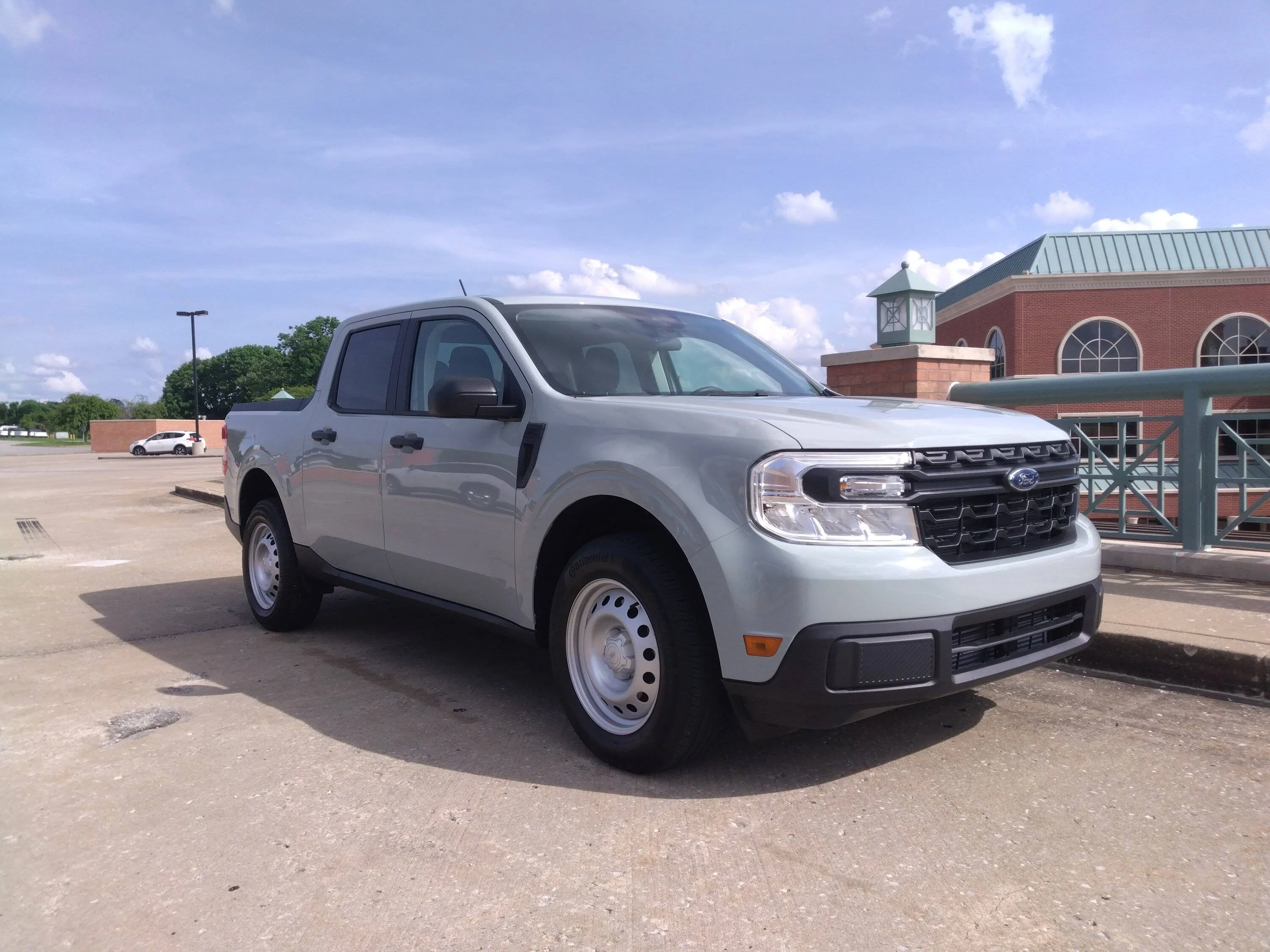

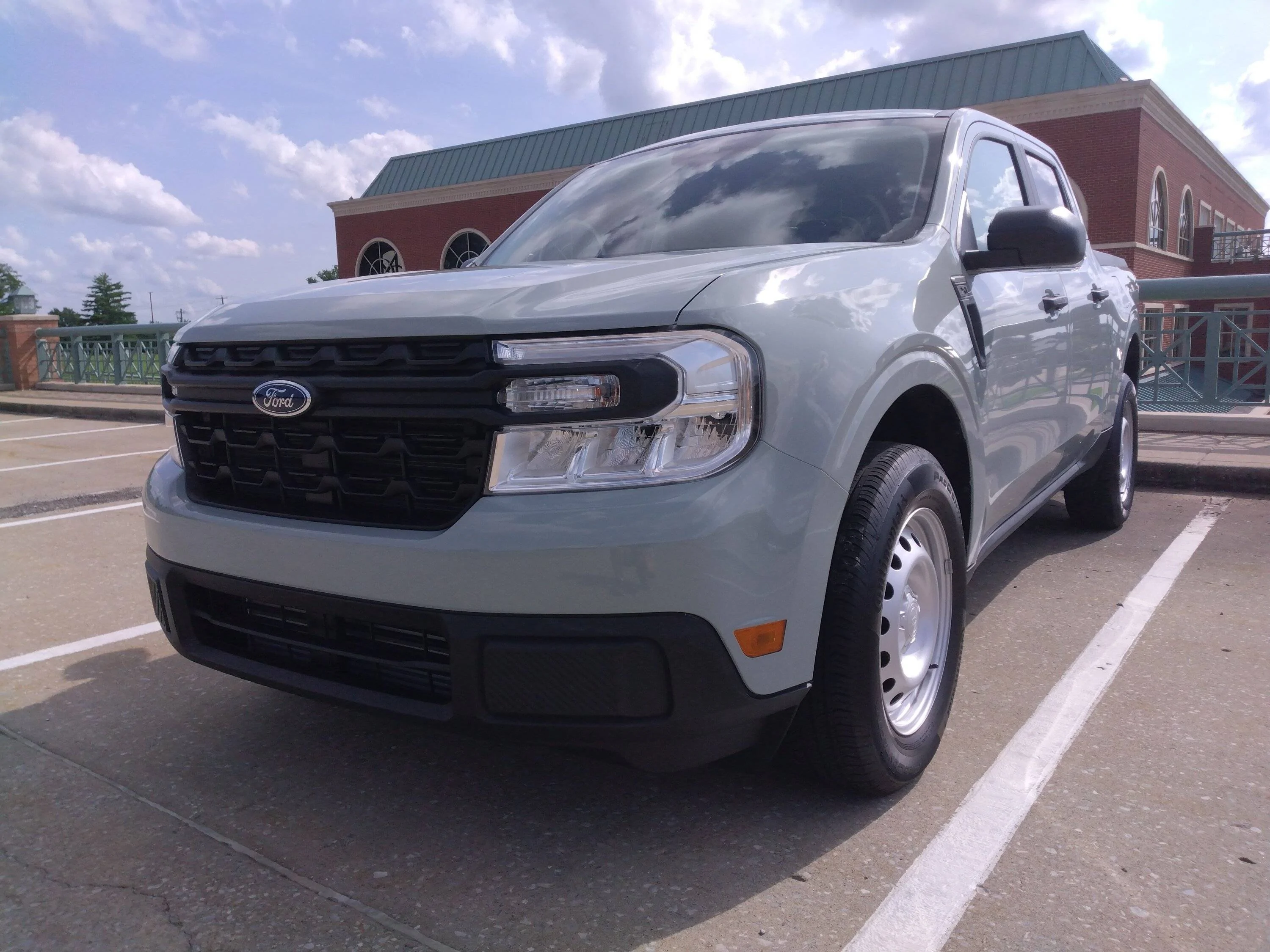

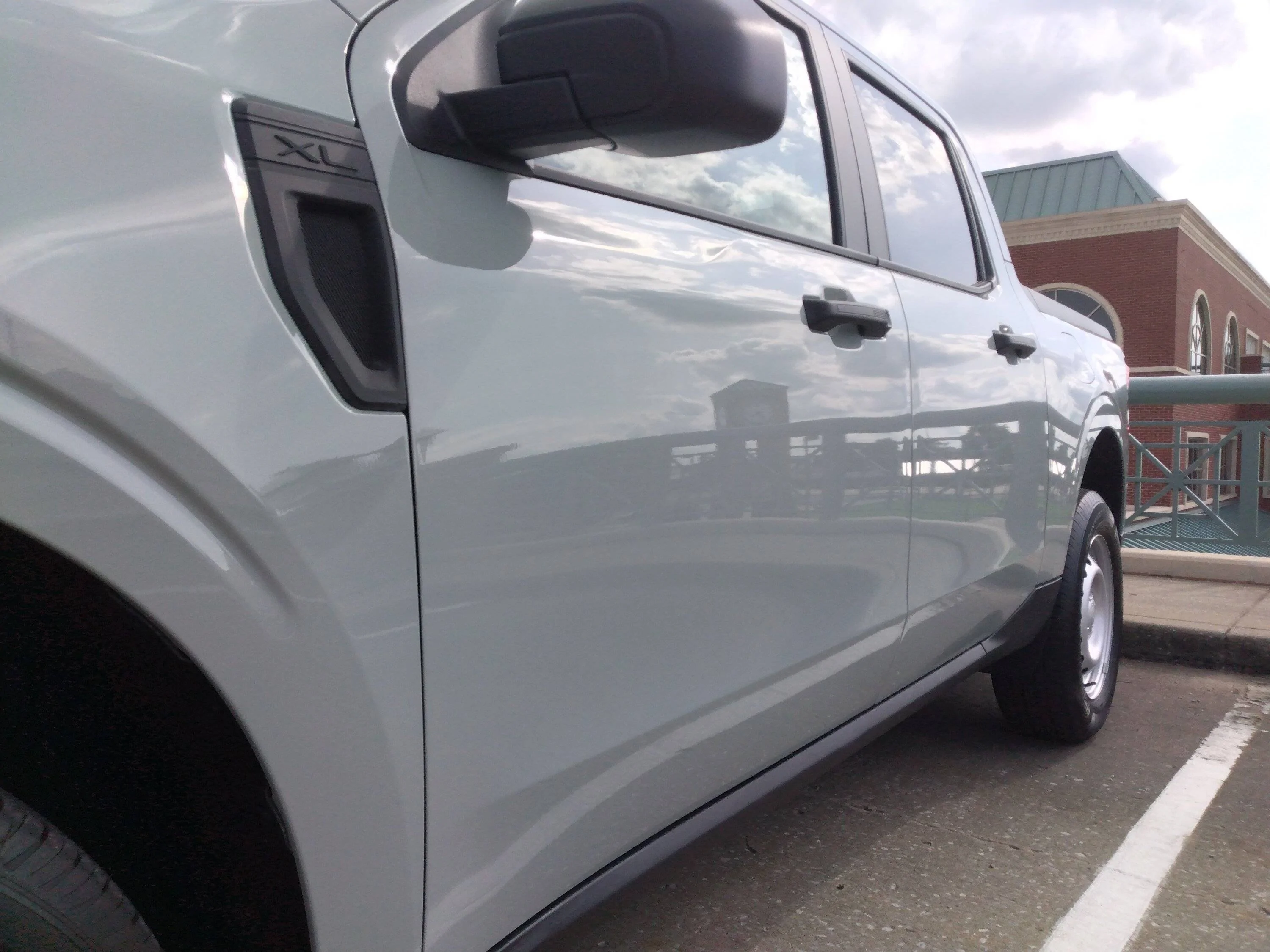

Spent my fathers day weekend doing one of my favorite hobbies, detailing my truck. I'm by know means a professional but I have always been very serious about caring for my cars paint. In the past I've had show cars and I treat my maverick like it's one as silly as that is 😂
My truck is about 8 months old and I have kept it spotless since I bought it But I never have really dived deep and done everything that needed to be done to it. Upon delivery the hood had lots of very fine scratches that No one but me would ever notice. Other than that the paint was perfect.
Here's the process I used
Step I was paint prep
1. Chemical Guys strip wash
2. Adams iron remover
3. Claybar with strip wash
Step 2 Polish/scratch removal
1. Zaino fusion paint cleaner and swirl remover applied with DA polisher
2. Adams surface prep
Step 3 Sealant and protect
1. Zaino Z5 pro polish
2. Zaino Z6 Gloss enhancer
3. Zaino Z2 pro polish
4. Zaino Z8 grand finale spray seal
The products I use are not ceramic, they are a polymer sealant. I like ceramic for cars I don't want to spend time detailing but I enjoy detailing my Maverick so I'm sticking with the Zaino I've always used.
Of course the pics don't do it justice, my camera is terrible and the green in cactus grey just won't show up in pics.
Anyway hope you enjoy!
