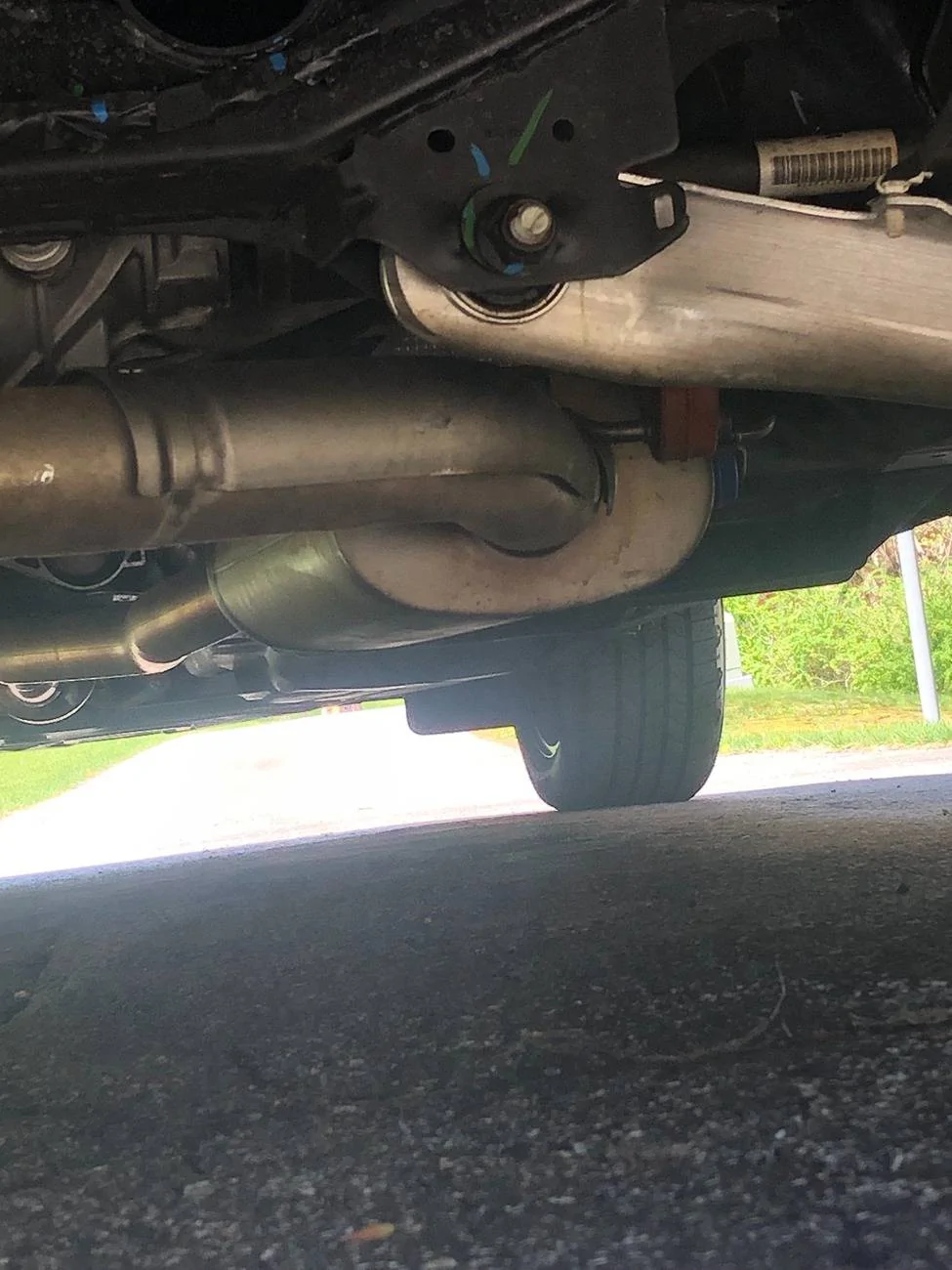

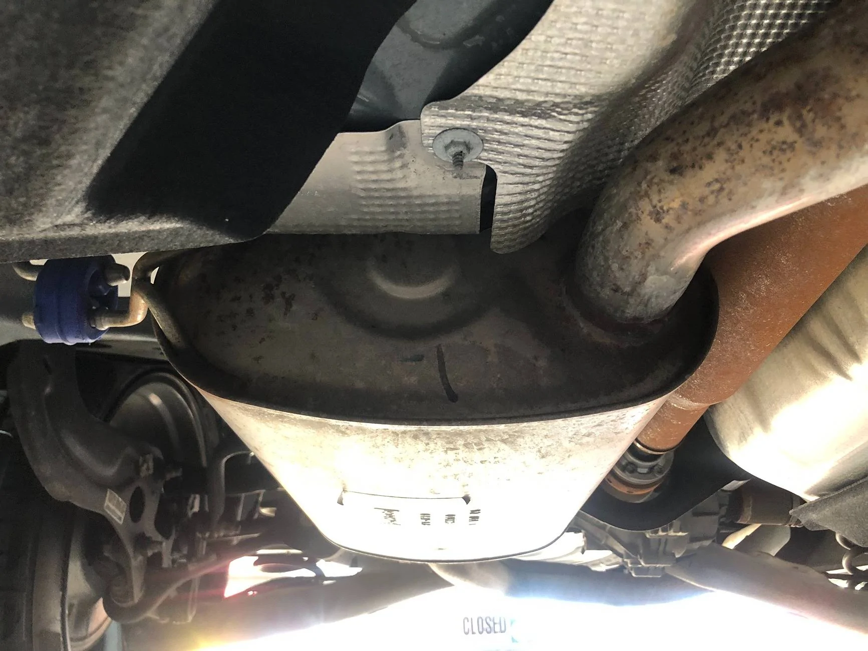

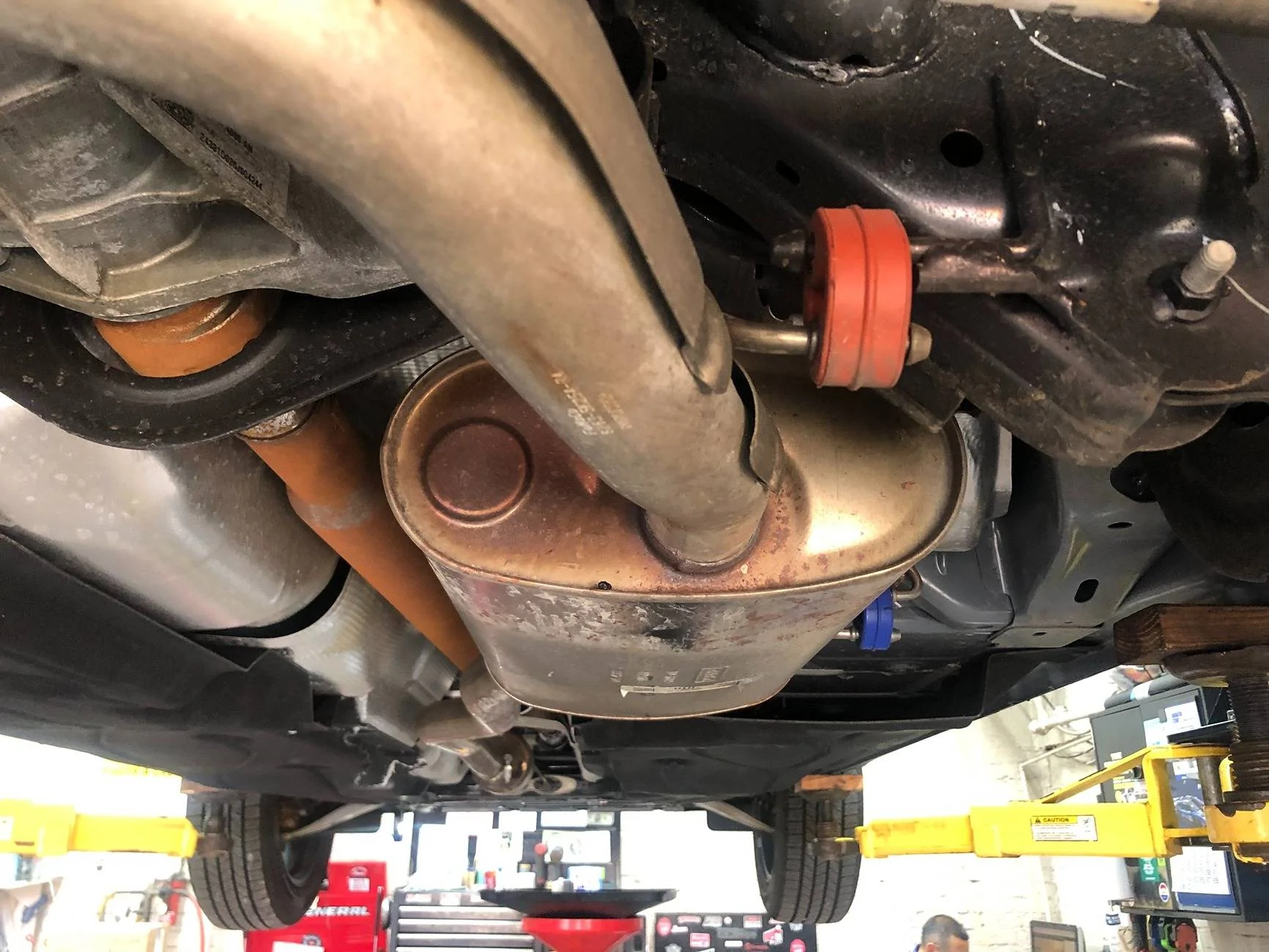

Yesterday I replaced the OEM FoMoCo muffler on my 2025 Maverick XLT 2.0L EcoBoost (MPC engine) with a MagnaFlow 12255, and I have to say — the transformation is insane.
🔊 Sound
  • At idle to ~2,000 RPM, it has a clean, smooth rumble — not loud, just present and refined.
  • After that, the sound almost disappears inside the cabin. No drone, no rasp — just clean flow.
🚀 Performance
But here’s where it blew me away: throttle response and acceleration are night and day.
Not just in Sport Mode, but even in Normal Mode, the truck feels like an entirely different animal. It’s as if the turbo and engine have been freed, no longer fighting to breathe.
It pushes HARD — and the way it climbs through the revs now is so much smoother and quicker.
Honestly, I can’t believe how much the stock muffler was holding it back.
I installed the MagnaFlow 12255 — 2.25" in/out, 5x9x20" oval body. It's a straight-through design flowing about 475 CFM, compared to the very restrictive stock unit.
If anyone’s considering an easy, safe, and highly effective exhaust upgrade, this is it.
Zero CEL, zero complications, and total driving satisfaction.
Cheers.

Just a reminder: $130 for the MagnaFlow 12255 + $70 for install = total $200. Shop took 18 minutes. Cut, weld, done. Perfect fit. Totally transformed the truck. 🔥👌

For those concerned about rust / salt corrosion, especially near the coast.
As you can see in my photos, the golden / yellow tone you notice on the muffler and the entire underside of my Maverick is intentional.
On day 2 of the truck’s life on NY roads, I treated the entire underside, including the exhaust before and after installing the MagnaFlow — with 3–4 cans of AMSOIL Heavy-Duty Metal Protector.
Fast forward 1 year and 24,000+ miles, exposed to:
NY winter salt
rain, humidity
daily driving
EVERYTING underneath still looks immaculate:
no rust, no surface corrosion, no deteriorationincluding the entire exhaust system.
This isn’t theory, it’s documented, real use.
For anyone living by the beach or in salted-road states, this is something worth considering. Excellent product, excellent results.
Just sharing what has worked extremely well for me. Enjoy your Maverick’s

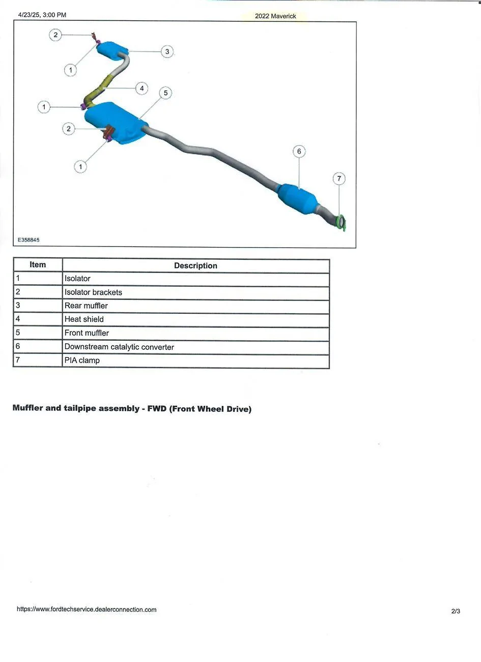

I was going to suggest the same thing ! A sound clip at start up, cruise and acceleration would be awesome. I like the difference on accelration the S&B intake made on my little 2.0 so Im guessing the Magnaflow will be great just hesitant on too much rumble- Interestingly the Ford shop reference shows the 2.0 AWD and FWD to have a front and rear muffler - My FWD only has a main front muffler- Do any of you guys have 2 mufflers ? Large front main and smaller rear muffler ? My Maverick accelelerates surprisingly strong so Im guessing you could easily remove the small rear muffler for a possible improvement.....
