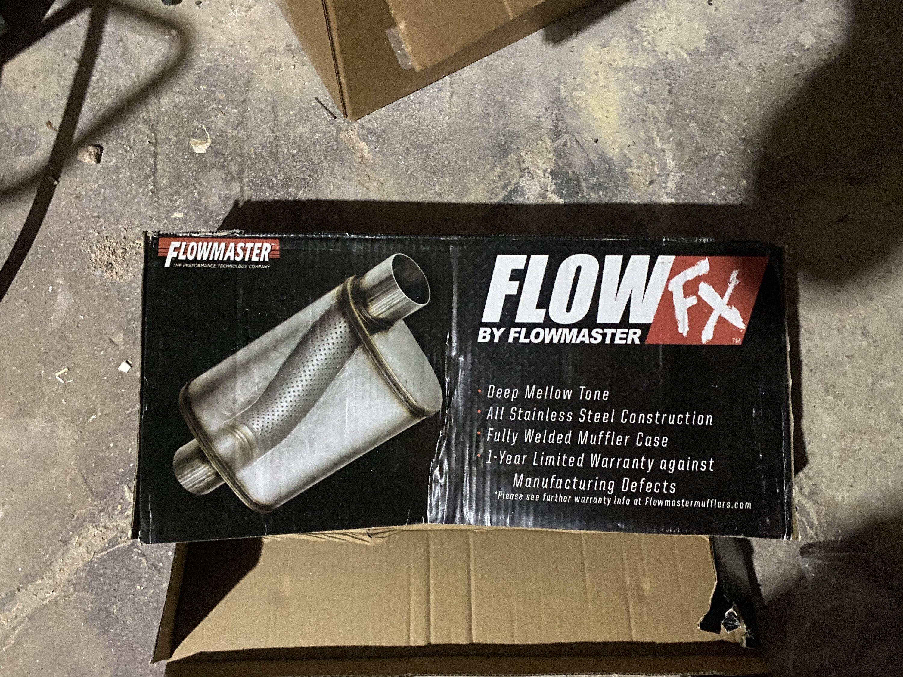

I bought an FX Series Flowmaster which supposedly has a very mellow sound. All I have to do is figure out how to fit the pipes and hang the muffler so it looks reasonably professional.

So installed this muffler at the end of the system and it sounds virtually the same. I realized when I cut the original one off and started it that it was just a resonator but by that time I was already committed. I guess I will need to replace the actual muffler with a straight pipe and then see how it sounds.
