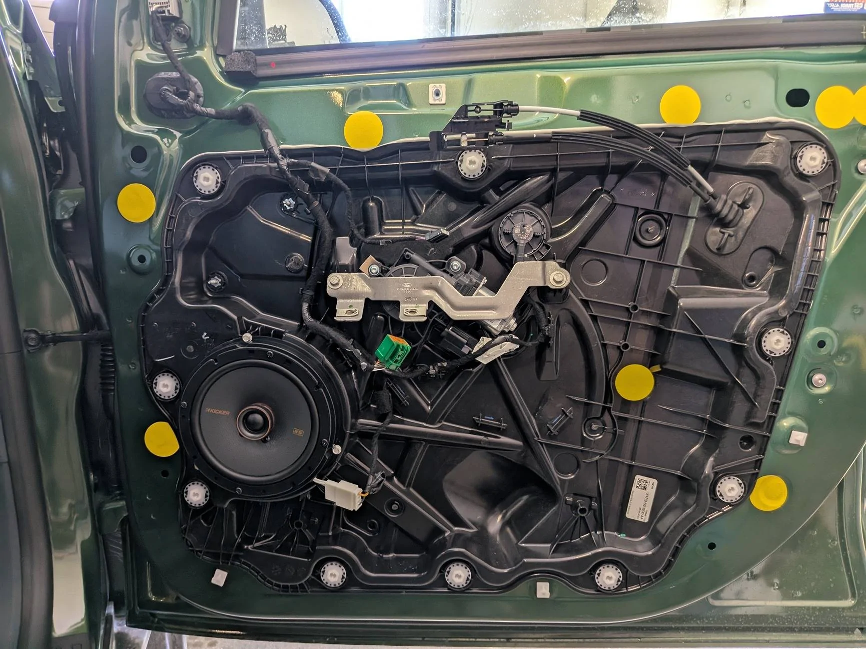

Front Door installation: I've seen lots of posts claiming the front door panels would be a pain to remove...but that wasn't my experience! Maybe it's because I've done several speaker swaps in a variety of cars before, but honestly, the Maverick's panel attachment is pretty straightforward. With just over 1000 miles on my truck, I can confirm that the plastic clips were TIGHT, though, so it took a lot of force to get them off. The front doors were by far the easier of the two locations to get to.
Ford Maverick 2025 XLT Speaker Swap - KICKER Front Door & Rear Pillar Upgrade PXL_20250223_151613613.MP

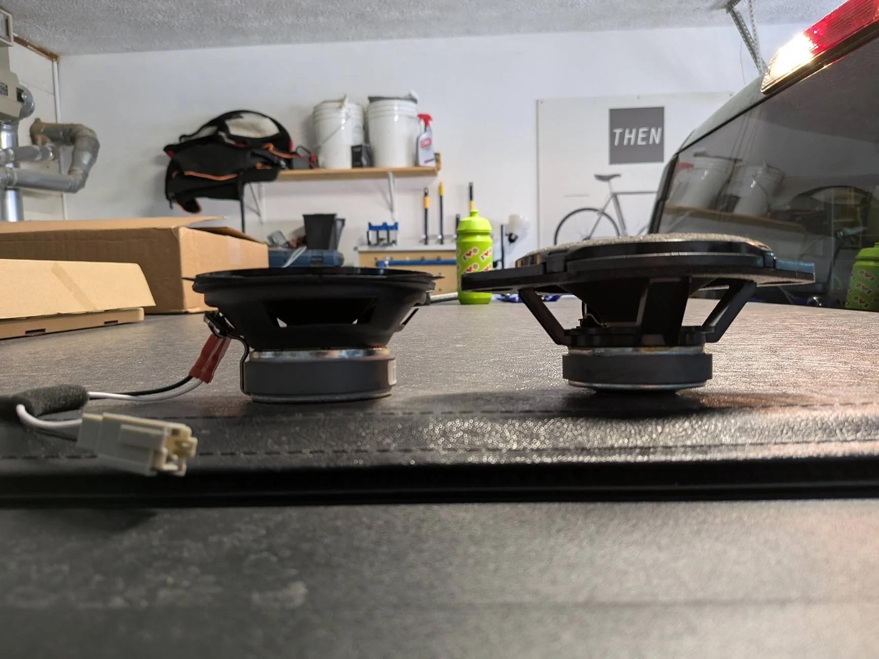

The speaker adapter rings that came from Crutchfield were great, but I did have to drill a hole to feed the wires behind the speaker. I used some of the black sticky sealant that came with the speakers to hold the wires in place and seal the hole back up. Secondly, I know most people have already seen this, but I could not believe how small the drivers are on the stock speakers (left):
Ford Maverick 2025 XLT Speaker Swap - KICKER Front Door & Rear Pillar Upgrade PXL_20250223_144913985.MP

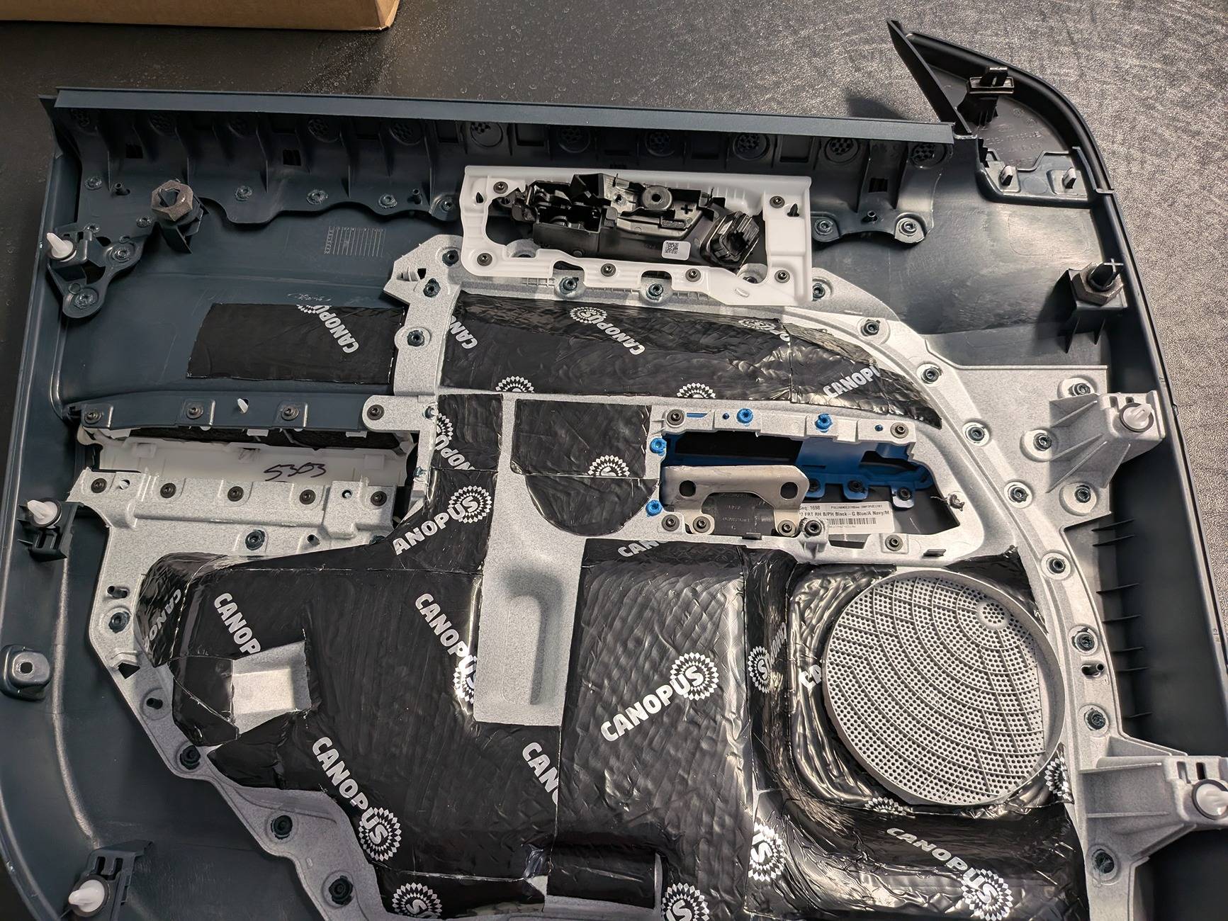

I also took the time to add some butyl sound deadening mat to the interior of the door panels. These have definitely cut down on resonance in the panels themselves, so I would recommend taking the extra 30 minutes per door panel to do this step!
