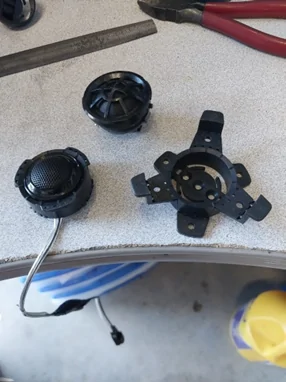

For me the tweeter grills came off with the A-pillar and were difficult to separate from the A-pillar.
Ford Maverick Part 2: Front Door, Tweeter and Rear Speaker Replacement 1769453222490-m3
In the above picture, top center is the OEM tweeter. On the lower right is one of the adapter brackets that came with tweeter kit. Lower left is finished product. It is the modified bracket (cut and file) which holds the new tweeter in the OEM dash location. At the OEM dash tweeter location I had to trim a couple tabs so the tweeter sits deep in the OEM dash location. I used electrical tape to keep the Metra harness attached to the tweeter. This is probably not necessary. I recommend you wrap some sound deadening material around connector which attaches to the OEM wire harness. This mitigates this connector vibrating against the dash and prevent dash rattle.

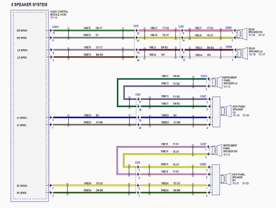

I did not use the Infinity supplied tweeter crossover because I assume the OEM sound system knows those outputs are for the tweeters and would already have a hi pass filter in place.
The high pass filter is actually soldered on the OEM tweeter itself. Since the tweeters are fed from the front door speaker signals, I am not sure there is any other way for Ford to do it. Maybe there is something else between the door and the dash...
Mav_Owner
Jose
Oct 23, 2024
60
New Braunfels, Tx
2024 Ford Maverick Hybrid Lariat

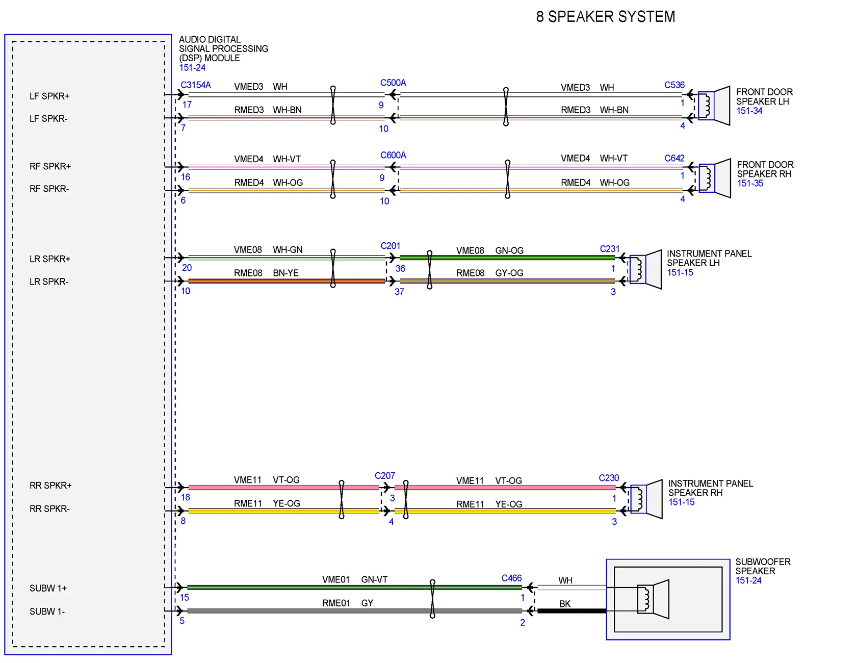

The Standard and B&O sound systems have different speaker connectivity. Below is the Standard system and the tweeters are driven off the door speakers. The crossover should be used for this application.
Ford Maverick Part 2: Front Door, Tweeter and Rear Speaker Replacement 1770080739823-nh
Here is the B&O schematic. The tweeter is driven directly from the DSP. Since the center and rear speakers are not on this schematic, it appears the center and rear speakers are driven from the "head unit."
