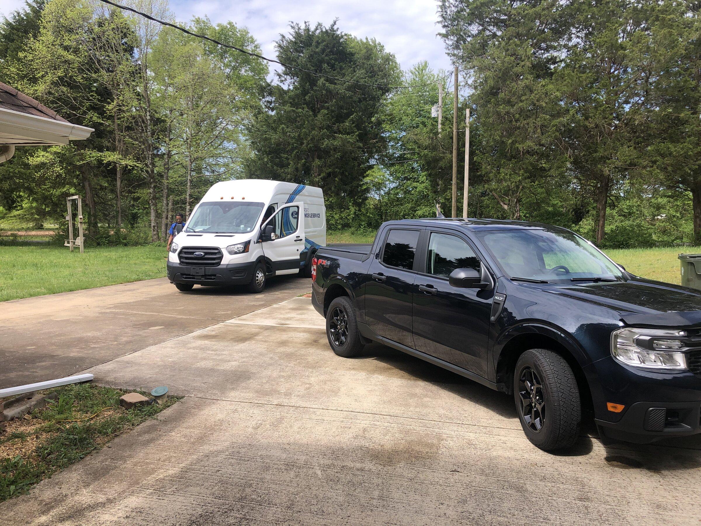

Initially received an alert on my Ford pass app there was a recall to reprogram the integrated trailer relay module which said to wait for a letter of the recall notice. Received the letter yesterday and called for an appointment. They got me in next day with their Mobile service.
Ford Maverick 4K Tow Recall B4DED3FD-D651-4EA7-BED6-7752C43E69BF
