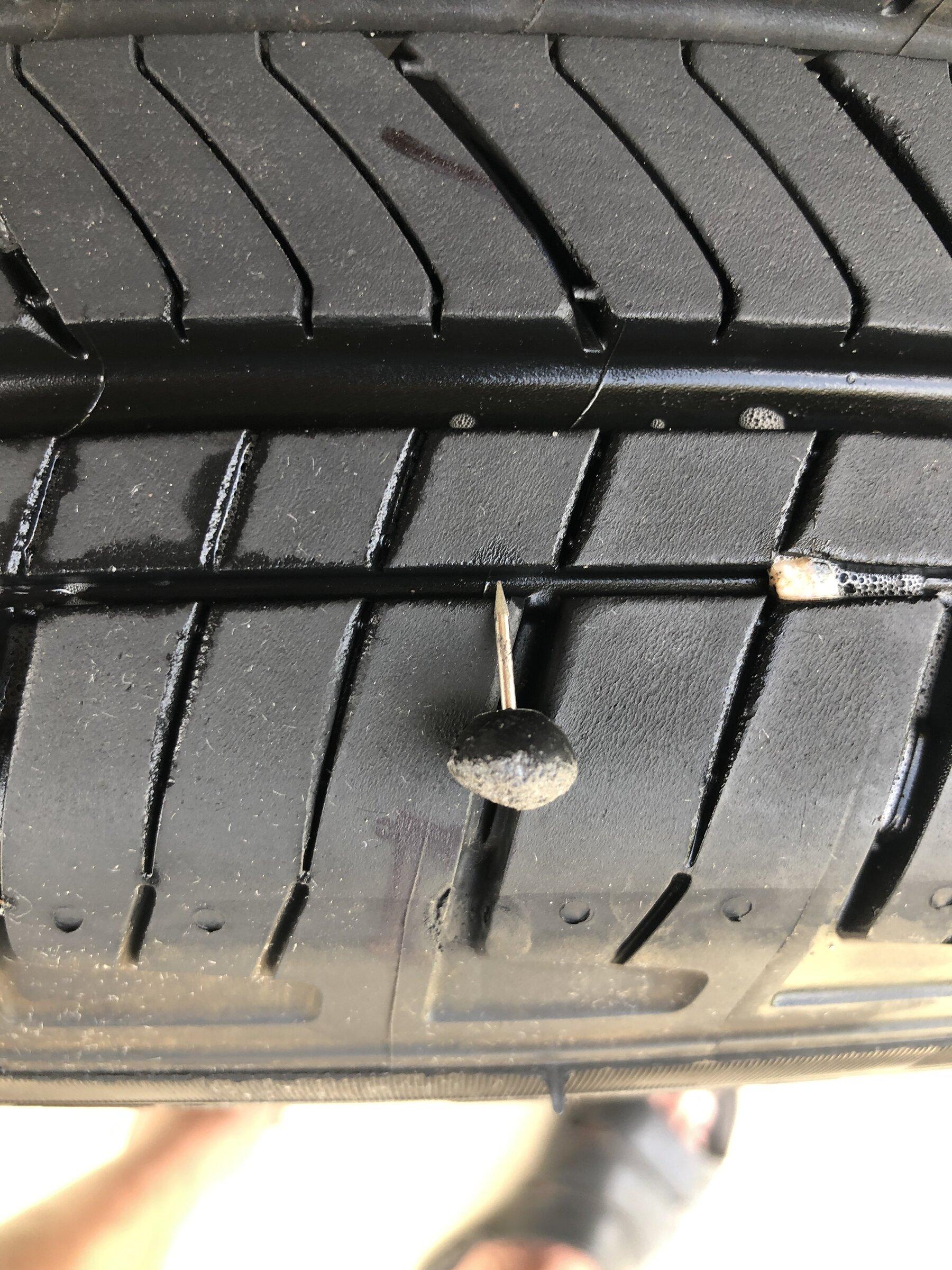

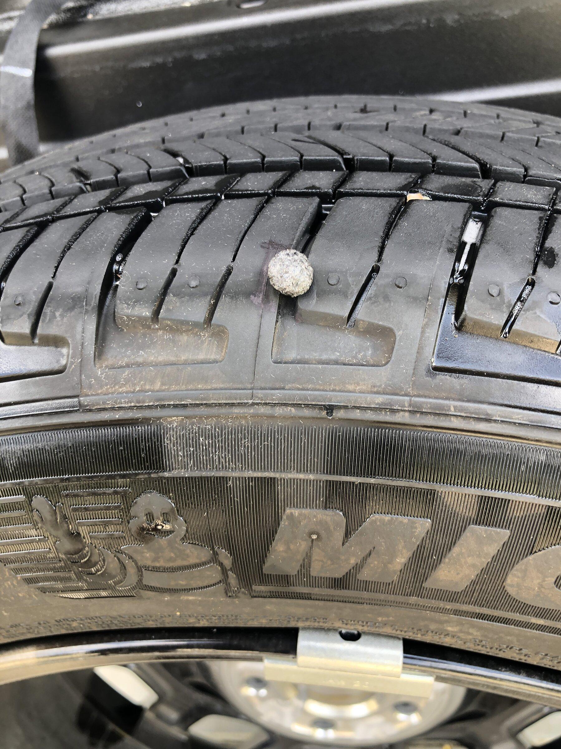

it's not only Discount tire. I have been refused a repair of easily fixable hole NOT in the sidewall because I drove it a few miles from my house with low pressure and they tried to convince me that would breakdown the sidewall "carcass" of the tire and they didn't want any responsibility of a major failure later. This was on a vehicle only a couple months old. Many shops will also refuse to work on any flat that you used one of the emergency canned inflater/sealers on it. I definitely prefer dismounting tire to examine inside and then patch from inside.
I guess there is a certain amount of liability involved. Having a tire on display indicating what they will or will not repair keeps the debates to a minimum.

I'll take an opposing view. While I've successfully repaired many tires in the last 50 years, I'm at a point in my life where the peace of mind far outweighs the small ~$200 cost of a Maverick new tire. If the puncture was through the belt on one of my daily drivers I'd have it dismounted and properly repaired with a patch. Outside the belt as shown, I'd just bite the bullet and replace. I just don't want to potentially think about it for years, or with someone else in the vehicle, or when I'm on a 1000 mile trip, 1am, 12 degrees and snowing. YMMV.....

Yeah. They won't patch it because they don't want to take the liability of it fails and causes an accident. But I would've just patched it myself and just put it on the rear.
That or put it on the spare rim provided it's full size.

I have worked construction for the past 12 years and have 2 flats attributable to job sites. One where I hit something in the road. 2 on the job were fixed with a basic plug kit. The other was fixed at a tire shop with a semi tire plug and a patch on the inside. Ive had 4 sets of in that time. I think road hazard on my truck was about $35 a tire, so roughly $560. I've spent 20 bucks on a pro repair and about 10 for a plug kit. I'd rather just fix it myself and move on than have to argue about getting a tire fixed under warranty.
Remember, warranties are profit centers...otherwise they wouldn't sell them. You are basically betting the price of a tire that you will have one replaced for free. You have to have two tires replaced to come out ahead.

I'll stay out of the sidewall debate, but this is me plugging my wife's car on Sat. It's super easy to do.
How to plug a tire

i agree with the plug crowd . i worked in a gas station in my younger years and repaired alot of tires. Plug that bad boy and run it on the rear
