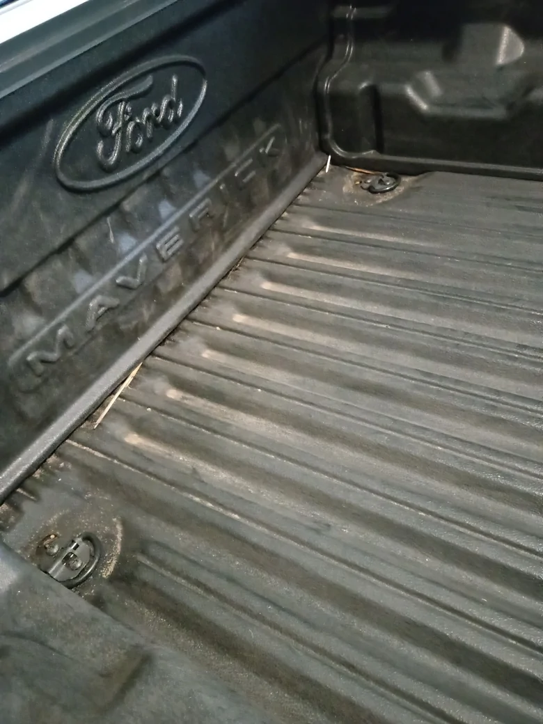

'24 xlt truckbed holds water?
chacoBazzi
Sep 15, 2024
45
zimbabwe
'24 xlt
not a complaint justt an observation: bed's high in the tailend so naturally . . .
is there a secret plug i ain't found to let the water outa the bed?
thanx y'all for the width

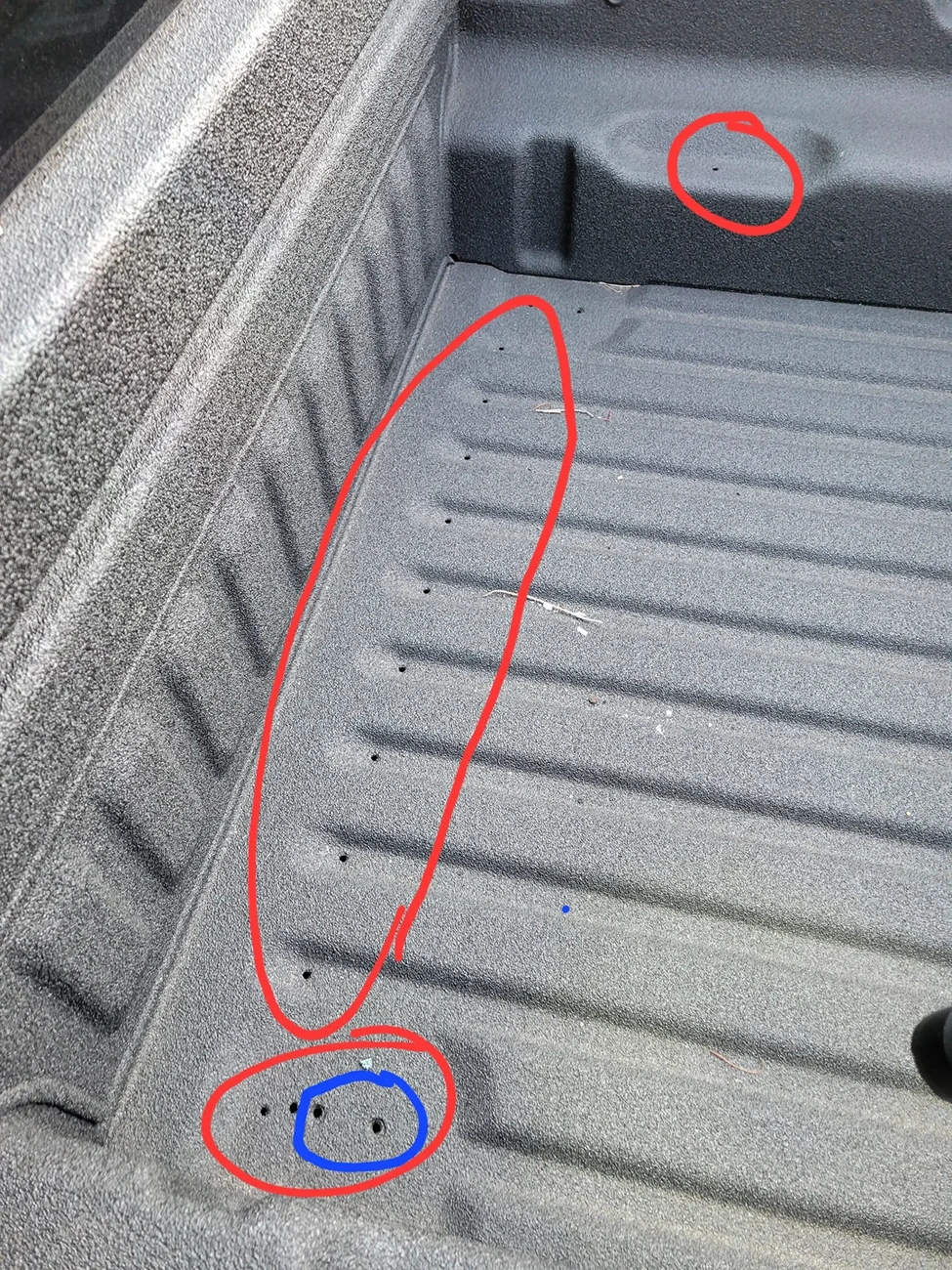

Those holes aren't for straining my martini?

hey HRG: looks like your bed has no liner? or else a liner that looks nothing like mine? maybe my bedliner covers up those drain holes? maybe there is no santa claus?
HRG's picture shows the spray-in bedliner. Your drop-in bedliner is covering the drain holes.

🤷‍♂️ slide it out and drill holes in the areas holding the water or simply just drive up an incline and it should drain out at the tailgate
